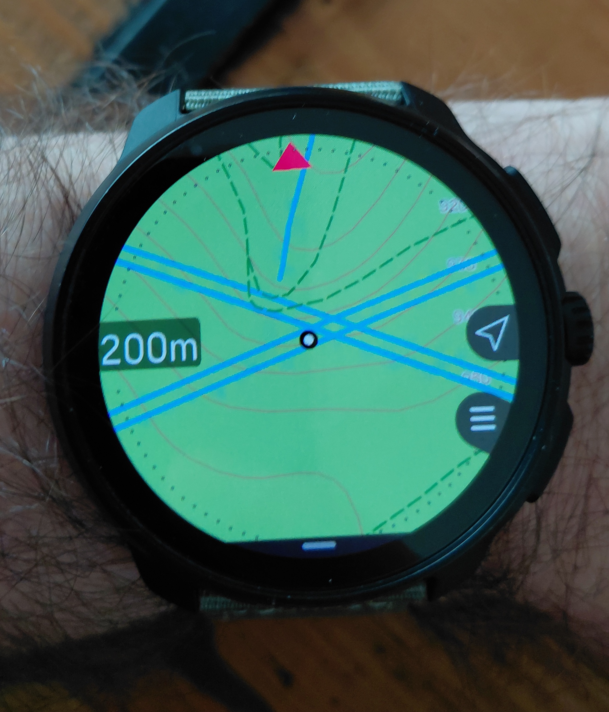

      have anybody experienced strange double blue lines on the map after update?
      I updated the watch and also maps (Czech Republic) today.
      I cannot imagine what they could be. Basically they are two blue parallel straight lines with no start and end. After some time of scrolling I just found that they cross another pair of such lines.
      They are visible up to 500m zoom. If I then further zoom out , they dissappear…

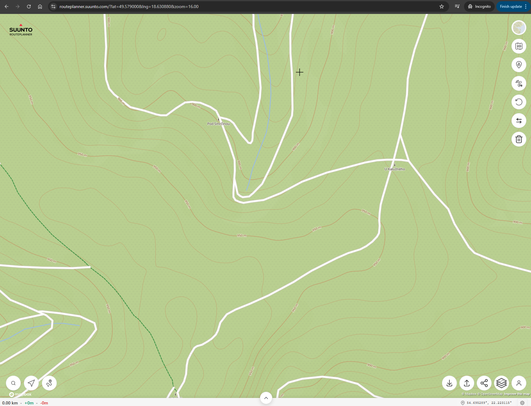

          Here is screenshot from Suunto RoutePlanner for comparison:

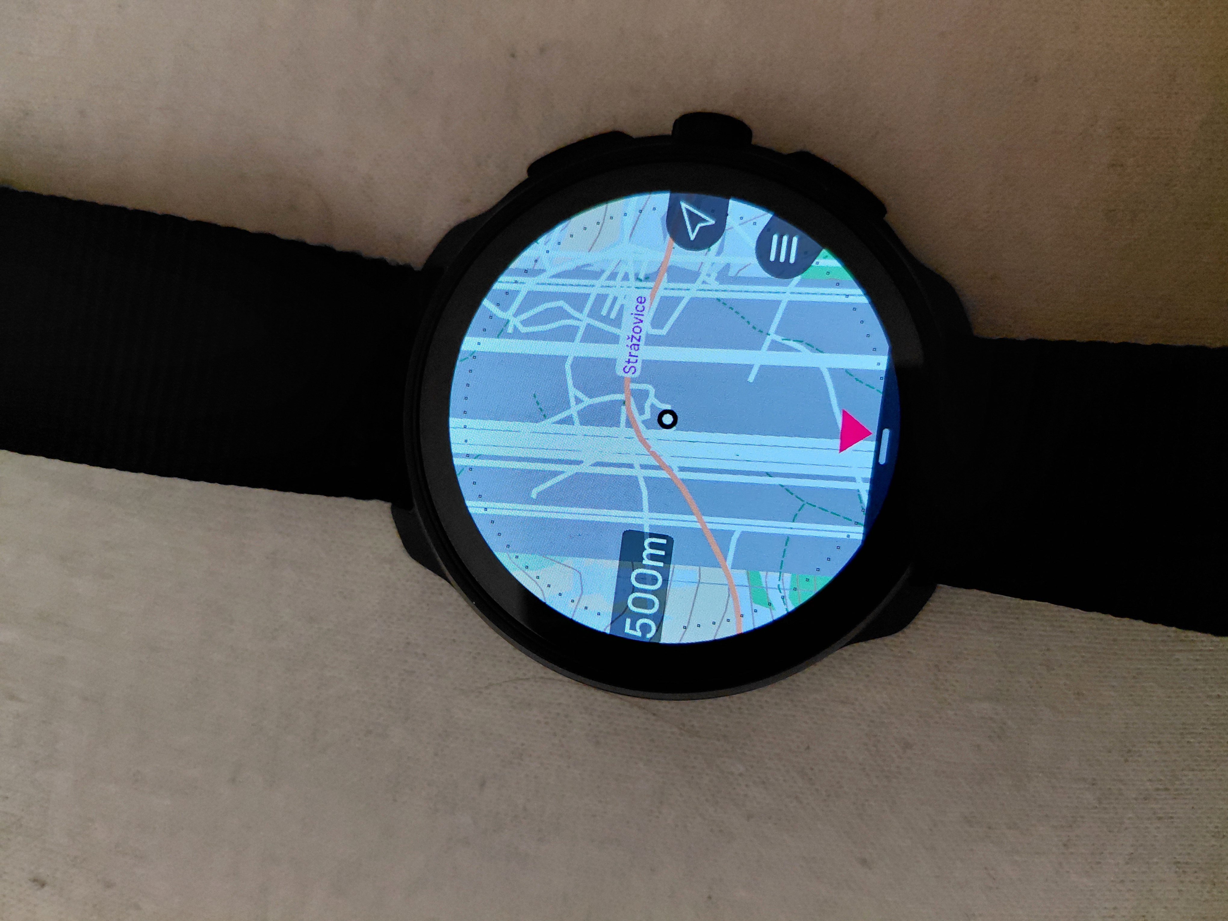

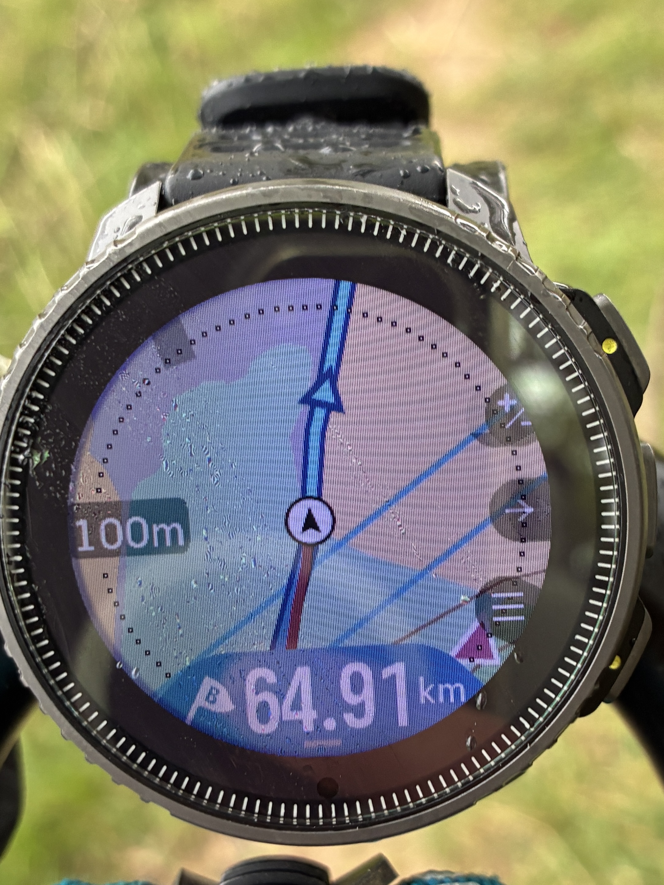

              Today I experienced another strange multiple lines on the track.
              It was here somewhere around here: 49.00919°N 17.04928°E
              And this is how it looks like:

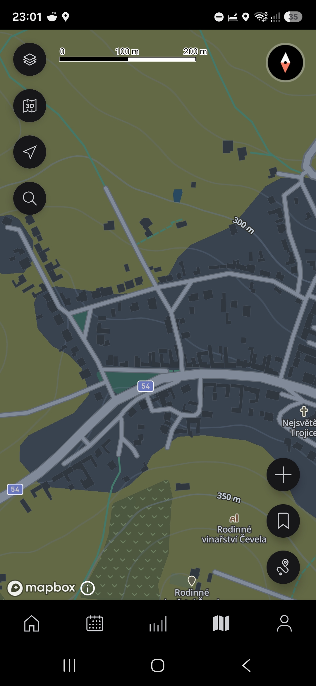

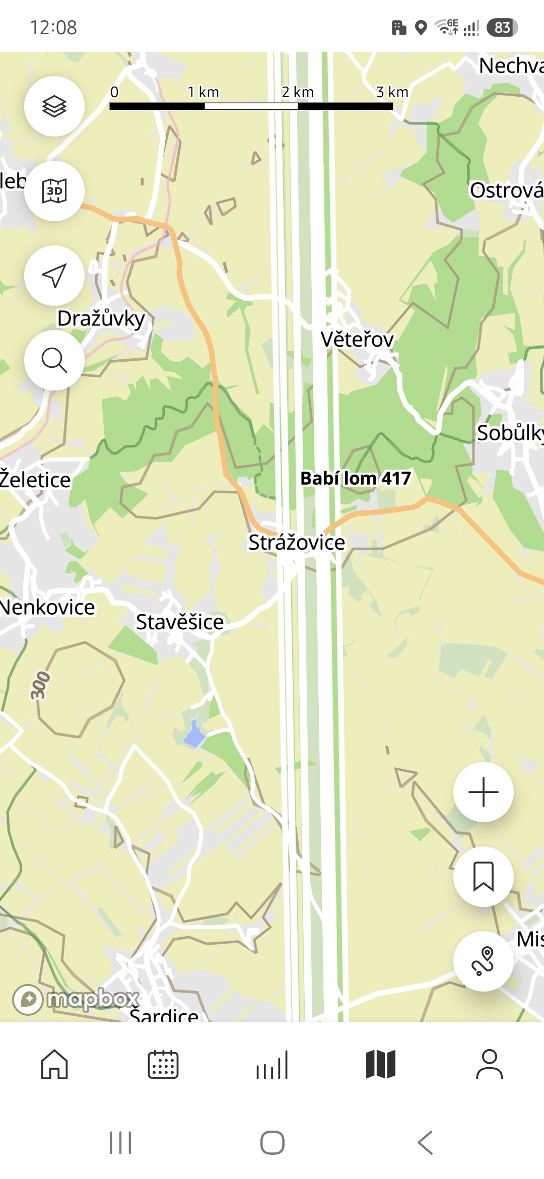

                I can confirm I have the same issue as reporter. Weird lines are in offline maps only:
                And beware, these lines are visible on certain zoom only.

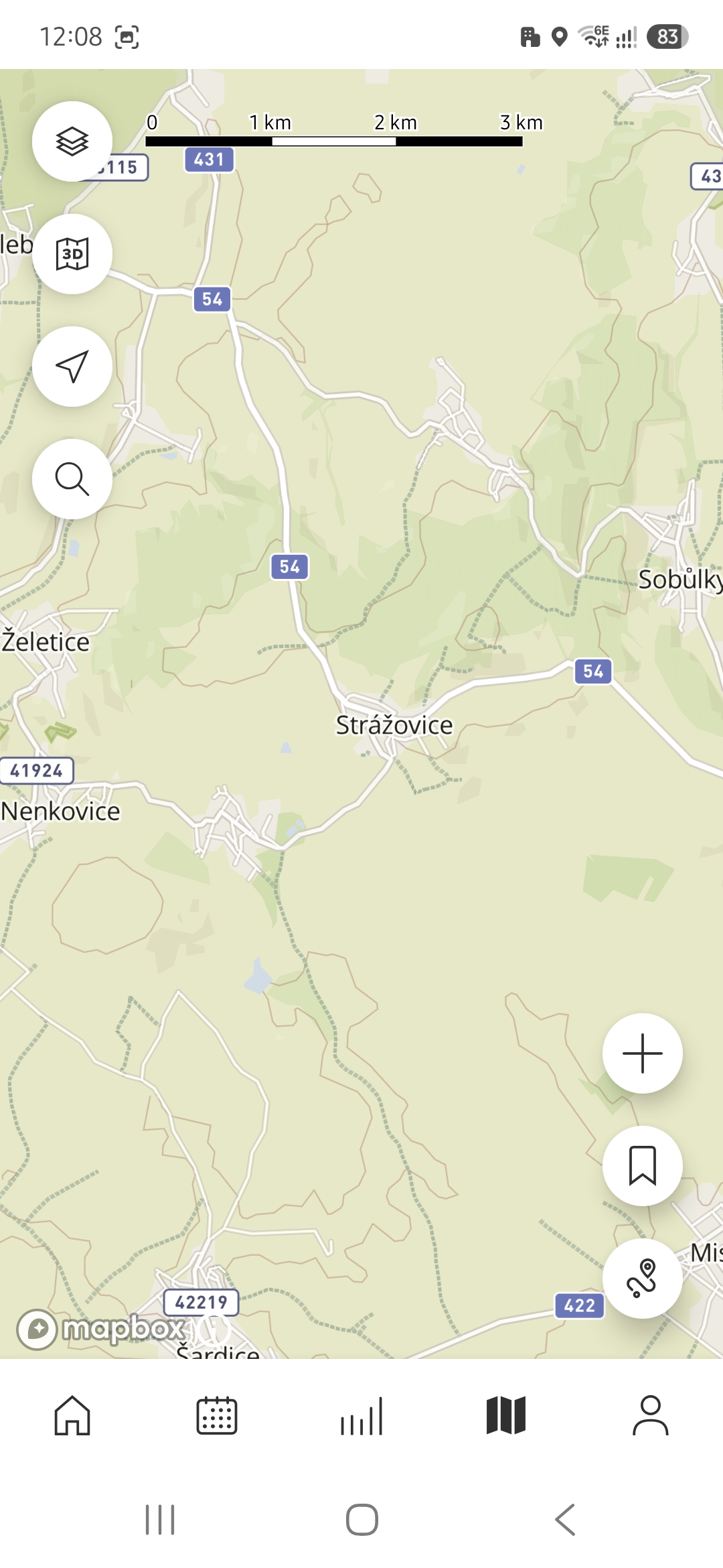

                Online maps looks good (the same location and zoom):

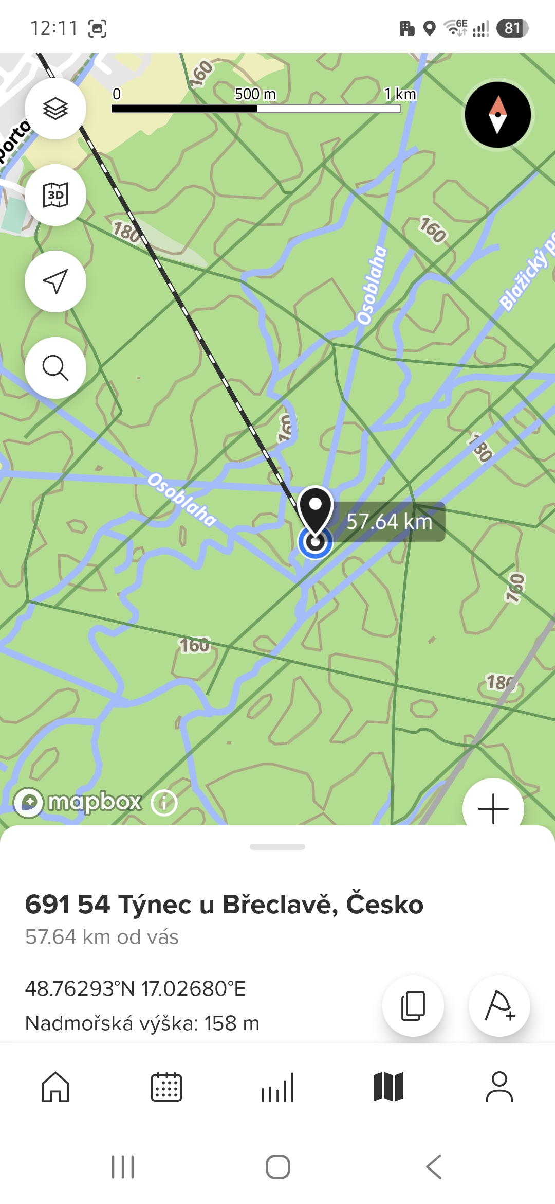

                There are more problematic locations like that:

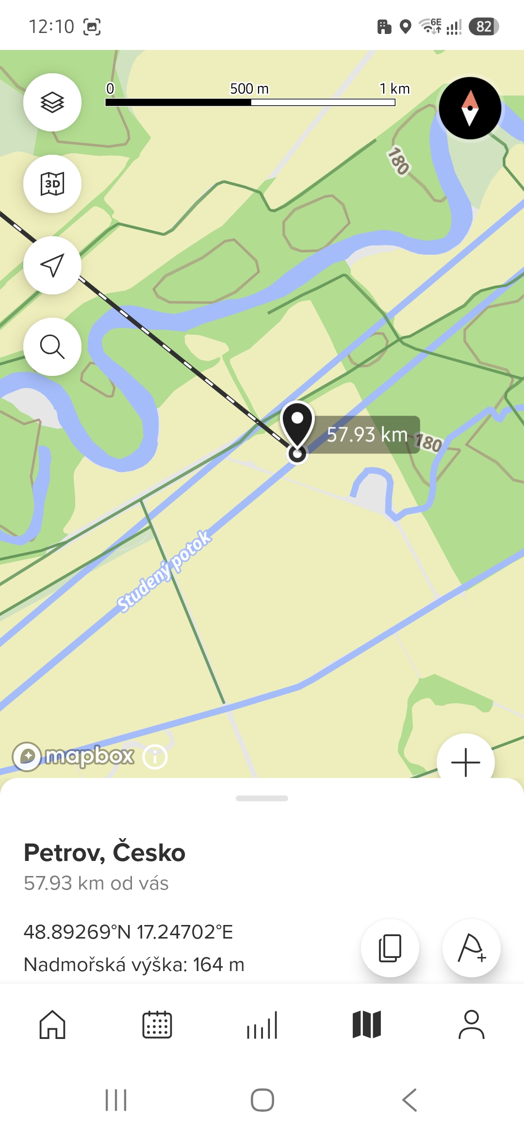

                “Studený potok” does not exist here and is straight line ending at:
                You can see other streams / rivers in the last screenshot as “Osoblaha” and “Blažický”. Problematic “Studený potok” ends up here too, but its name is not visibe in a screenshot given.
                I deleted offline maps from my phone and downloaded again - results are the same.
                I did not check in my watch yet.
                I hope this proves that the problem is not in user’s device but in a map data or rendering. Locations are visible in screenshots. Again, problematic parts are visible in certain zoom only.

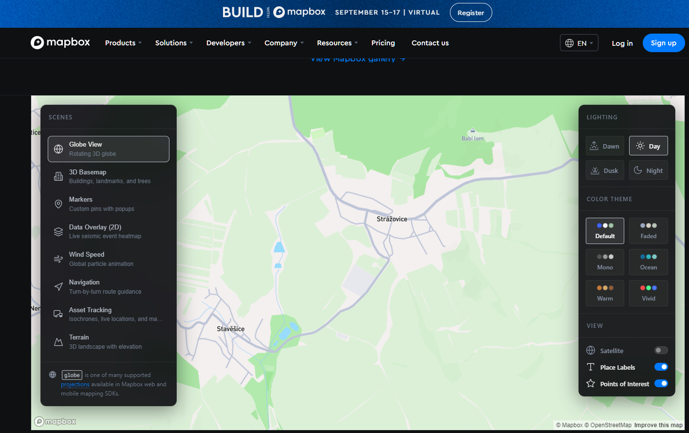

                  One more note. I checked https://www.mapbox.com/ site directly as mapbox seems to be used for offline map sources.There is no glitch on any zoom arround the area reported in the initial post in this thread.
                  So the problem is not in original map data.

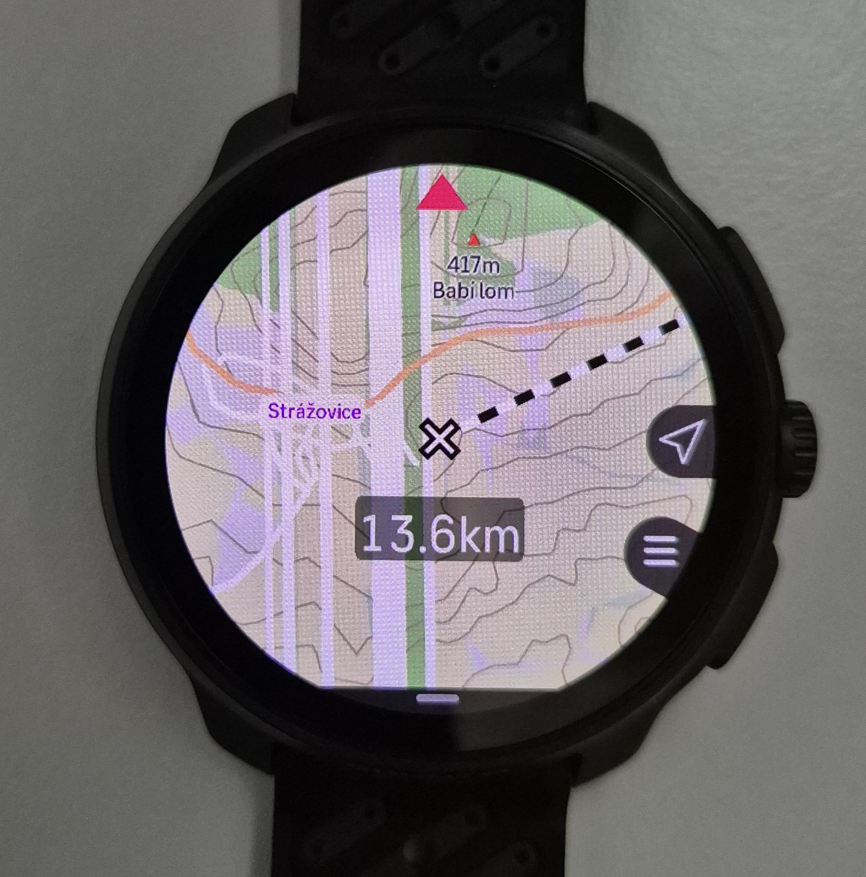

                      So I checked directly in my watch Race 2 Titanium black and I see the same map corruption as reported above:
                      Again, this suggests that the problem is not isolated to a single device.

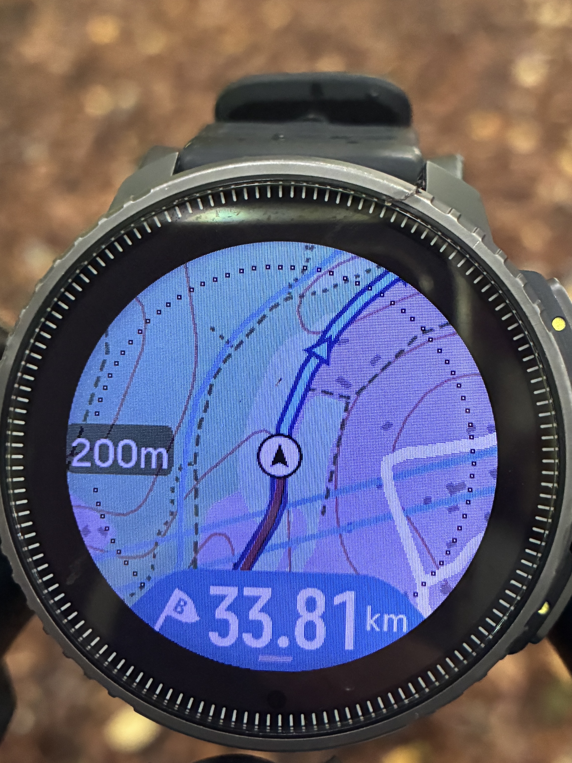

                                Looks like Czechia has more water canals than Netherlands 😂 IMG_0609.jpeg IMG_0582.jpeg
