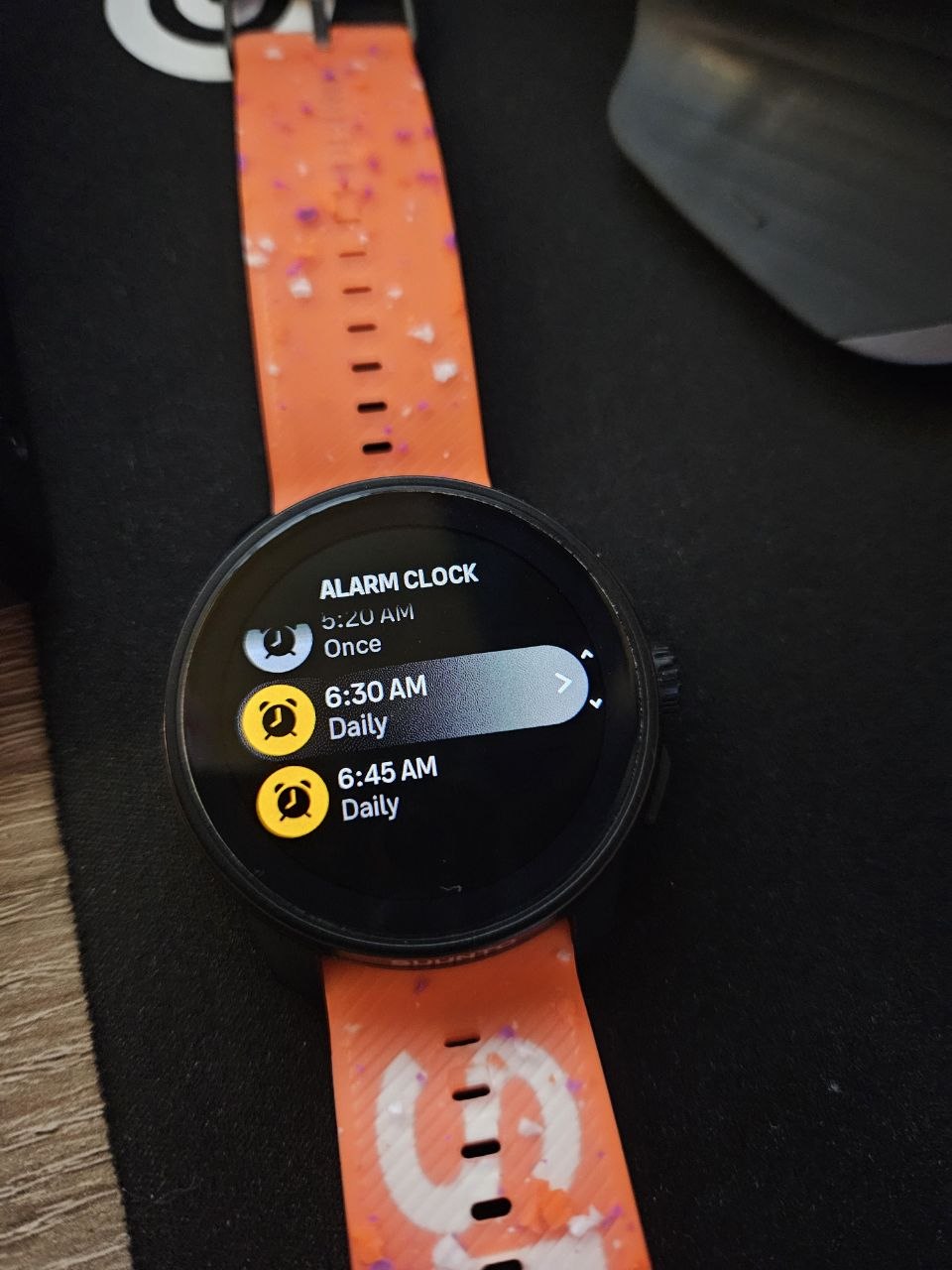

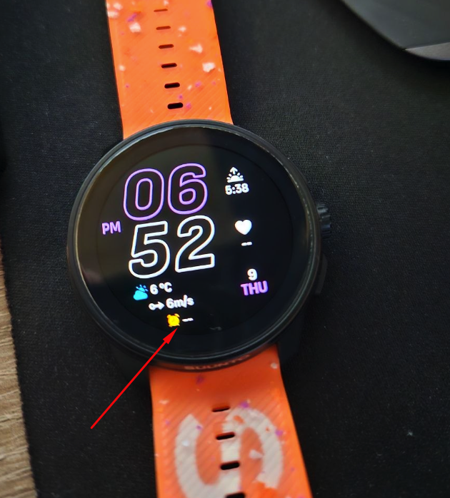

      After the latest update on my Suunto Race S, the information about active alarms has disappeared from the watch faces.
      I’ve tried switching between different watch faces, but the issue persists.
      Has anyone else experienced this, or is there a way to fix it?

        @Mikhail-D. I have this issue, alarm time not showing if the alarm is the next day. It shows if the alarm is on the same day.
        Like in your example it wouldn’t show but if the alarm was set for say 22:30 it would.

              @Mikhail-D. Alarm only shows for the current day.
              Vector/T6c/Vertical 2 Ti
                duffman19 @Brad_Olwin
                @Brad_Olwin No, that is not the normal behavior or how it was pre-update (says the guy with the SV1 and 9PP). It should show the next alarm regardless of whether it will occur on the following day.
                This happened once before after an update (2.35.34 Q2). The issue at the time had to do with repeating alarms only. If I recall, it was quickly fixed with either a hotfix or the next update.
