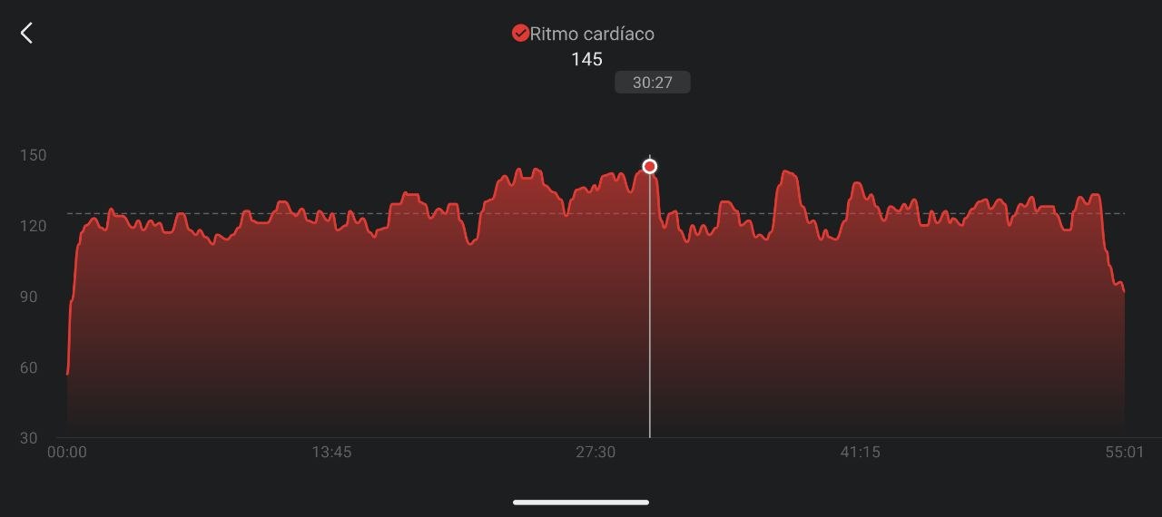

            Today I did a run with a biceps band and the Vertical 2 titanium.
            Biceps, accurate readings. Maximum of 145bpm:

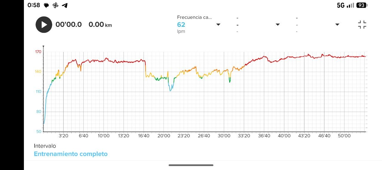

            Wrist sensor (Suunto Vertical 2). Today I used a nylon strap to ensure a better fit:
            As you can see, the readings are completely wrong and stuck.
            The thing is I had this issue in the past with the Race 1. I’m a person with a trained heart and low bpm while resting. I have been using Garmin watches in many years and I don’t have this issue in Garmin. Coros is also working for me (but Amazfit not).
            Needless to say I know how to wear the watch. In my opinion, there’s something related to software since it’s very clear the watch is stuck from the very beginning. Considering the new sensor and the same issue I had in the past, I think algorythms are not clever enough when there’s noise because factors like sweat or the arm movement itself.
            I know the new sensor is working for many but I’m not the only one with exactly this issue, and in others everything just works (and as I posted before).
