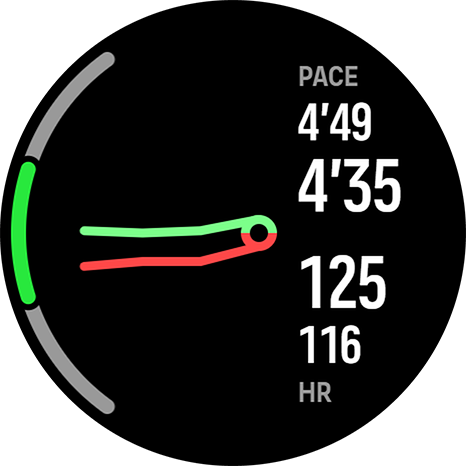

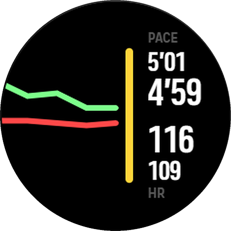

      Drift View
      The drift screen shows both metrics side by side on a single combined chart.
      The left panel plots two series:
      • pace deviation from your session average (top)
      • heart rate deviation from your session average (bottom)
      Each series stays centred on its own baseline. Moving above the baseline means ahead of average for pace, or above average for heart rate.
      The right panel shows a status word and the current delta value for each metric. Pace shows AHEAD (faster), STABLE, or FADE (slower). Heart rate shows HIGH, STABLE, or LOW. Values are coloured green or red when outside the stable range, and white when stable.

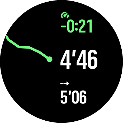

      Pace View
      The pace screen shows:
      • current pace (mid)
      • average pace (bottom)
      • the difference between current and average pace (top)
      A green difference means you are faster than your average pace.
      A red difference means you are slower.
      Small differences within 10 seconds per kilometre stay white.
      The graph shows the recent trend of your pace difference over roughly the last 60 seconds. It is designed to show whether you are moving closer to or further away from your workout average, without overreacting to brief stops or missing pace samples.

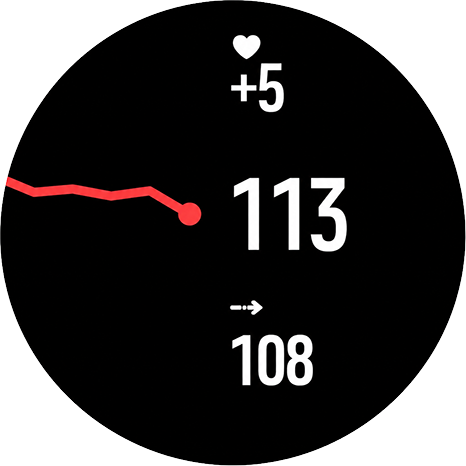

      Heart Rate View
      This view shows:
      • current heart rate (mid)
      • average heart rate (bottom)
      • the difference between current and average heart rate (top)
      Heart rate values are shown in beats per minute.
      A green difference means your current heart rate is below your average.
      A red difference means it is above average.
      Small differences within 5 bpm stay white.
      The graph shows the recent trend of your heart-rate difference over roughly the last 60 seconds, so you can see whether your effort is drifting above or below your workout average.
