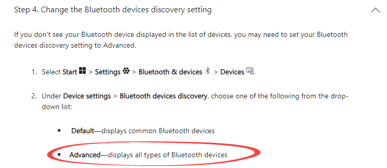

                As it might help someone else that stumbles on the same problem… At least for me it was this Win11 setting that changed things for the better:
                Seems stupid in hindsight, but I was not aware that Default only identifies low-power connectivity Bluetooth devices.
                Happy days! no I will be able to test my apps!
