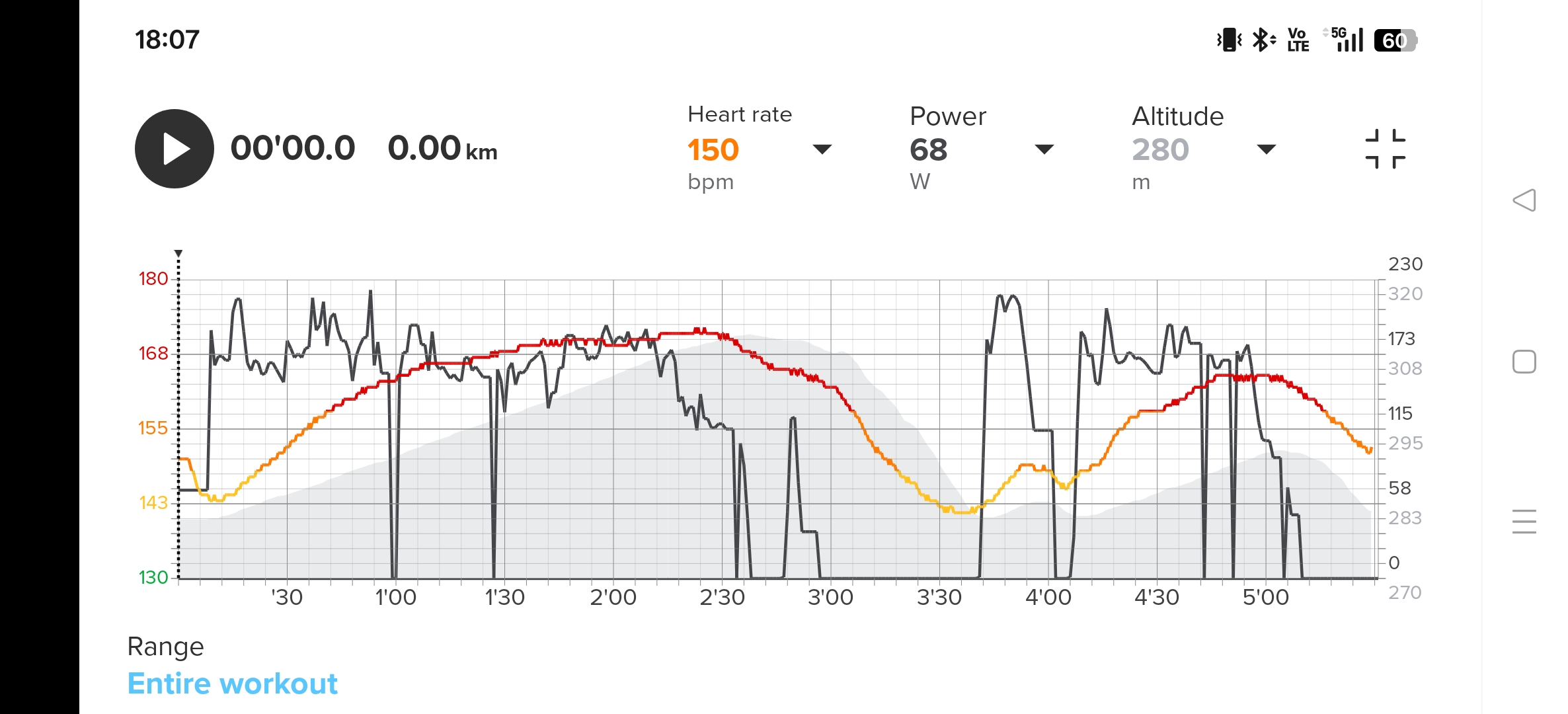

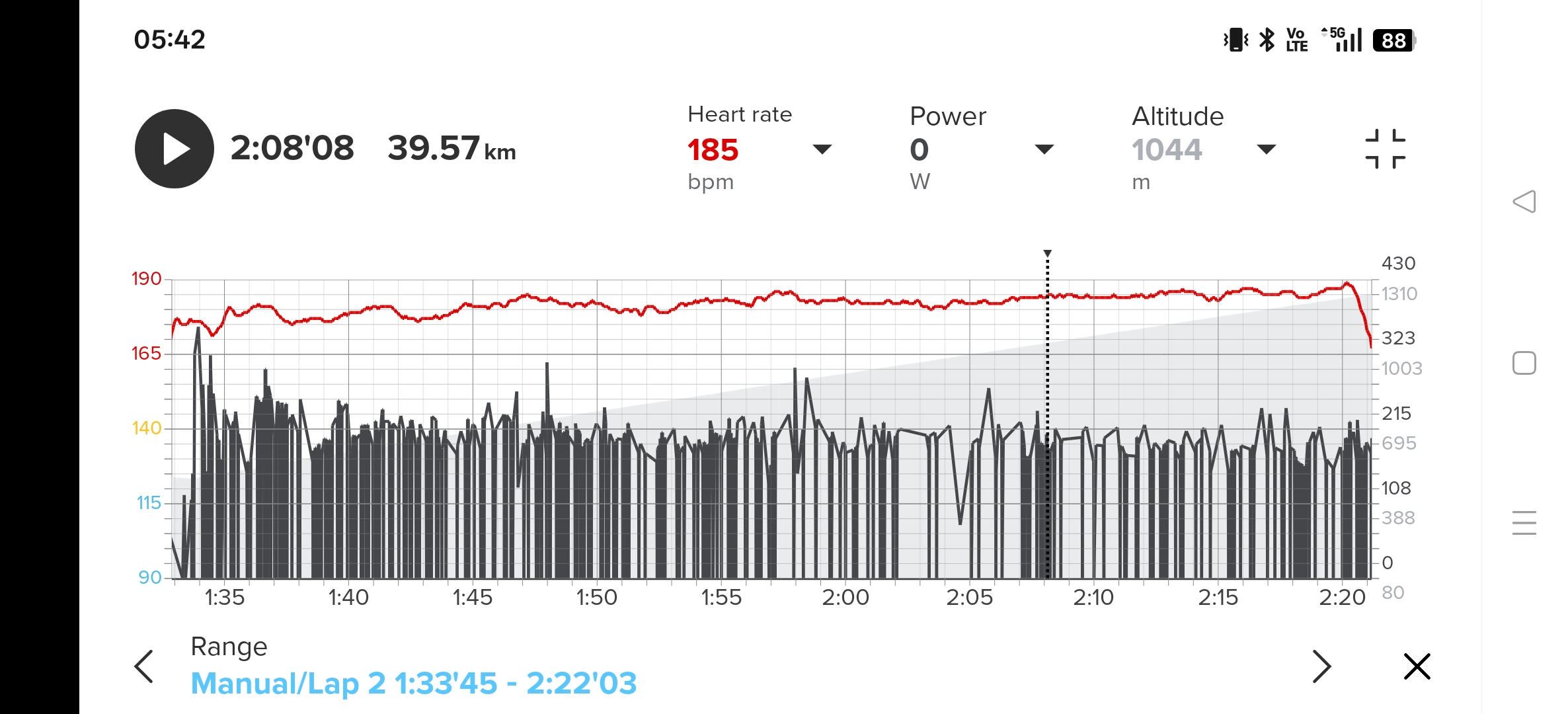

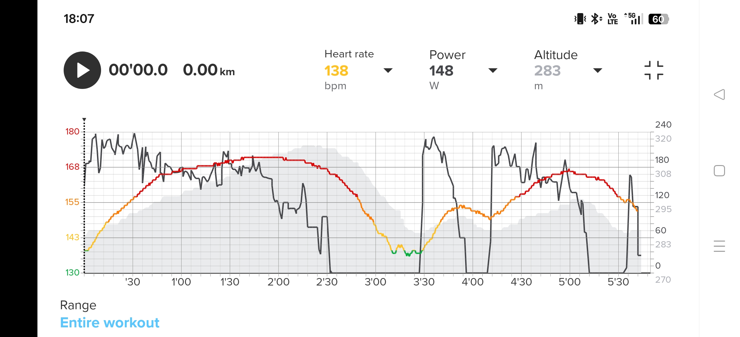

      I am experiencing a poor data record on my SUUNTO 9 BARO CHARCOAL BLACK TITANIUM.
      To be specific the watch is recording frequent zeroes from a SRAM Red power meter even if I pedal uphill constantly.
      Here above are linked the data recorded on the same road two times with my SUUNTO 9 (before and after replacing the battery of the power meter) and one time with my AMBIT 3. The old watch recorded zeros only when I turned back so the PM itself should not be an issue.
      Two weeks ago, on a longer climb, the zeros were disturbing much more the record with a 20% error on the average for a 50 minutes ascend (compared to same ascent last year with similar ascent time)
      Do you have any idea how to solve this problem?
