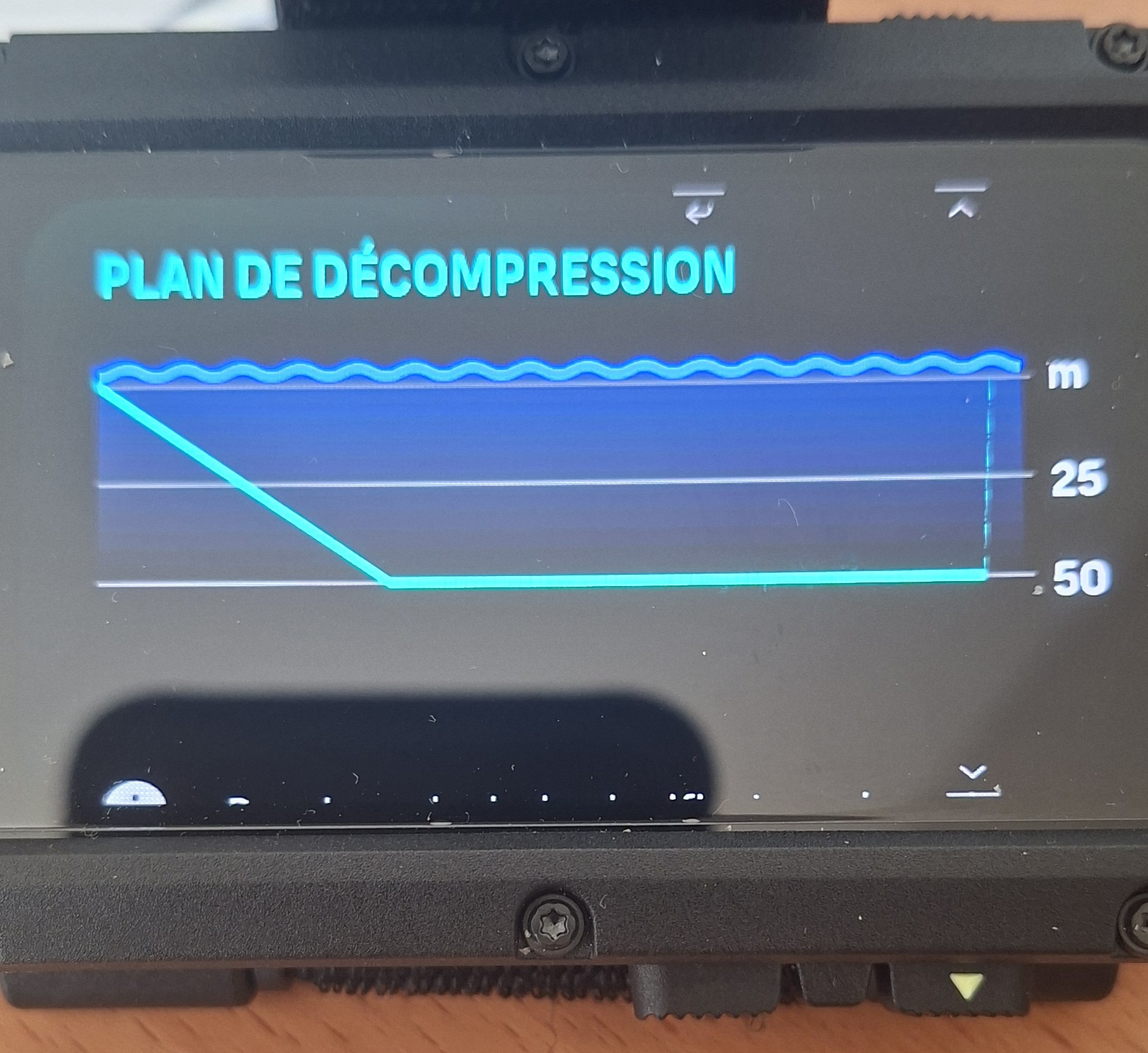

      Hello,
      Strange behavior of the dive planner.
      In some cases you can end up with a dive with only 2 steps (descent and bottom time), no out profil, just a straight vertical line from bottom to surface.
      To reproduce issue:
      Plan a first dive:
      GF: 40/85
      Gas: AIR
      Surface interval 48:00
      Dept: 50
      Bottom time: 10
      Computation seems correct.
      Get back using back button.
      Select same depth (5)
      Stay more than 10s on the selected depth, NDL an TTS get reset to 0
      Select Bottom time (10)
      The computed dive plan has only 2 steps…
      Is it a bug or am I missing something
      Cheers

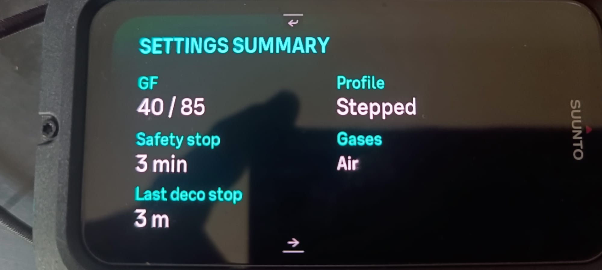

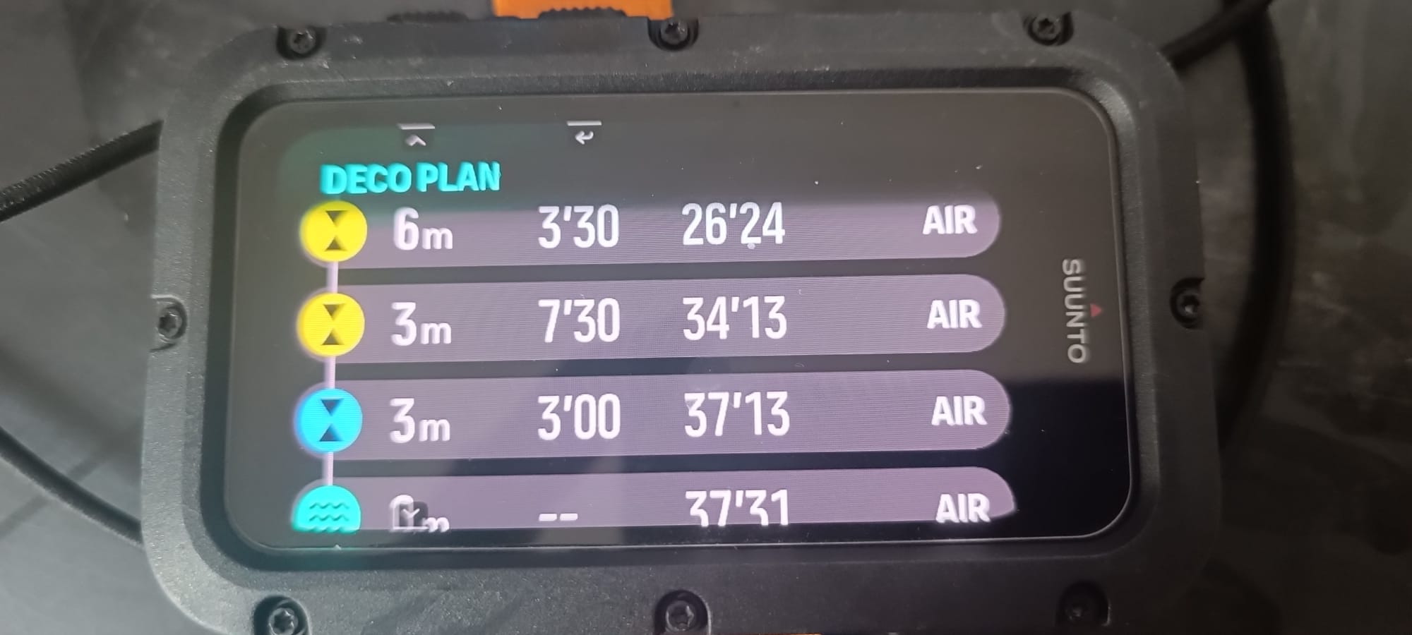

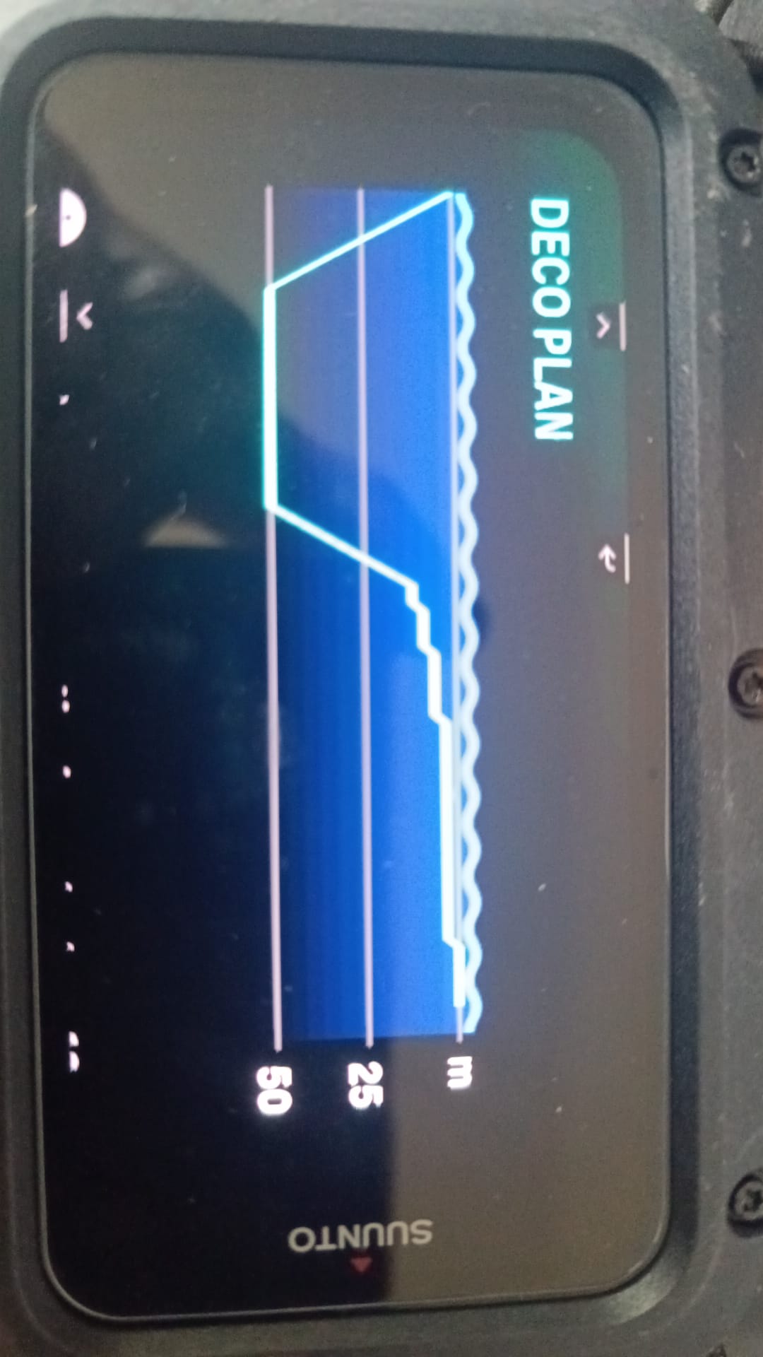

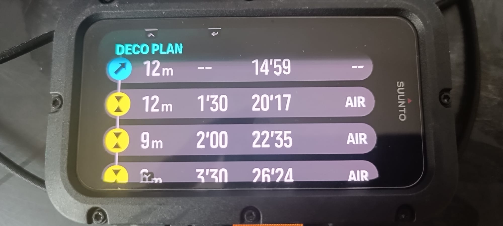

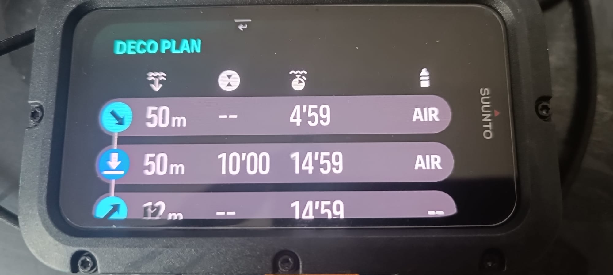

          WhatsApp Image 2026-06-16 at 11.41.48 (1).jpeg WhatsApp Image 2026-06-16 at 11.41.48 (2).jpeg WhatsApp Image 2026-06-16 at 11.41.48 (3).jpeg WhatsApp Image 2026-06-16 at 11.41.48.jpeg WhatsApp Image 2026-06-16 at 11.46.50.jpeg
          Same parameters, NDL and TTS effectively turn to 0 but not the same result than you…
          Etrange !

                Ldive @soryp
                @soryp I confirm I did it twice following your instructions… That’s why it is so strange !
