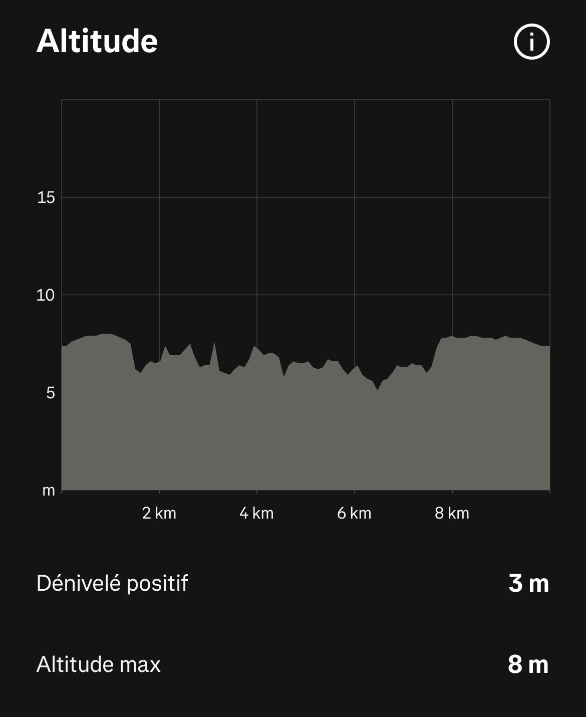

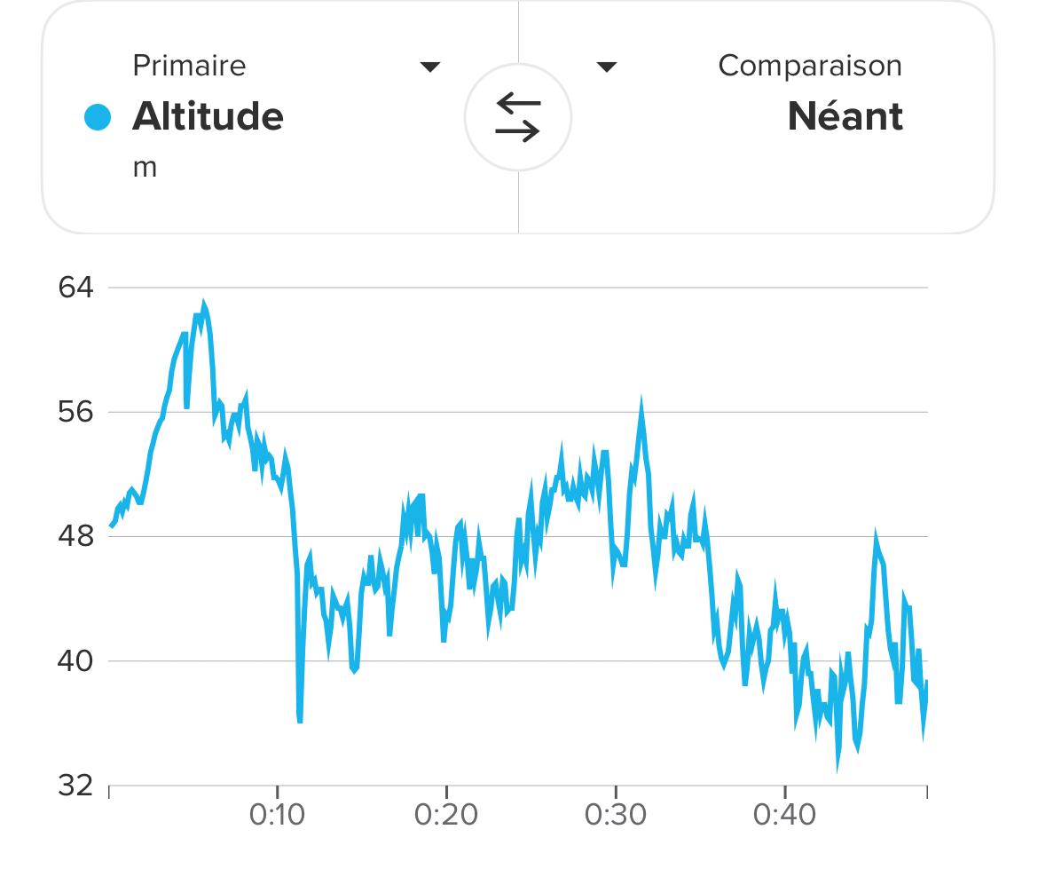

      In one of my lastest runs, which was completed on a race at sea-level, with the first 500 meters and the last 2.5K on a road next to the sea, My R2’s (barometer) recorded a total ascent of 179 meters and a total descent of 174 meters by the end of the race, with a highest point of 63 meters and a lowest point of 34 meters. However, when I compare this with the data on Strava, the elevation ranges only from 5 meters to 8 meters, which makes total sense, again considering I was running at sea leavel.
      Another thing that makes me question the accuracy of the data is that the start and finish were at exactly the same location. In other words, the first 500 meters of the race were exactly the same as the last 500 meters. Yet, when I look at the elevation profile in the Suunto app, it shows that I ran the first 500 meters on a slope rising from 48 meters to 63 meters. But on that very same section of the course—this time during the last 500 meters before the finish—the elevation profile rises from 35 meters to 38 meters, with a peak at 48 meters.
      Suunto graph:

      Strava graph (leveraging GPS instead of barometer):

        @Danny-Labrana usually the barometric measurement is a lot more precise than a digital elevation model.
        Your data looks noisy, which hints to either a lot of wir or a dirty sensor.
        But anyway, the altitude change in this example is quite small. For these small deltas, I personally would not care at all and call it all flat 🤗

              @Egika For me that lives in flatlands by the sea - that looks like a significant difference 🙂 What looks a bit strange that it started at 50m, while looks like that actual altitude is sea-level, shouldn’t that be fixed with FusedAlti during the activity?

                Maybe quite small, but the race start was located 20 meters away from the shore. Would the race have started at the top of some cliff in France or the UK next to the Channel, I would have understood 🤣

                  I usually always check if the altitude shown by the watch is correct, if not it can be set manually or auto adjusted. Apart of that, the data look very scattered, I agree with Egika about strong wind or dirty sensor. Did you get the same behavior also other times? in this case the pressure sensor could be defective.
