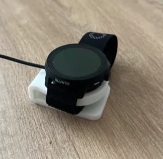

            • thinking about some 3D printed holder, high enough for strap to hang untight, something like on the picture but adapted
            @thanasis could you share a photo of you solution please?

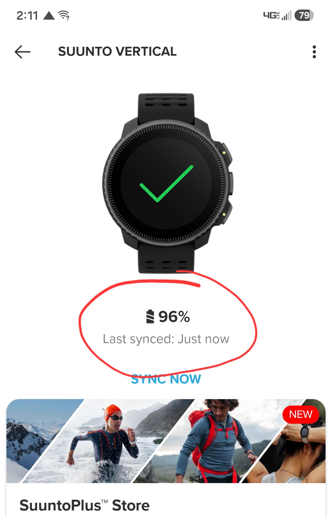

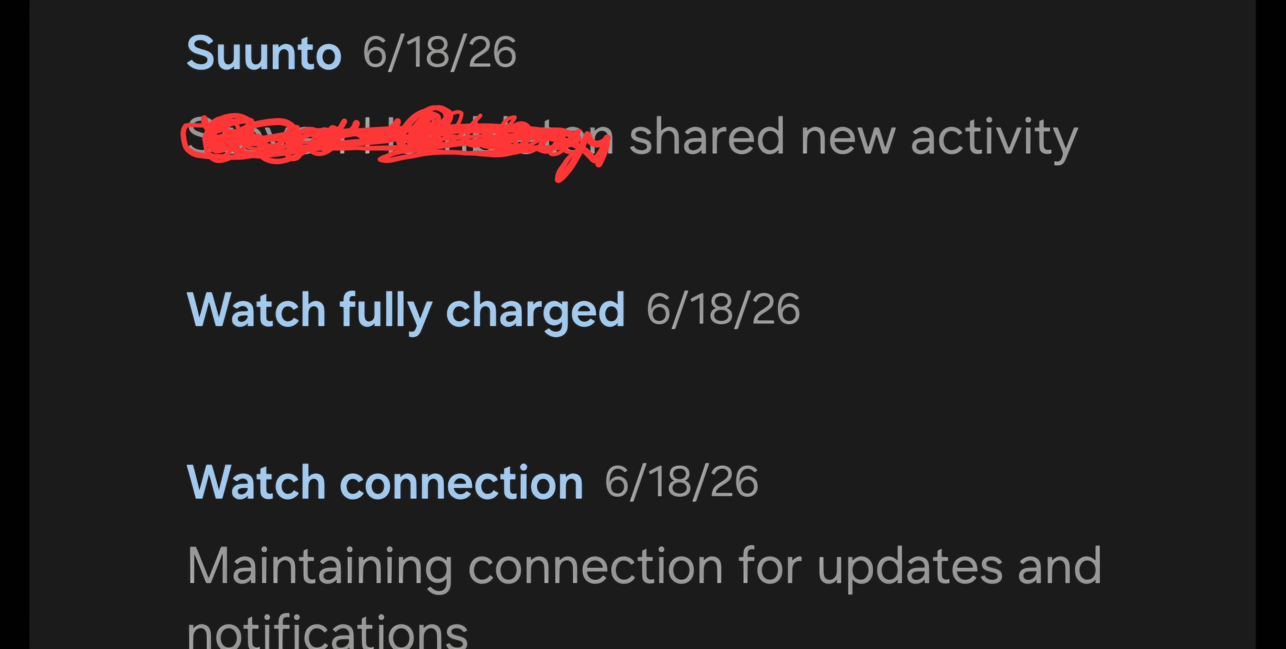

              Assuming that your watch is currently paired with the app, if you’re worried that it may not be charging, you can always click the watch icon on the app to see what percentage it’s at, even when on the charger.
              Bonus (at least for Android users), you get a notification when the watch reaches 100% charge! So you don’t even have to come and check on it.

                          @thailon I made one for my race. Haven’t tried it, but could fit for Vertical as well: https://www.thingiverse.com/thing:7108194
