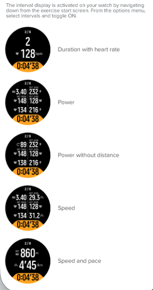

      Currently I let the planned workouts download onto my watch and let the program run while out on my run. I have looked at the stock Intervals screen/card/app that is available and added it to my run sport profile. At first I thought that that screen would automatically appear/start during intervals. That is not the case. It has to be started and set up in the options menu before the start of the run and turned on when I want to start intervals. (at least this is how I understand it and have seen it on my watch). Ideally I would not have to hit a start button and I could let the TP session run as it normally does, but that seems to not be the case.

              @2b2bff it is what I meant. I get that as well. Some of my issue with it is that when you are doing intervals it is really hard to see your heart rate on this screen. (I know I know it’s a first world problem). I should have attached a photo of what I have been using and it is great, but you have to set it up for each workout and hit start when you want them to begin. If you do not do this they do not work and they also are not changed or programed by the incoming workout so if I am doing pyramid intervals, I cannot use them. I was hoping that there was a way to make TP or other imported workouts use one of these screens instead of the one that you use.

                @Stavrogin you can use Suunto app to customize the data you’d like to see during the structured workout, just disable the auto lap so the manual laps can from the structured workout can be used.
                TP workouts do not show the step you’re on, on the contrary, it’s the workout was created using Suunto app you’d see that, steps like 1/5 etc, other third party platform that does display step counter is intervals ICU.

                    Adding to my previous post, after disabling the auto lap, you can setup your own screens to see avg numbers for whatever metric you want and it’ll be for that step of the workout. But definitely you cannot see what step you’re on with TP workouts, until TP implements above idea.
