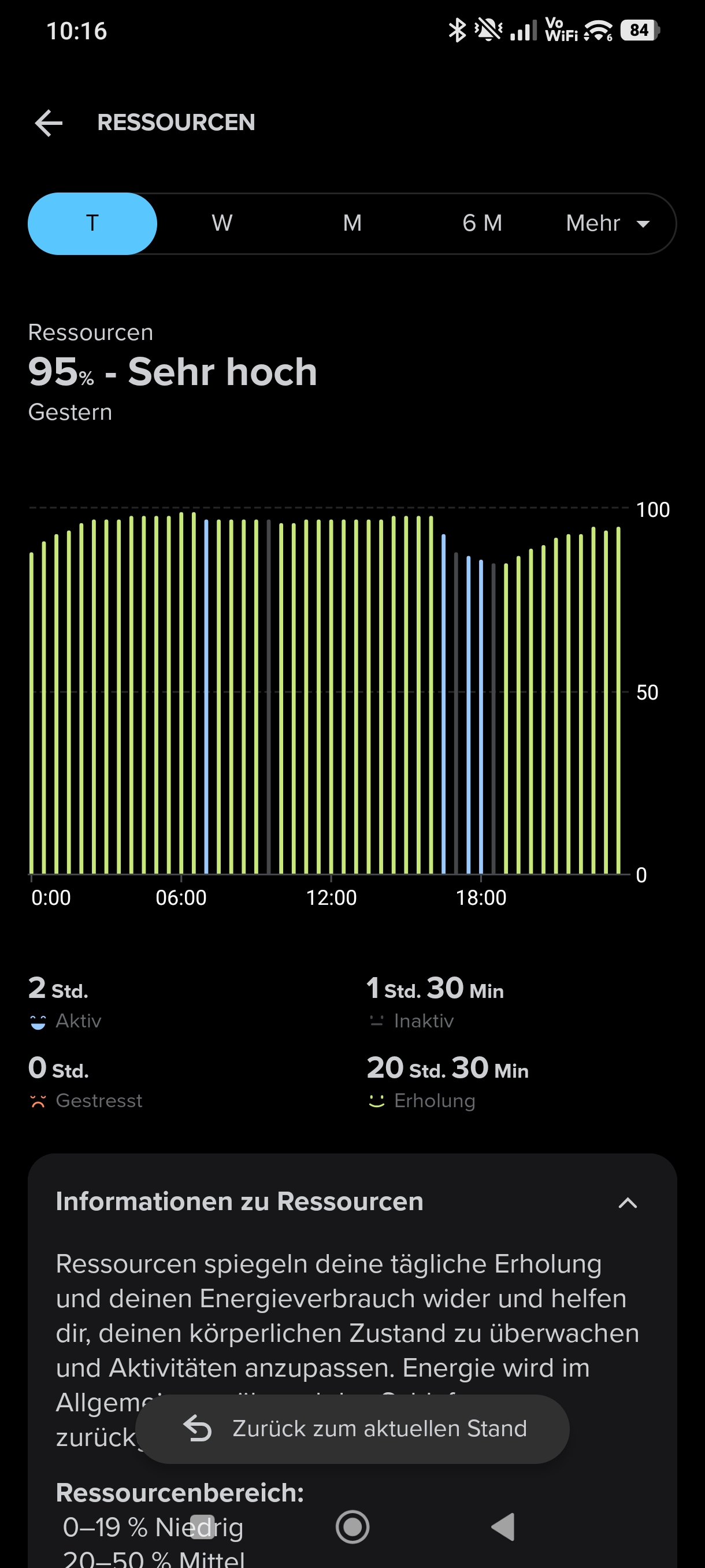

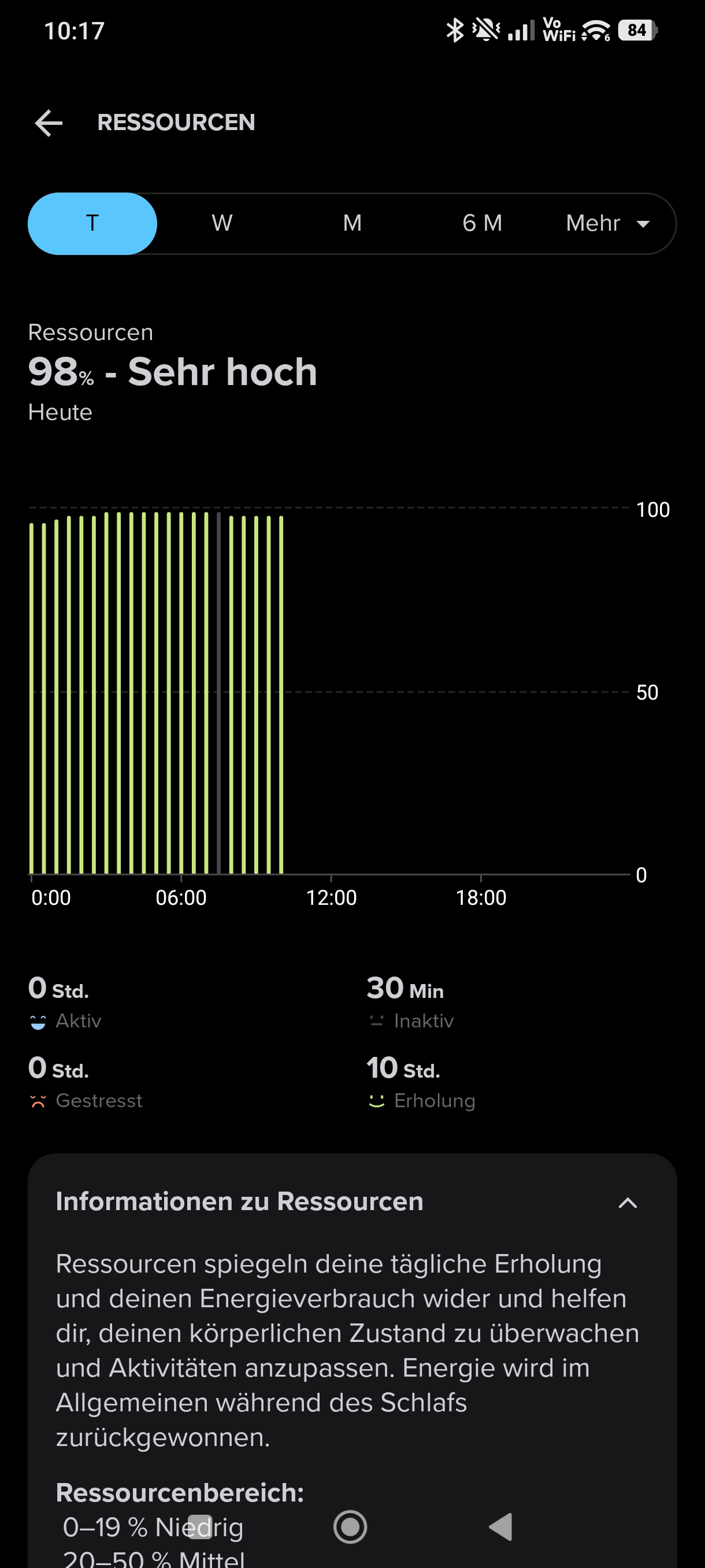

                      Hi everyone,
                      I’m noticing that the Resource tracking on my Race 2 seems completely off and overly optimistic.
                      Yesterday: I did a heavy 36-round HIIT circuit session. Despite the high physiological load, the app recorded 0 hours of stress and 20.5 hours of recovery. The resources dropped only slightly to around 75–80% during the workout and shot right back up to nearly 90% shortly after while sitting on the couch.
                      Today: I woke up to 98% (Very High) resources with 10 hours of recovery and 0 hours of stress logged so far today.
                      It feels like the HRV stress thresholds are set way too high/insensitive, treating almost the entire day as “Recovery” and ignoring EPOC/post-workout physical stress altogether. As a result, the widget is essentially stuck between 90–99% every day, making it unusable for actual recovery and training load management.
                      Is anyone else experiencing this “Stuck on High” resource behavior, or is a fix planned for the upcoming firmware update?Screenshot_2026-09-10-10-16-37-306_com.stt.android.suunto.jpg Screenshot_2026-09-10-10-17-48-080_com.stt.android.suunto.jpg

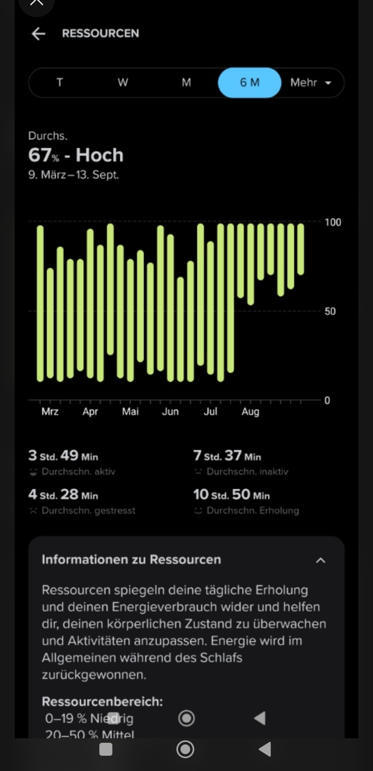

                      Update with graphical proof:
                      Here is my 6-month resource history chart, which clearly shows when the issue started:
                      March – July (Suunto Race S): Realistic and dynamic resource fluctuations. After hard workouts, resources dropped properly (sometimes below 20%) and recovered naturally.
                      August – Present (Suunto Race 2): Exclusively after switching to the Race 2 in August, the algorithm got stuck at the top. Resources barely ever drop below 60–70%, no matter how hard the training was.
                      This clearly confirms it’s not a user-specific HRV baseline anomaly, but a model-specific algorithm regression/bug introduced on the Race 2.Screenshot_2026-09-10-10-56-06-459_com.google.android.googlequicksearchbox-edit.jpg

                        Thaler Martin @_Luki
                        @_Luki danke das ergebniss ist eindeutig…schade das das mit der neueren uhr so schlecht geworden ist…hoffe auf Verbesserungen so hat das widget null Zweck…
                        _ 1 Reply Last reply Reply Quote 1
                        • _ Offline
                          _Luki @Thaler Martin
                          @Thaler-Martin absolut. Nervt mich auch. Eine momentan nutzlose Funktion und wie man an meinem Beispiel sieht hat das schon mit dem Uhrenwechsel zu tun. Schade das von Suunto keine Reaktion kommt. Auch mit der manchmal fehlerhaften HF Messung
