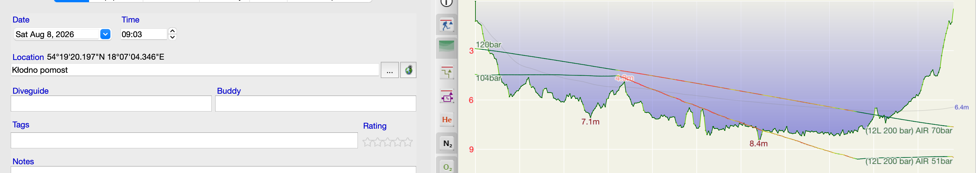

        @BlackRabbit I do export from sunto app and import to Subsurface. Just use JSON file export. (still waiting for second POD to arrive from distributor but the one I have is there)
