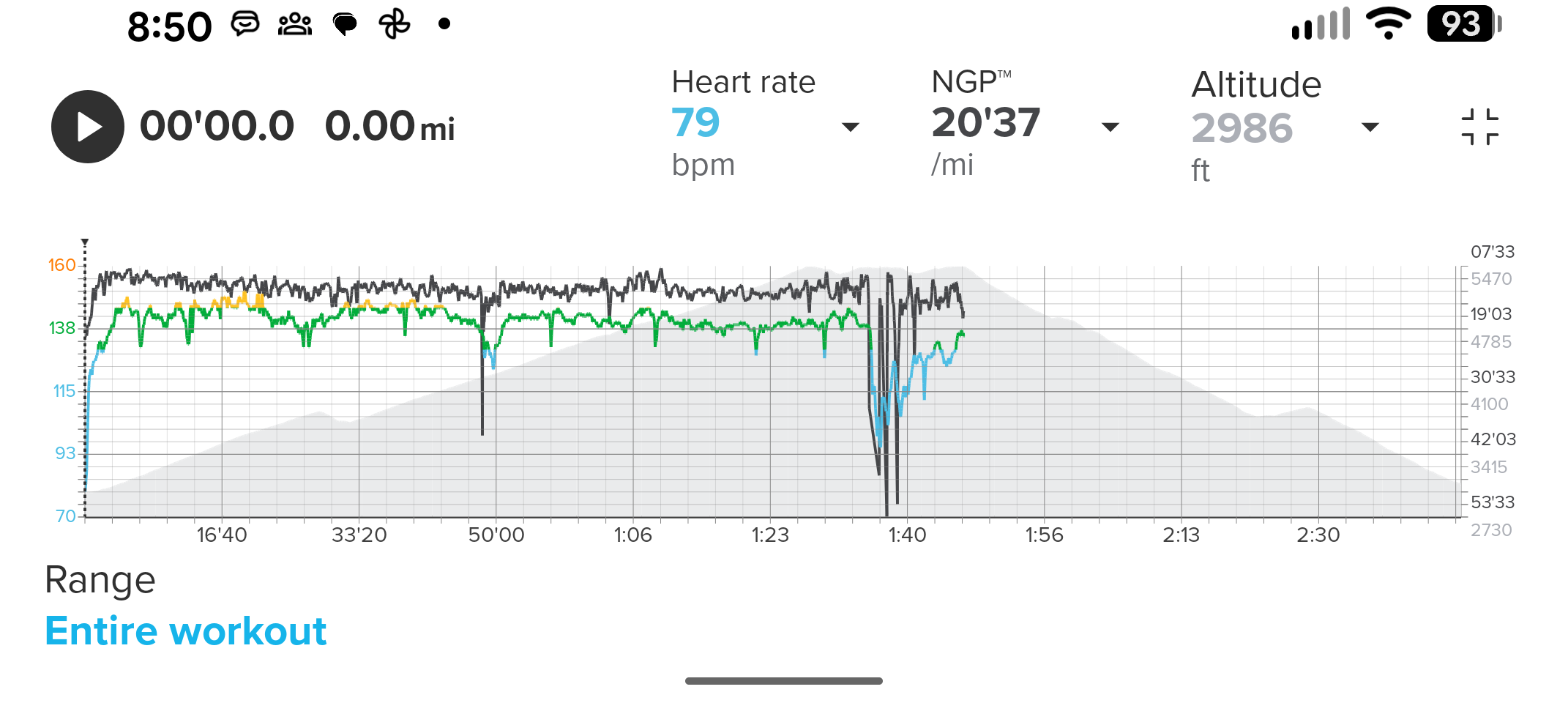

            sky-runner Platinum Member @sky-runner
            Here is a screenshot of what I mean taken on the Android app:
              aiv4r Silver Members @sky-runner
              @sky-runner Oh wow. Alright that is a different situation, somehow you lost NGP together with HR 😮
