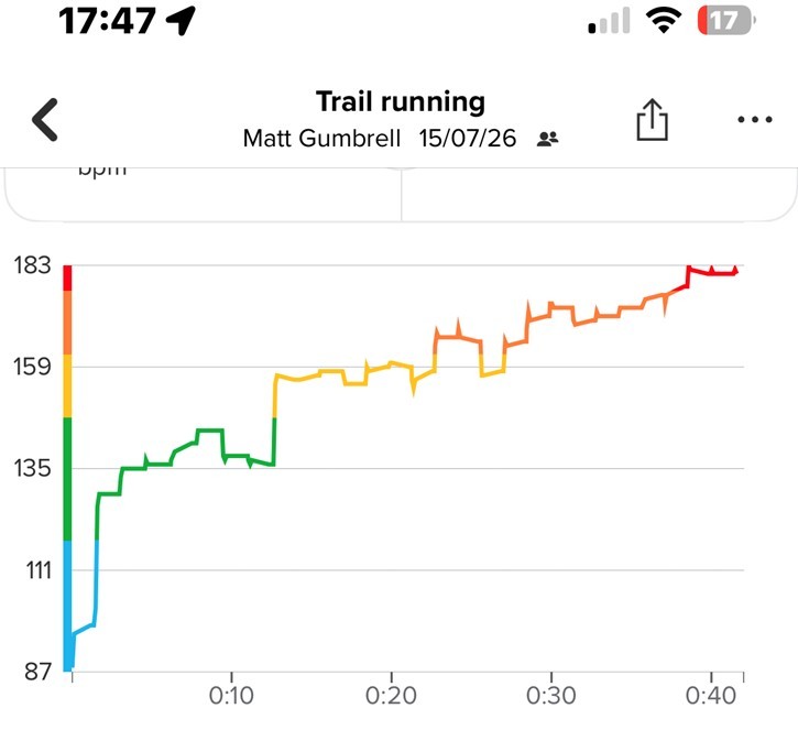

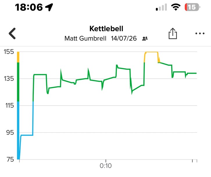

      It may just be huge coincidence but my Suunto HR sensor started continuously disconnecting from my Race on the afternoon of 14th July.
      The data is still saved in the HR sensor internal memory & synced to the watch when I end the activity but looks corrupt as below.
      HR sensor is only 8 months old & so far I’ve tried the following but the issue persists.

        I’ve done some more testing on this today as it seems to be local to myself,
        After a lot of messing around I’ve found that on the first disconnection if I remove the sensor belt altogether the watch continues to connect/disconnect even with the belt in a different part of my house… (wrist HR toggled off)
        That suggests to me that the issue is with the Race rather than the sensor.
        I’ve been through the delete sensor, soft reset, re-pair sensor cycle several times now without success so will have to try a hard reset to see if that resolves the issue (first one in over 3 years of ownership).

            @elbee Yeah I read that thread earlier, seems very coincidental that it started the day the latest V2/R2 update landed (for me anyhow).
            When you experience the drop outs does your HR look similar to this in the app afterwards ?

              elbee @Mattg576
              @Mattg576
              My troubles started months ago. Nothing to do with a recent firmware update for other watches.
              My graph looks different because I use a polar oh1+ heart rate sensor (which doesn’t have a memory to store unsynced data). After the bluetooth connection is lost, it just shows heart rate as 0 (zero)

                        @elbee so in your experience do you think the bug was always lurking in the software waiting to rear its ugly head ?
                        It’s been faultless really, my old smart HR sensor did fail 8 months ago but it was donkeys years old so wasn’t bothered, I bought a new one & that also just worked as expected until the 14th July when the wheels fell off between going for a run (fine) & messing about with some kettlebells straight afterwards…
