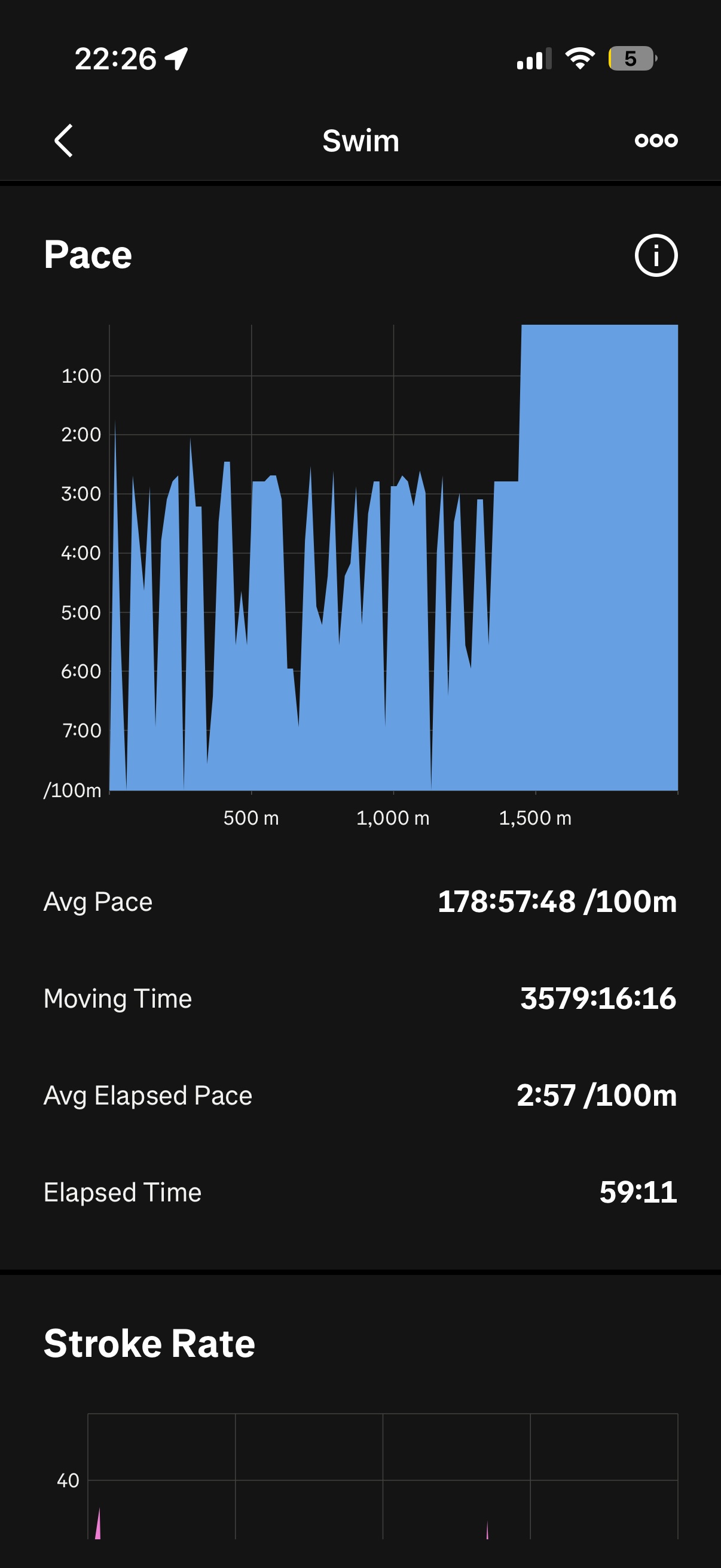

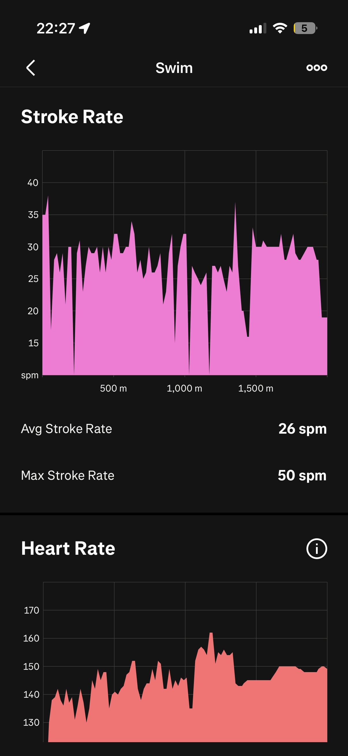

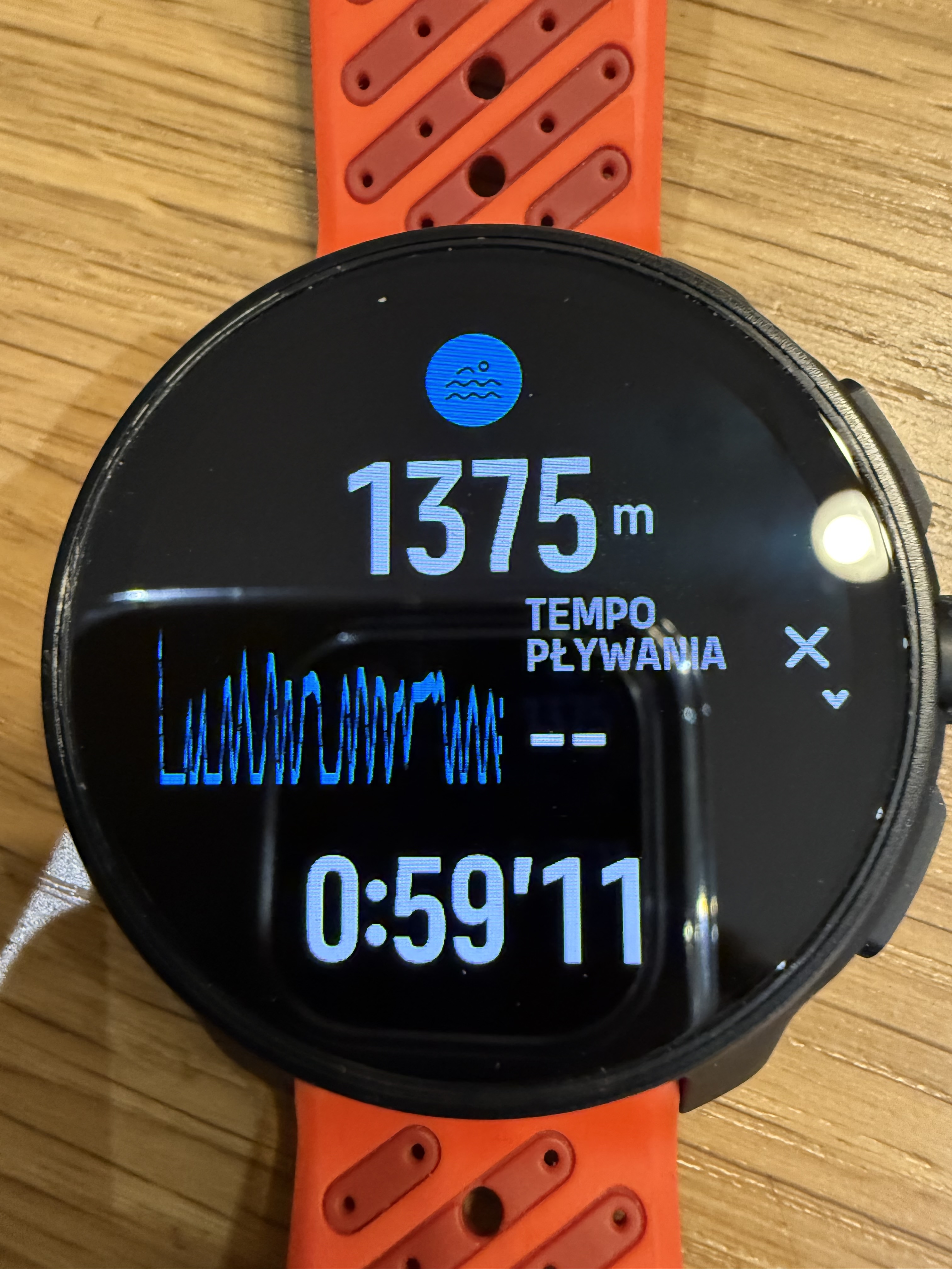

      Hi,

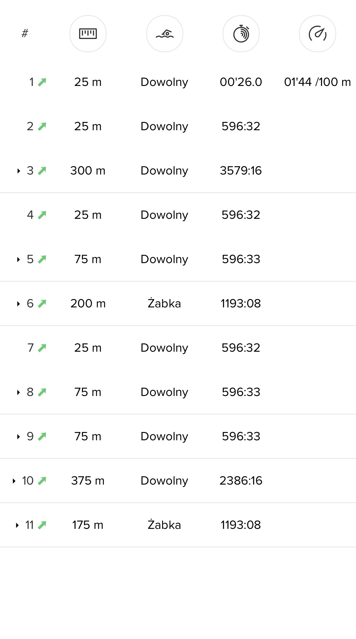

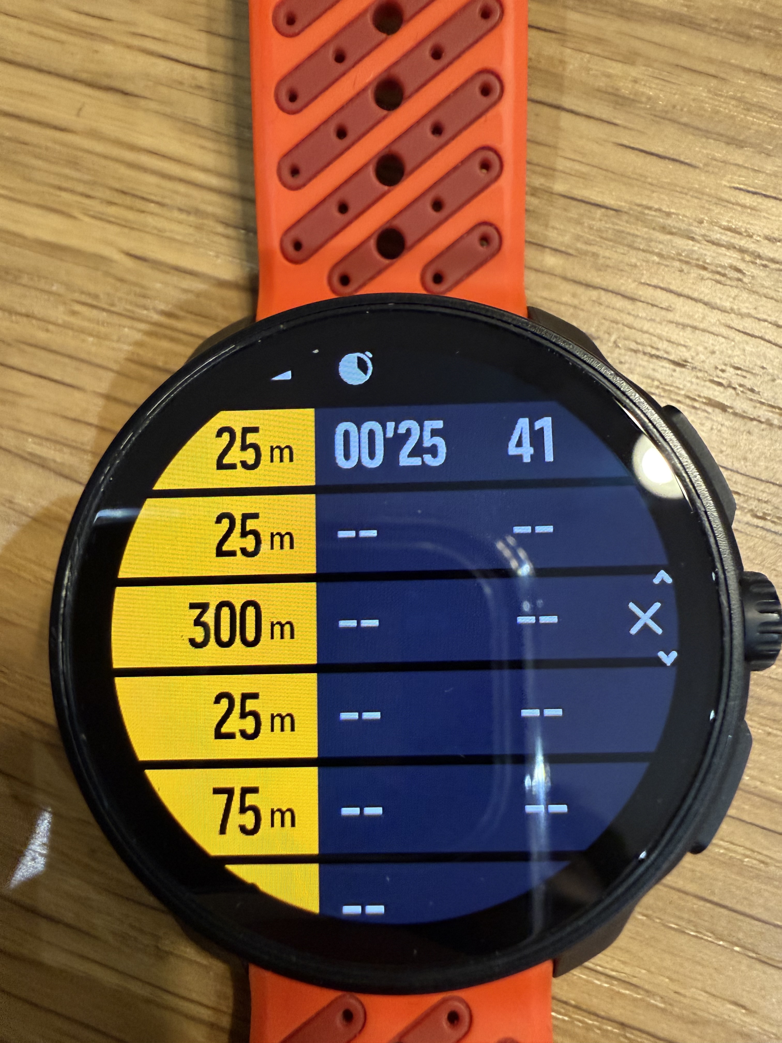

      today I faced a huge issue with pool swimming. Until I was swimming, everything was ok, when I finished, watch was showing 2000m and 59:11 of time. Then I finished the workout and saved. After that, 1375m was saved without any info on pace. Then look on the pics what happened after sync.
      On watch, intervals got no time, many are not shown at all. In Suuno app, only 1st 25m interval got correct time and pace. After that, there are 596:32 for each 25m. When exported to Strava, the workout got 1375m, 3579h16m of Time and 260:18:38 / 100m of Pace… On Strava, stroke and HB looks ok though…
      Any idea what is going on? I have Suunto Race 2 with newest firmware.IMG_4572.jpg IMG_4573.jpg IMG_4574.jpg IMG_4575.jpg IMG_4576.jpg IMG_4577.jpg

          Yesterday I also noticed problems with swimming intervals on my Race 2. It shows wrong duration. Sometimes on watch screen it shows duration of swimm interval of 596 hours? and in app it shows 596:32. I noticed that watch at first shows ok swim interval, but immediately changes display to 596 and when this number is shown than on iterval screen with big clock with moving arms there is no time --… on some occasion it shows ok, it is obvious some bug … I have watch just for a month, so I don’t know how it was before the update but I remember that this was working ok when I was using it probably before update

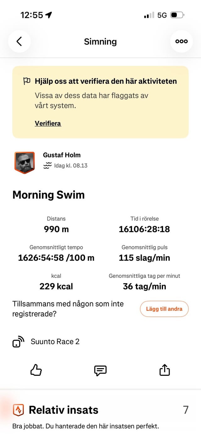

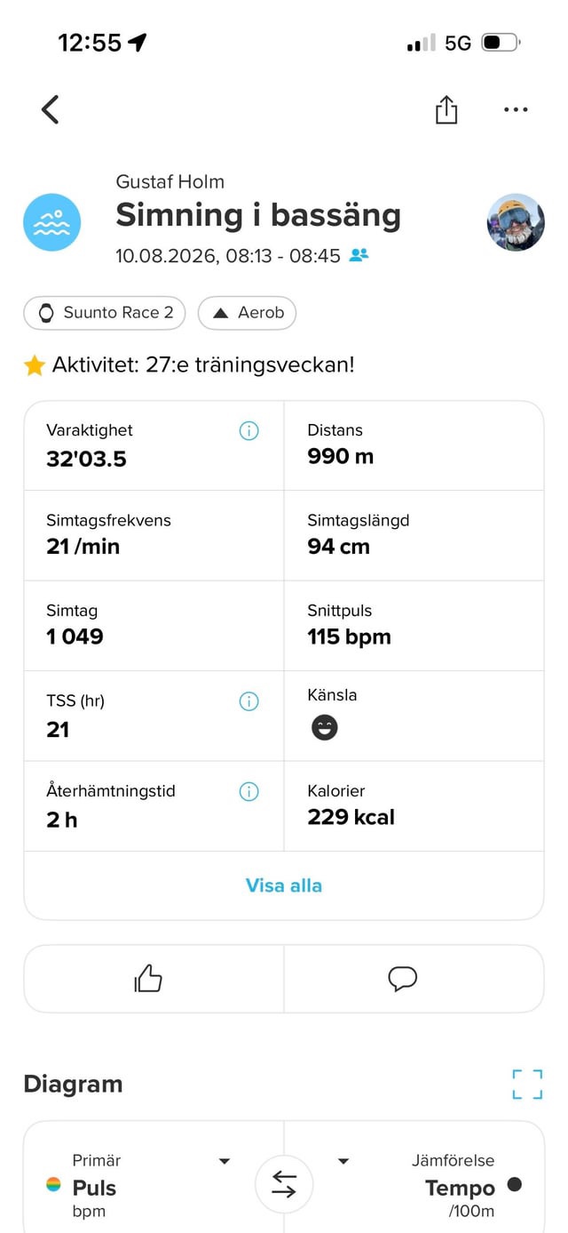

              Got similar problem, swimming activity with pool length set to 15m, the pool is actually 10 meters but there is no option below 15m. So I did 100 reps, 1000 meters, in watch 1500m. I’ve done this multiple times but yesterday the watch saved the session as ”butterfly swim” with 990m which might me gps correct. But only 1 interval and the time is correct in Suunto app. But upon uploading to Strava I saw the crazy hours as in the screenshots.

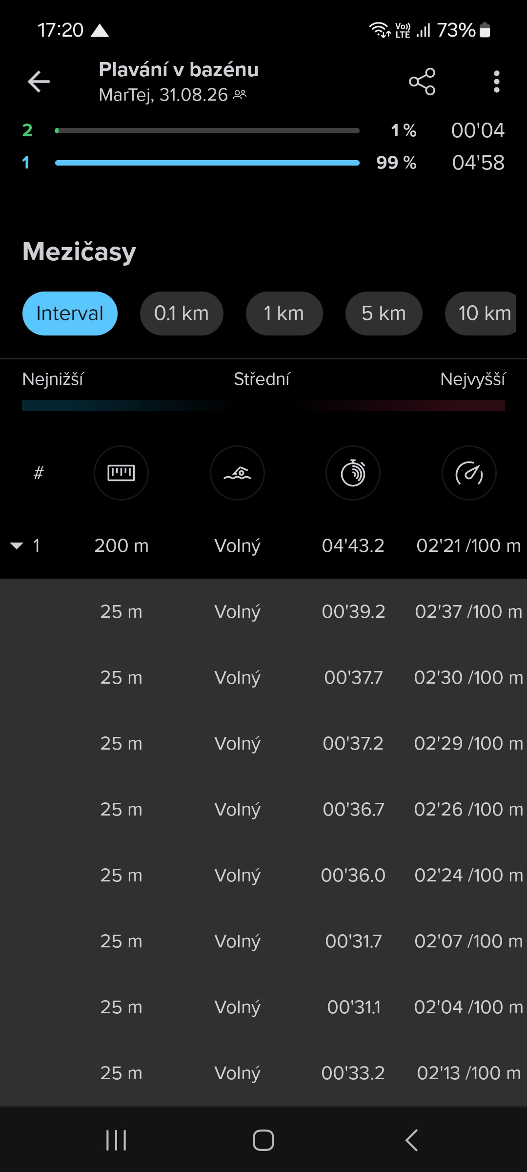

                        • M Online
                          MarTej_cz @iscottjames
                          @iscottjames ahoj, data které máš dávají smysl.
                          Protože nastavit 15m a plavat 10m je rozdíl dojde tam k otočení. Příklad: Nastavím hodinky na 100m bazén Plavu směrem na sever v polovině otočím a plavu směrem na jih. Když se otočím na 50m započítá mi 100m.
                          Plavání v bazénu bez GPS funguje podle mě podle kompasu a gyroskopů

                                      I cannot fix the root cause in the watch, but export to FIT files (and Strava) should gracefully handle the corrupted records. At least to the level when no intervals have abnormal duration.
                                      To fix broken workouts in Strava you need to delete it, export FIT file from Suunto App for the workout and upload it to Strava
