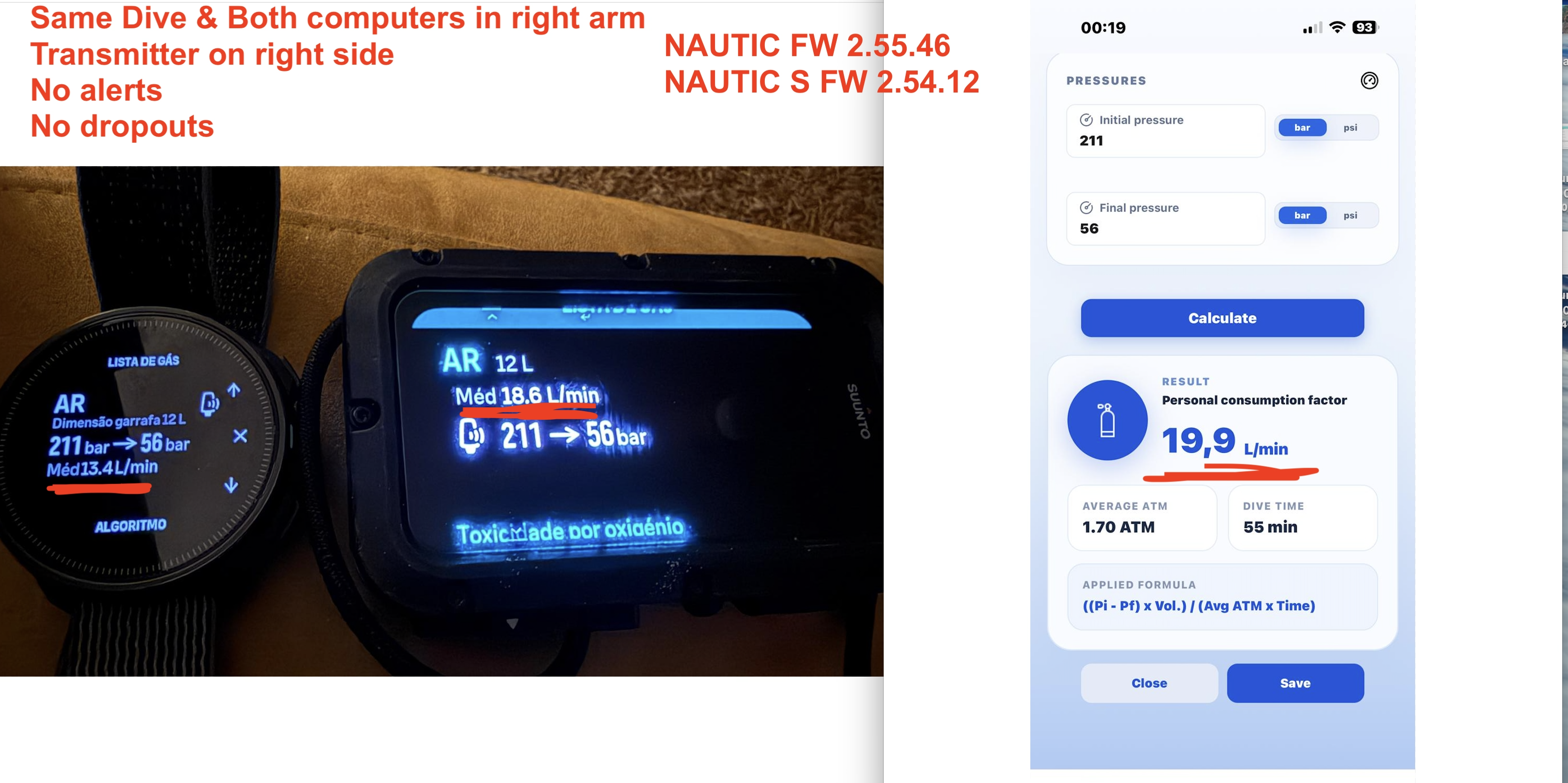

      The following air consumption is not making sense on the Nautic S, the Nautic might be correct.
      Nautic S & Nautic the have the same tank configuration (12L)
      Tank 12 L x 197 bar = 2364 bar
      start 197 Bar
      end 43 Bar
      154 Bar x 12L =1848
      2.70 ATM x 44 minutes = 118
      1848L / 118 =15,6L minute
      FORMULA ((Pi-Pf) x Vol.) / (Avg Atm x Time )

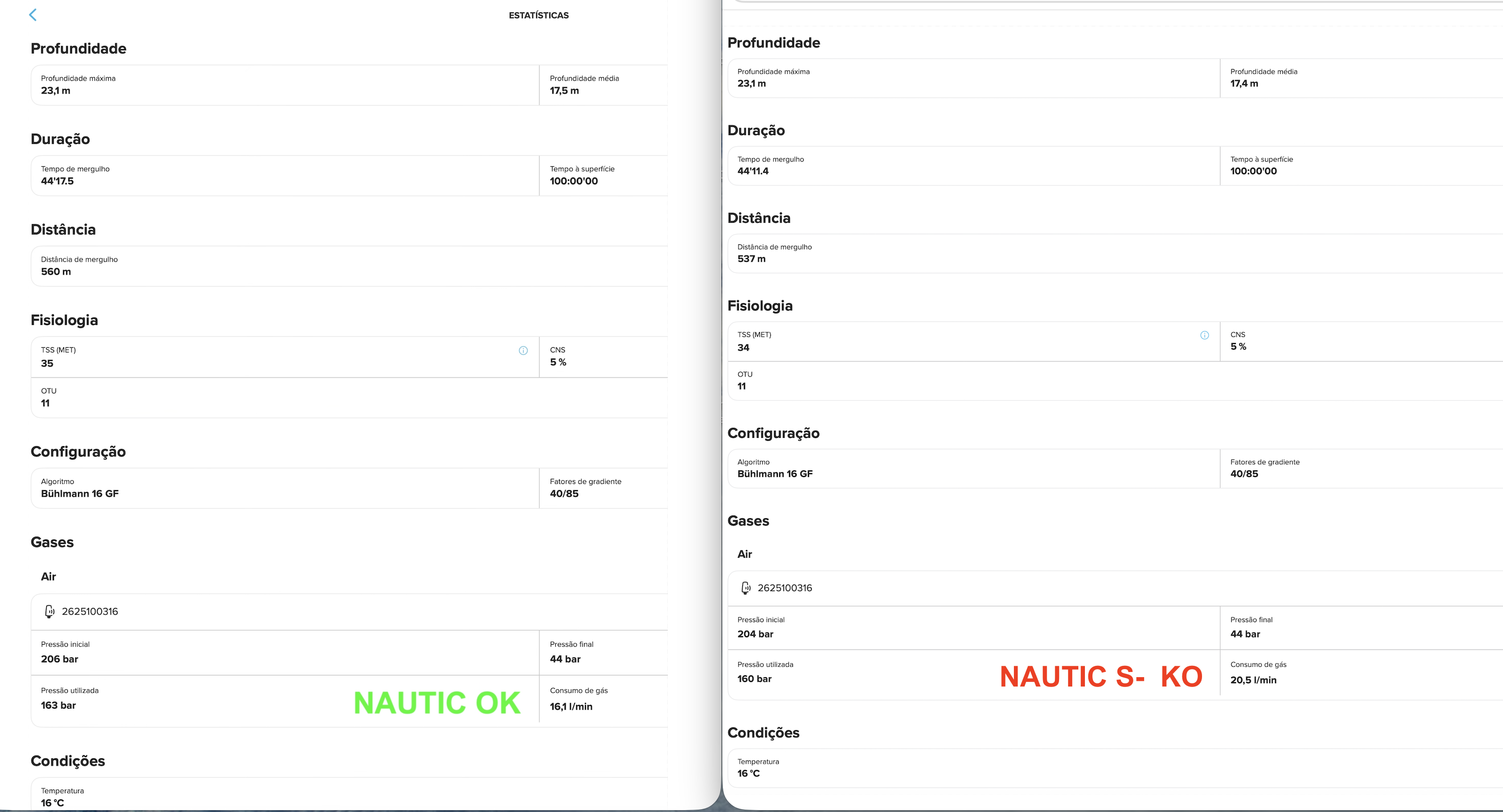

                On this dive
                Nautic - Same side has transmitter
                Nautic S - Opposite side of the transmitter

                  Here the behaviour was the same
                  Nautic - No dropouts no issues (right arm + transmitter side)
                  Nautic S - dropouts and issues calculating consumption (left arm + opposite transmitter)

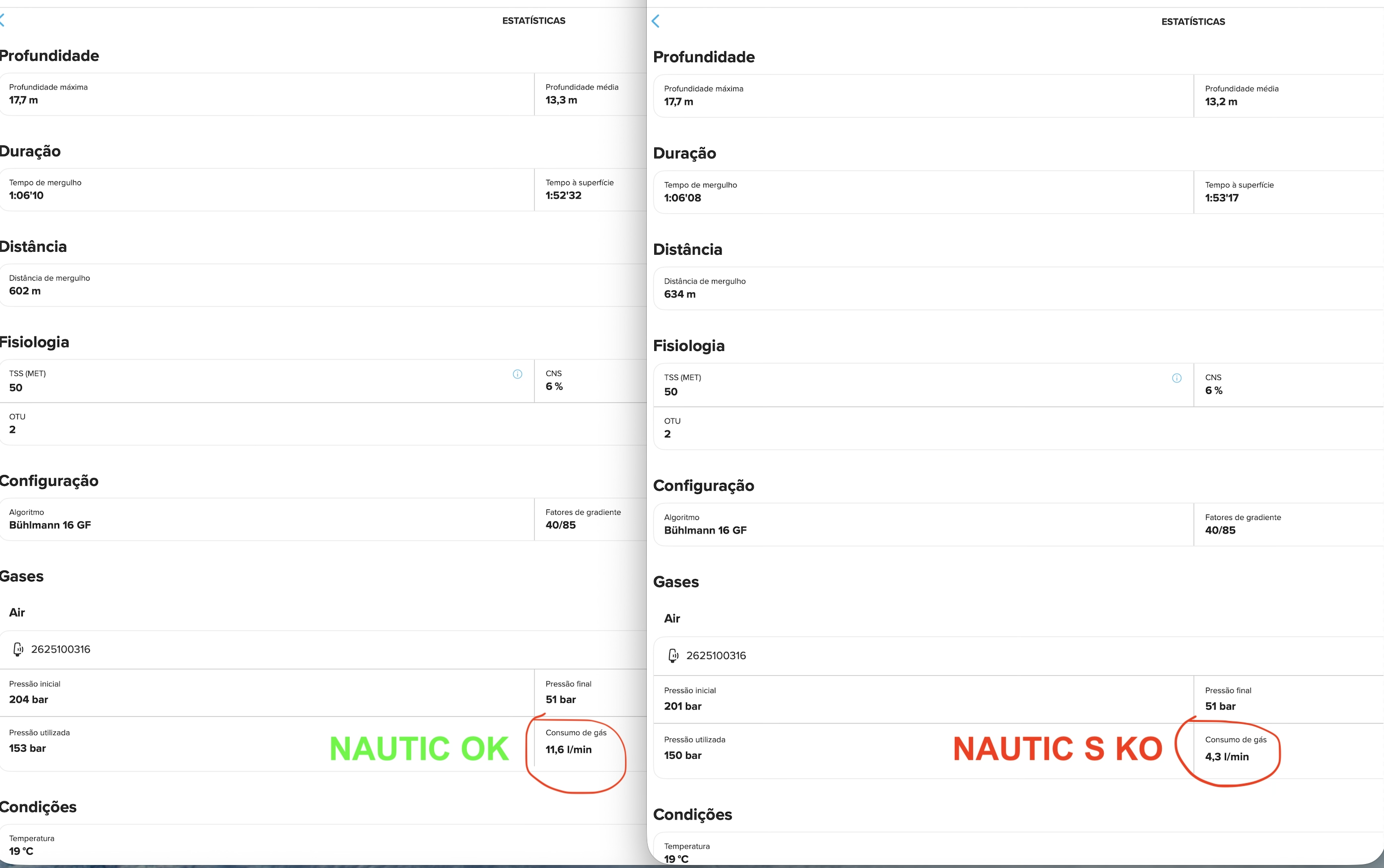

                  • N Offline
                    Nandodiver Bronze Member @Nandodiver
                    Keeping both computers on same side of the dive transmitter seems to improve the dropouts and alerts
                    The issue/bug is why 2 x computers connect to the same transmitter give us different air consumption
                    Even more weird the log of Nautic S dive dont show up in the suunto app/Mac, even after new pairing

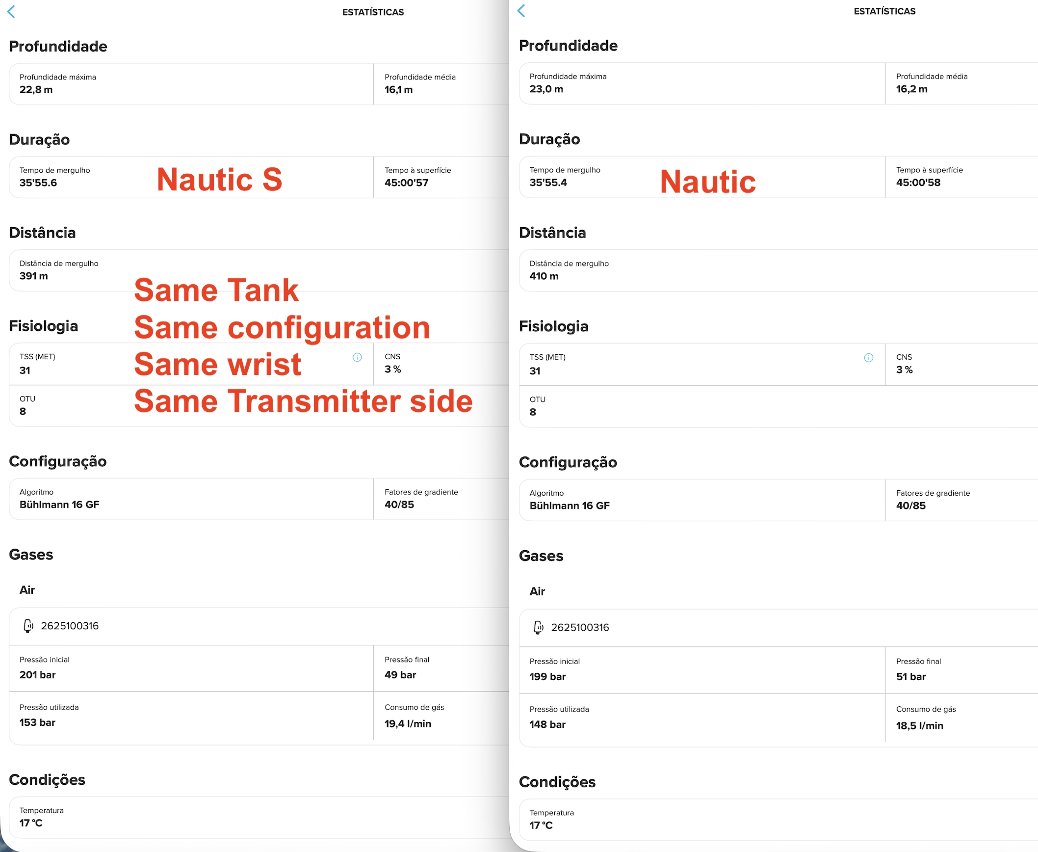

                    • N Offline
                      Keeping both computers on same wrist & in the same side of the dive transmitter seems to fix the dropouts and alerts…
                      this dive even the air consumption was very similar.
