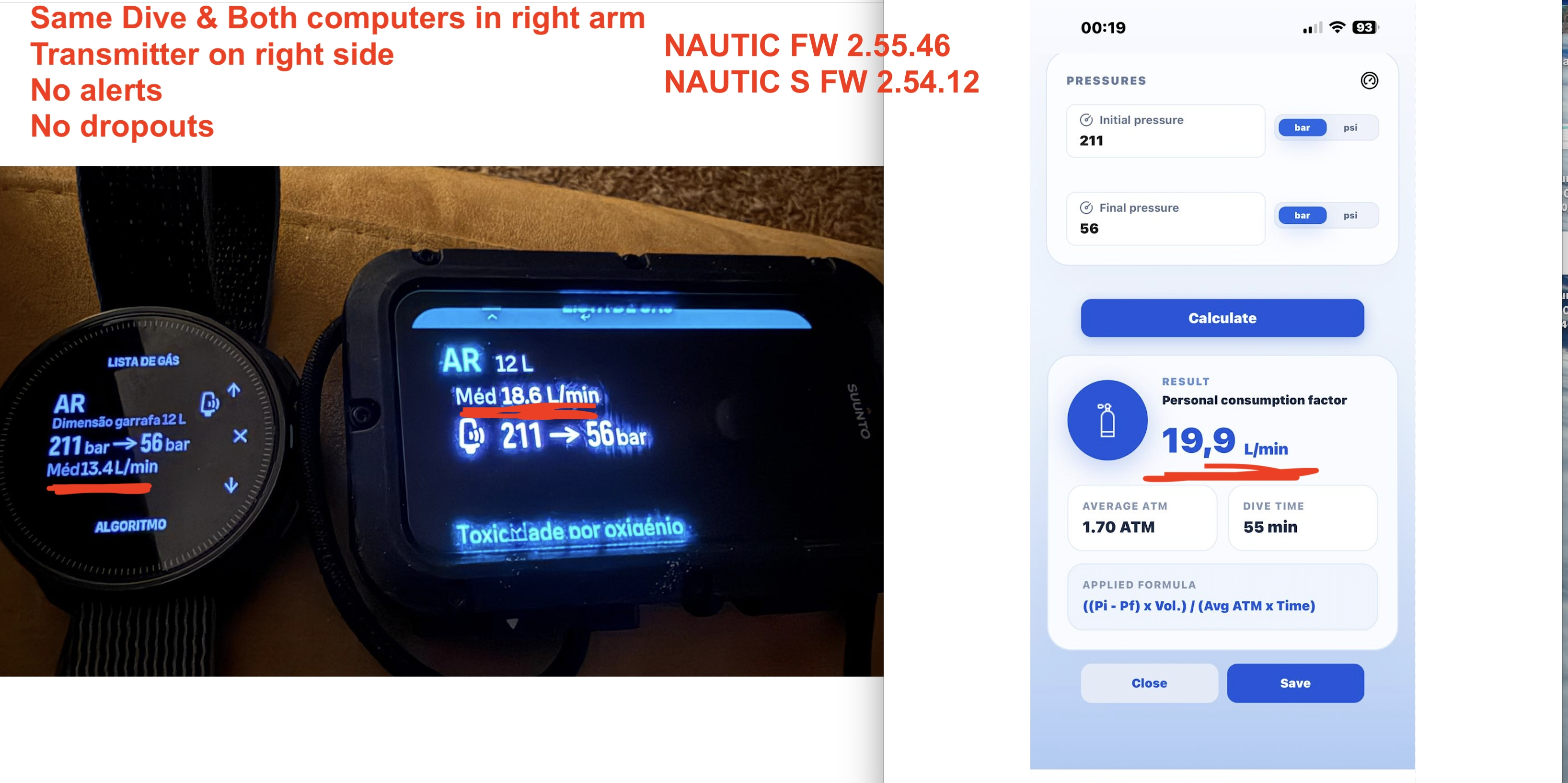

        Keeping both computers on same side of the dive transmitter seems to improve the dropouts and alerts
        The issue/bug is why 2 x computers connect to the same transmitter give us different air consumption
        Even more weird the log of Nautic S dive dont show up in the suunto app/Mac, even after new pairing

          @Nandodiver For the SAC Calculation Suunto uses a very complex formula which includes a Compressibility / Temperature factor. See here: https://www.suunto.com/Support/Product-support/suunto_nautic/suunto_nautic/wireless-tank-pressure-support-/gas-consumption/. So it might be different from a calculations which does not take these variables into account.
          I agree it is strange that the Nautic S and Nautic have different outcomes of SAC by using the same Tank / POD.
          This weekend I will take my EON Core with me and do the same. I will report back…

                    @Migsey That is strange… you didn’t get the SAC Rate in the dive log? And you did see the tank pressure declining as SAC is calculated in the Nautic and doesn’t have anything to do with the POD other then tank pressure. I will dive tomorrow with both and implemented the SAC / consumption switch window… I will report back…

                      @Migsey nothing to due with new firmware or old firmware.
                      I had no SAC calculation twice in old firmware versions (NAUTIC)
                      In latest firmware FW 2.55.46 happened on the first dive and in the following dives everything is normal… (NAUTIC)
