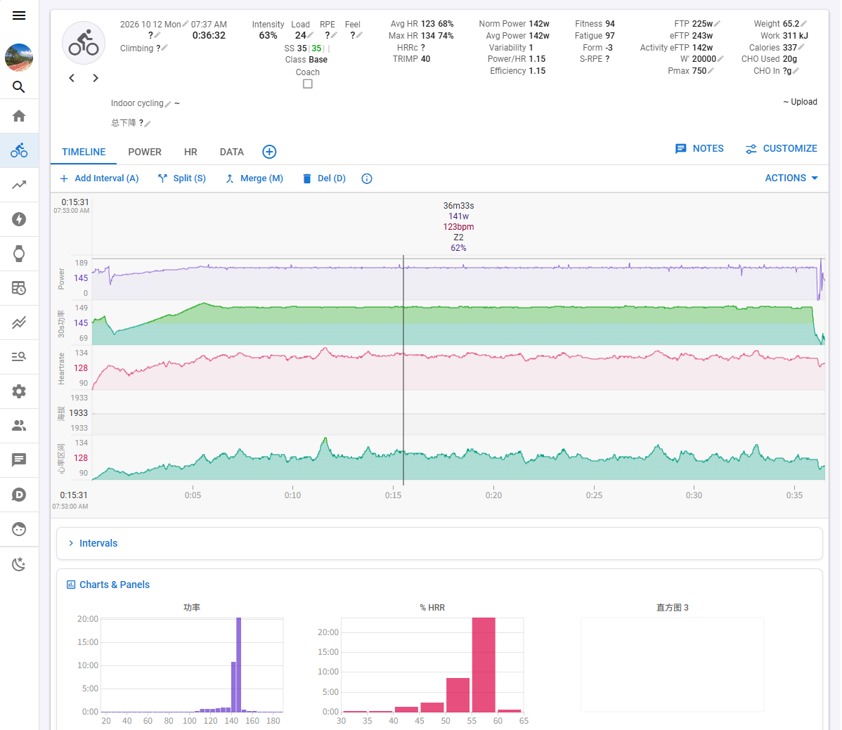

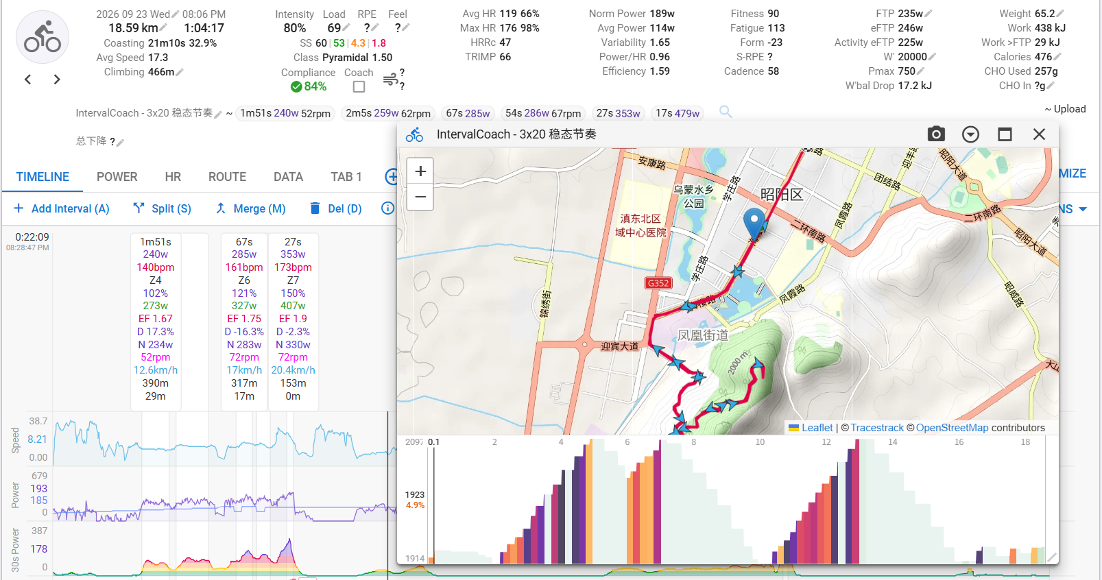

                    I recorded an outdoor ride and an indoor ride today using the Suunto Ambit2. The test results are as follows:
                    For the outdoor ride, data synced from Sommet to Intervals.icu correctly, as shown in the figure below.

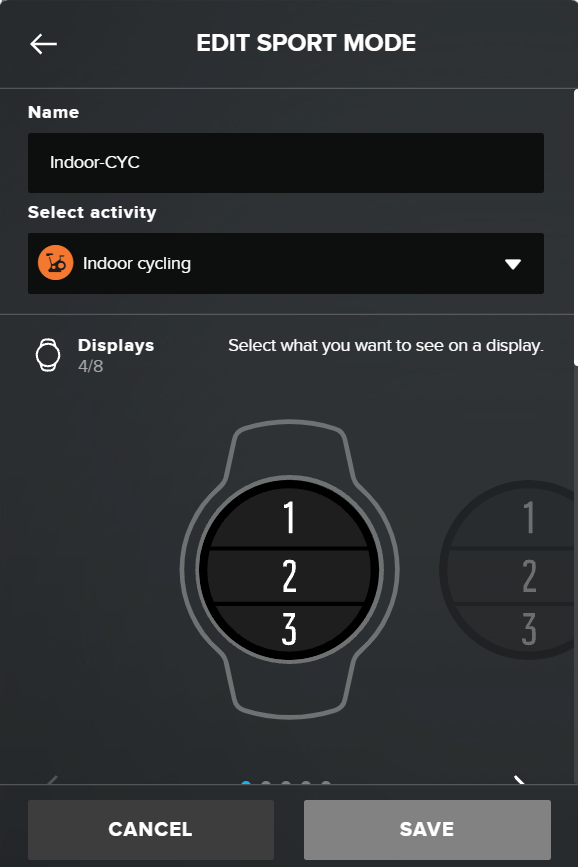

                    The watch settings for indoor‑riding mode are shown below.

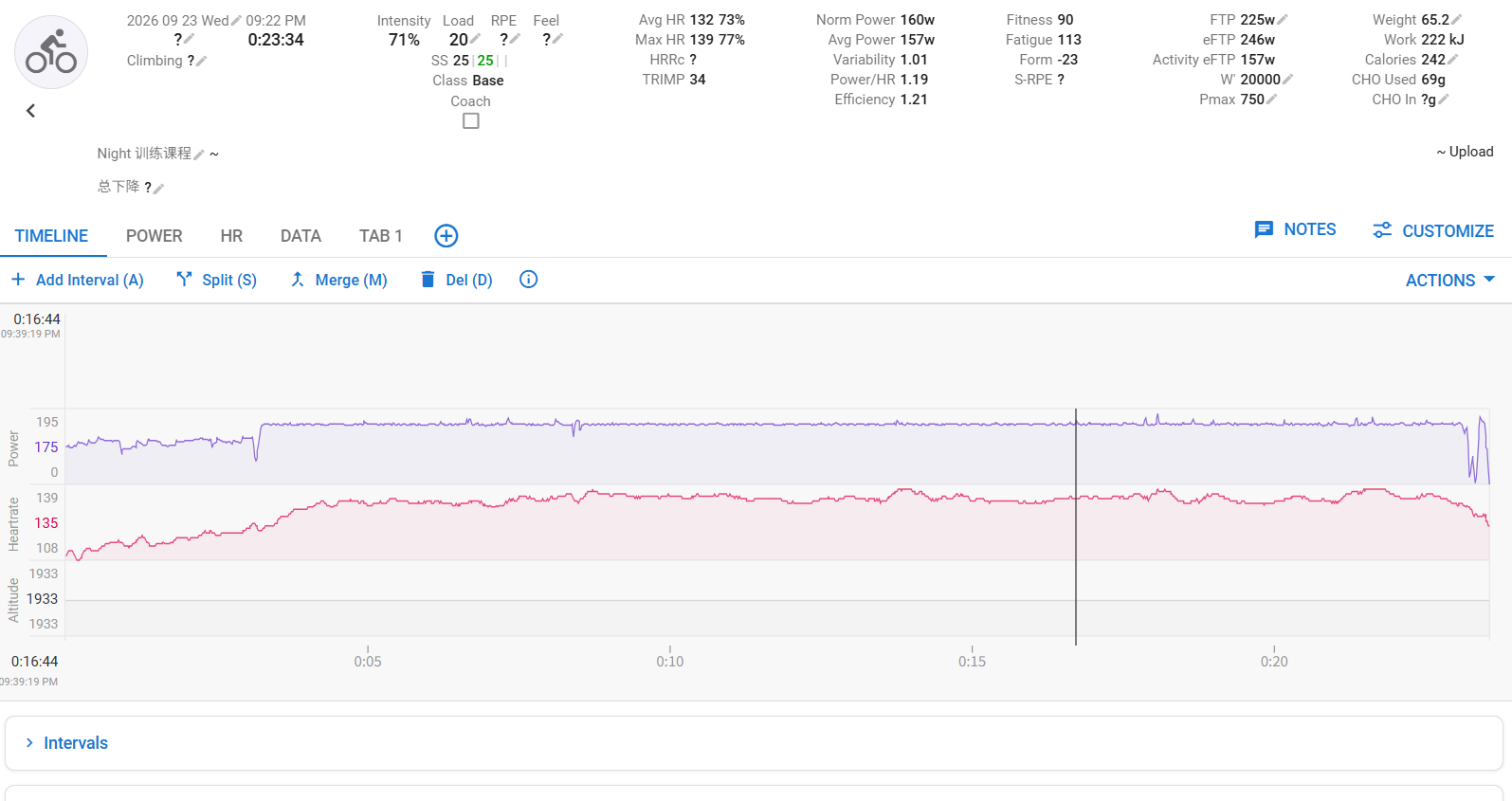

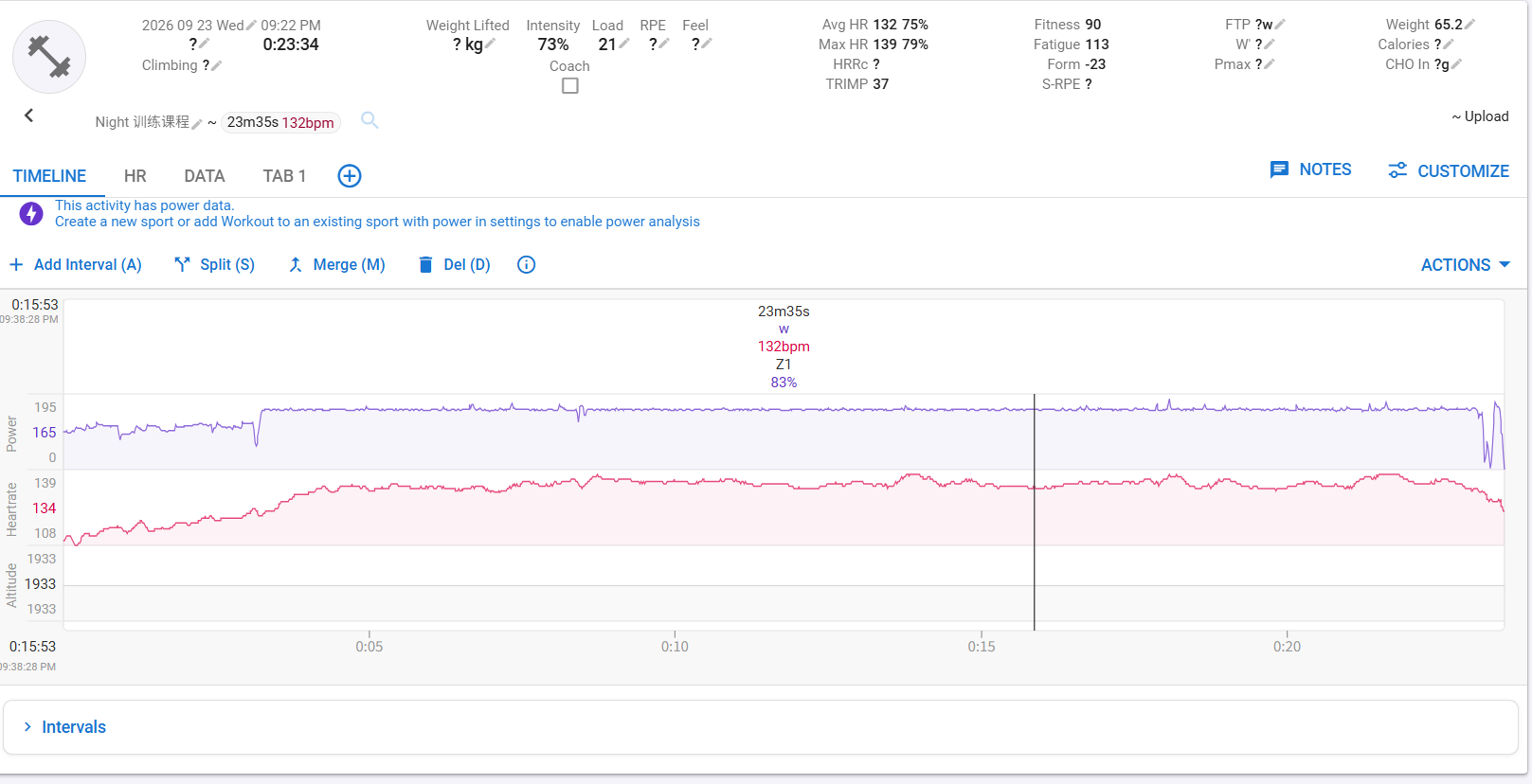

                    When synced to Intervals.icu, the activity is labelled as strength training.
                    I need to manually change the mode to virtual ride.
                    André FariaA 1 Reply Last reply Reply Quote 0
                    • André FariaA Offline
                      André Faria @zt_zzzzz
                      @zt_zzzzz thanks for the feedback.
                      Why it happened:
                      The indoor-riding move’s FIT declared sport = generic, and intervals.icu files a generic, no-distance move as strength training. It came out generic because:
                      • A watch move’s activity_name is empty, so the sport rides only in the activity-id byte.
                      • My earlier byte→sport map was copied from mobile’s GpxParser.SPORT_TYPE_MAP — which turns out to be an older, off-by-one, incomplete table (it says 19=Alpine when Suunto’s real id is 20, and it has no indoor cycling at all). So id 17
                        (Indoor cycling) fell through to generic → strength.
                      Also fixed for strava.
                      Pushed a v2.3.8 release with that, should be on github within some minutes. Hope you haven’t lost data.
                      For info I don’t have anymore an ambit 2 to test. So I rely on users feedback.

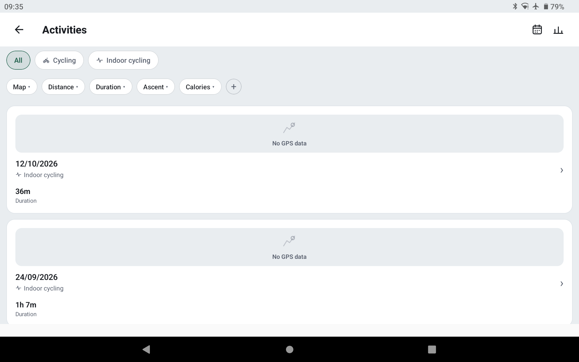

                        Excellent, both indoor virtual cycling and outdoor cycling can be normally exported to Intervals.icu.
                        (Ambit2 Andriod12)
                        Thank you very much for your hard work.
