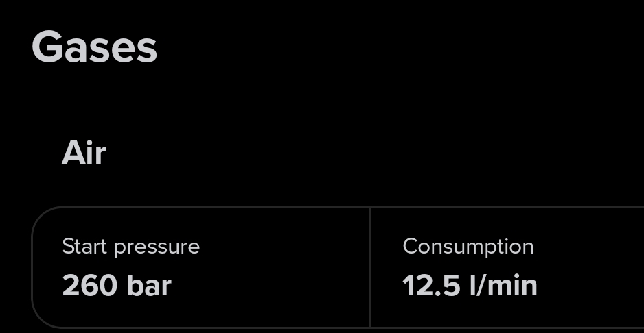

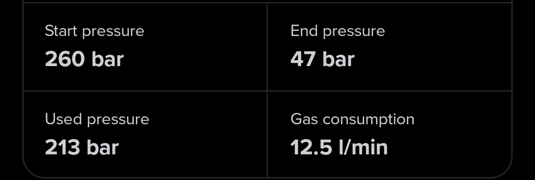

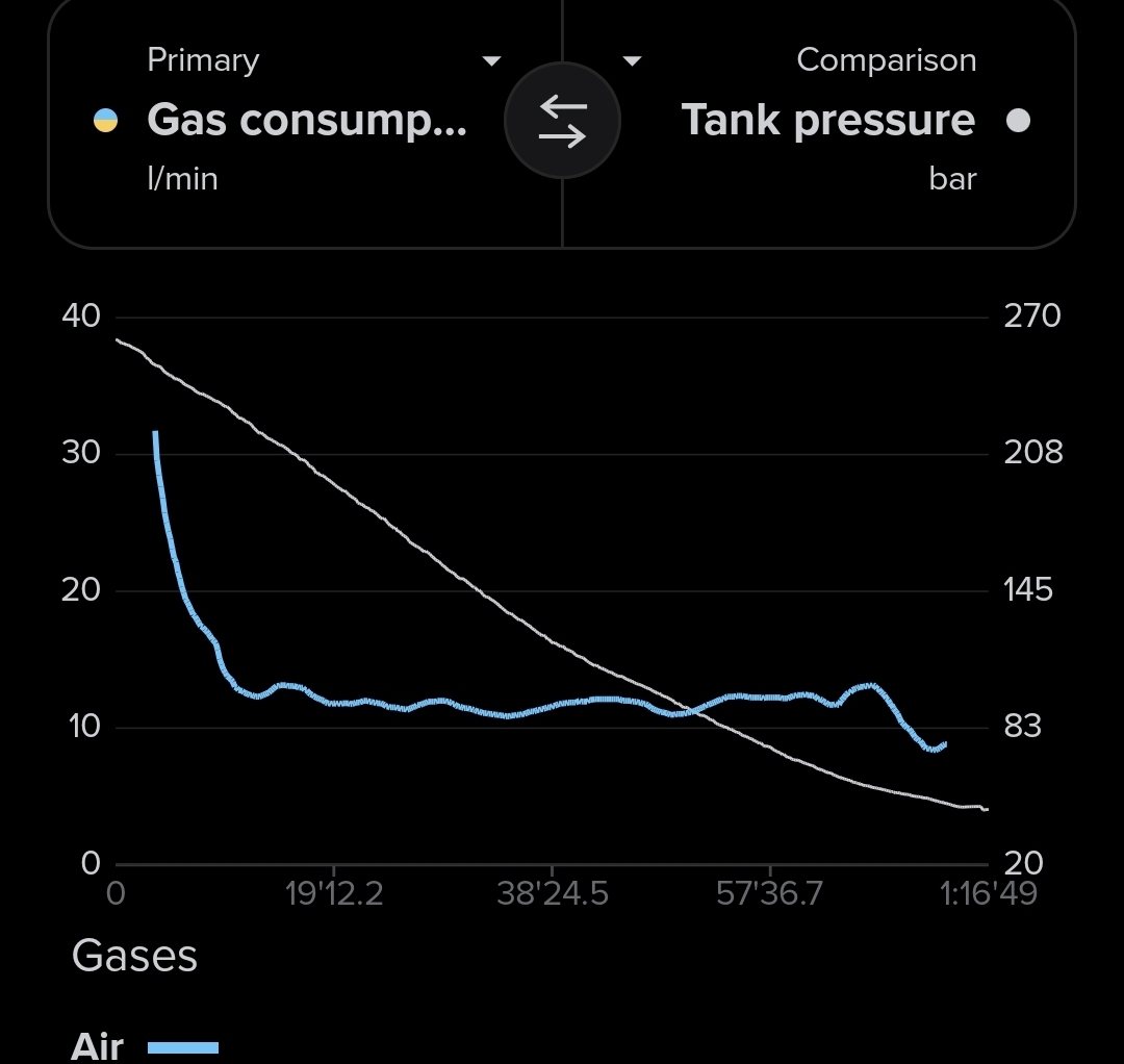

          @Migsey If you see the pressure, the problem sits in you app. As the SAC is derived from the pressure during the dive. In the beginning of the dive the SAC is - - <null>, thats normal. But later in the dive the SAC should set on an average number and should never show - -. I checked this morning with the Nautic and EON Core… they are identical…
          Suunto Nautic, Latest FW:
          Suunto EON Core, Latest FW (4):

              @Migsey wrll, my dive this morning was with the new firmware and I noticed that after a minute the SAC value started high and graduately leveled around 12 / 13.
              But you have seen the tank pressure, so it simply cannot have anything to do with the POD as it only transmit. The Nautic picks up the signal and applies it’s magic with tank sizes and internal calculations. Did you check the tank size and dive mode like single multi gas in the settings?
