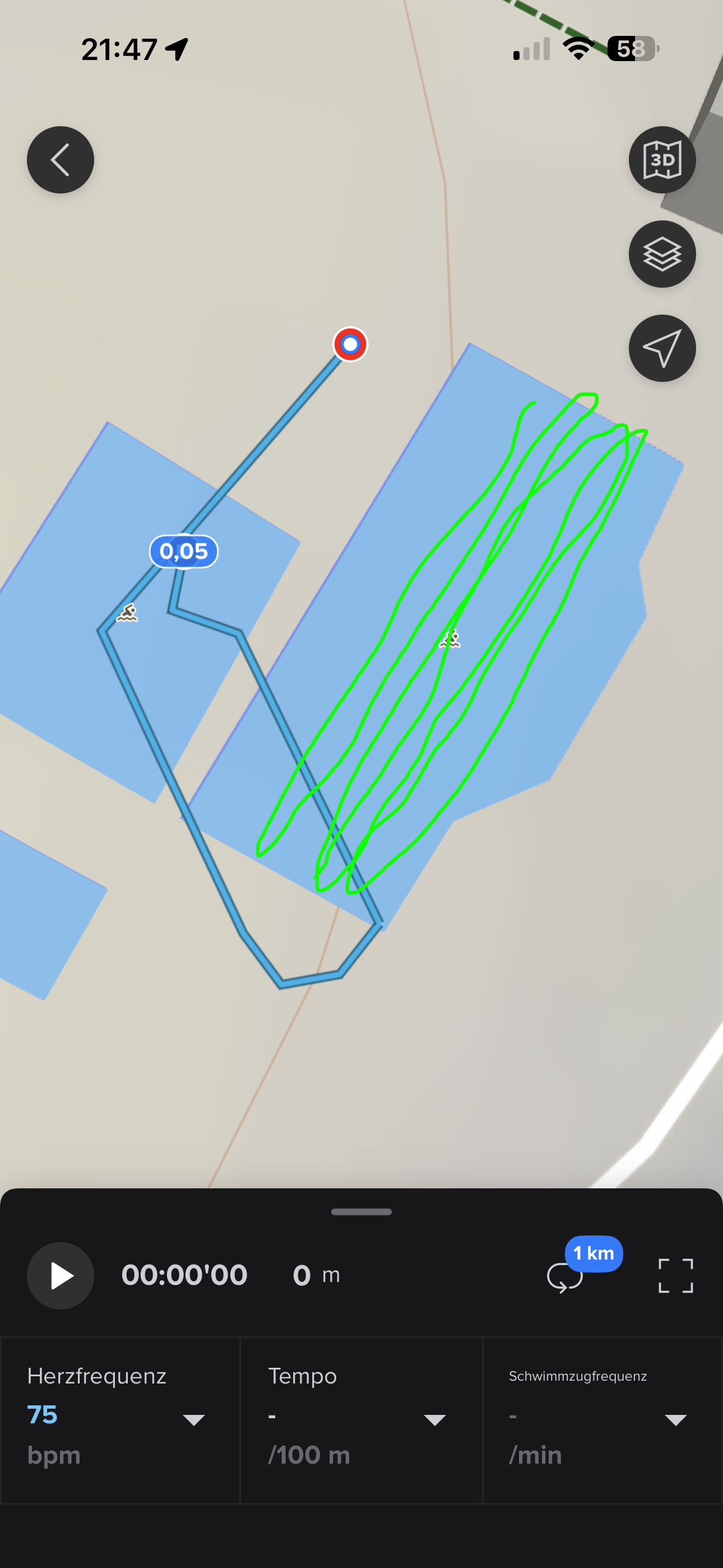

                    Sascha Domres Bronze Member @Egika
                    The one marked in green was about my actual swimming direction. I waited outside the pool for the GPS reception before I went into the water . It is an outdoorpool…
                      2b2bff Gold Members @Sascha Domres
                      @Sascha-Domres what swim style did you do?
                      Garmin Fenix 8
                        Sascha Domres Bronze Member @2b2bff
                        @2b2bff Crawl swimming and at the edge the Watch was certainly a little longer out of water…

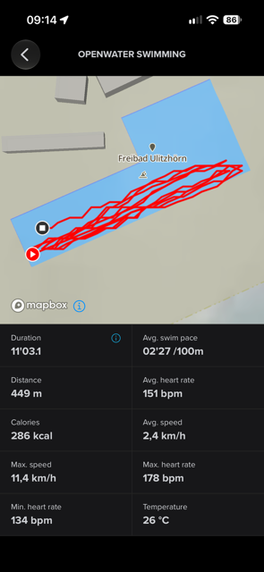

                          @Sascha-Domres ok, this is important information. Outdoor pools should work with open water swimming “somehow”. I was doing some triathlons that started with doing lanes in an outdoor pool. Since triathlon mode used to work only with open water swimming, I had to use this mode.
                          The 500m swimming was logged by Suunto Race S as 449m - I think this is acceptable regarding the “misuse” of the mode.
                          With this in mind, and you swimming freestyle, the watch should indeed log something better. As for every other open water swimming, it is important to give the watch some minutes time to proper acquire all satellites in the best possible way.

                          Here is my open water pool swim i mentioned above:
