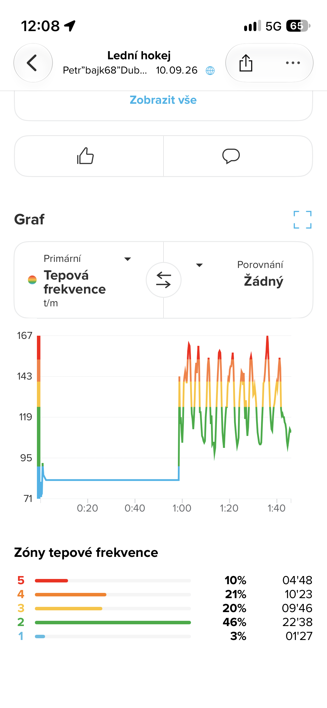

                On Thursday, I recorded an ice hockey session using a new Suunto strap, following the instructions exactly; I left my Race S watch in the locker room, and after the session, I stopped the activity and waited for the data to sync to the watch. Upon checking, I found that the heart rate graph only starts at around the 50-second mark of the activity. This also happened during my previous session when recording to the Suunto Smart HR memory. Am I doing something wrong? Thank you.

                  Squirrel Silver Members @Petr Dubský
                  You mean 50 minute mark
                  Do you have new HRM2, or previous Suunto HRM?
                  Petr DubskýP 1 Reply Last reply Reply Quote 0
                  • Petr DubskýP Online
                    Petr Dubský @Squirrel
                    @Squirrel Máš pravdu , zaznam TF zhruba po 50 minutách , napsal jsem to špatňe , mám suunto smart sensor zakoupen 7/2026 chtěl jsem zaznamenávat aktivitu (TF) bez hodinek a stále mám problémy, jaký je správný postup synchronizace HR SUUNTO SMART po aktivitě .
