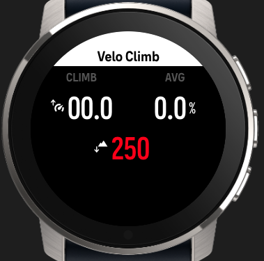

      Screen 1 - Climb screen
      • Current gradient, formatted as a percentage.
      • Current rolling VAM.
      • Maximum gradient.
      • Total ascent.
      • Current category label with its category color.
      Pressing the watch’s lower/down button sends an app event and switches to the second screen.

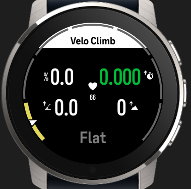

              Merged the gauge and some extra bits.
              • Gauge to represent current climbing category
              • Descent category added
              • HR on first display
              • Remaining climbing (if loaded route) on second display
