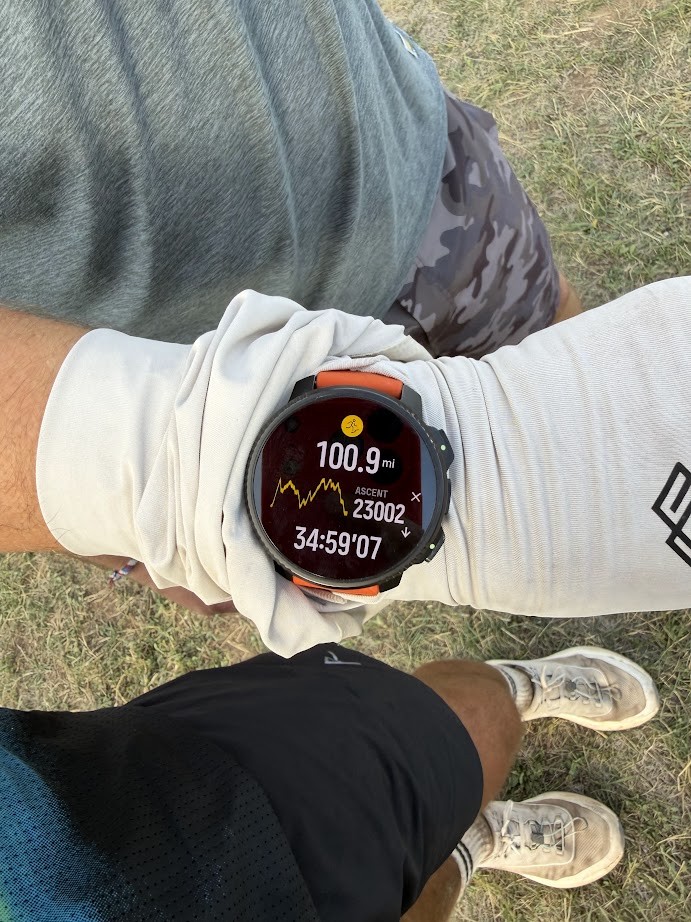

      I have been training with the Vertical 2 for about a year and like many folks here ran into restart issues, almost exclusively occurring during longer trail runs using a custom trail run activity.
      Well - hotfix seemed to fix it (for me at least). 35 hours following a route with climb guidance, watch worked flawlessly. The ONLY thing that was a bit weird was I would get black grid lines switching to the map screen as it rendered the map later on in the race. Nothing major as they went away within a second or two.
      35 hours, 54% battery use

        @stromdiddily This sounds very encouraging! Congratulations on the race finish!
        I don’t plan on another 100 miler any time soon to test if the fix worked for me. Did you use waypoints or phone notifications during the race? I think my crashes were triggered by notifications from waypoints and/or phone texts, however it could be a coincidence.

          @sky-runner I had my phone on airplane mode most of the time so my mobile notifications were limited but I did use waypoints for each aid station on my route. Had no issues receiving those notifications, so hope for you maybe!
