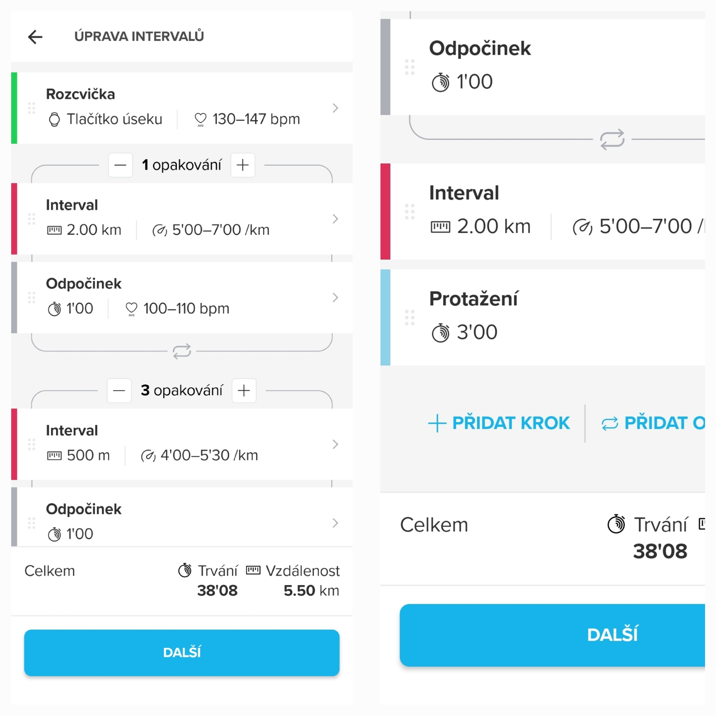

              @Pshemo74 hi, I have Race 2. custom sport mode, automatic laps off, suunto + turned on the given training and some information - sugar, fat, running, walking, stopping. some APKs. suunto+ give laps automatically then there is confusion. 1000004359.jpg
              Android 14
              Suunto APK. 6.13.8
              R2 2.56.28
