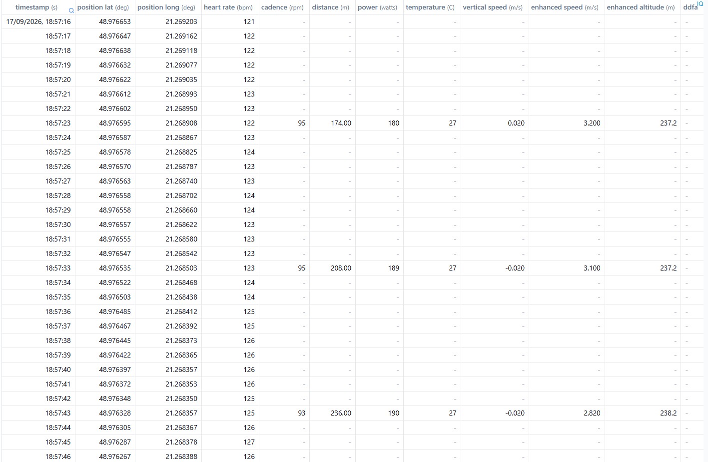

      Hello,
      I am a brand new user of Suunto brand for 4 days now, coming of a Garmin. That watch is the best and prettiest piece of equipment I have ever had and I love it, and cant understand why I was sticking with Garmin for so long lol.
      I did 3 runs with it in those 4 days, 2 in endurance mode with external HRM also using zonesense, the last run was in performance mode without HRM.
      I notice one “issue”, both of those runs in endurance mode logged gps position and heart rate every second, but every other data - altitude, temperature, cadence, power etc etc it logged only every 10 seconds. - I’ve also looked into FIT file and its clearly visible there.
      Then I decided to test if that would change in different power mode and i used Performance mode without external HRM this time, and it logged perfectly every single second. BUT, looking through FIT file I’ve noticed, that at certain points it did record HR only every other second and other data normally, at certain timestamps it recorded everything except GPS coordinates and the same with cadence at other timestamps.
      Is that normal? Can it be changed? Is that issue because of using external HRM?
      Thanks for every response.

          @MarTej_cz Hi! First picture is how FIT file of the run (or any activity) in endurance mode looks 98b2298d-9150-4c0c-97cd-659db7f1239d-image.jpeg

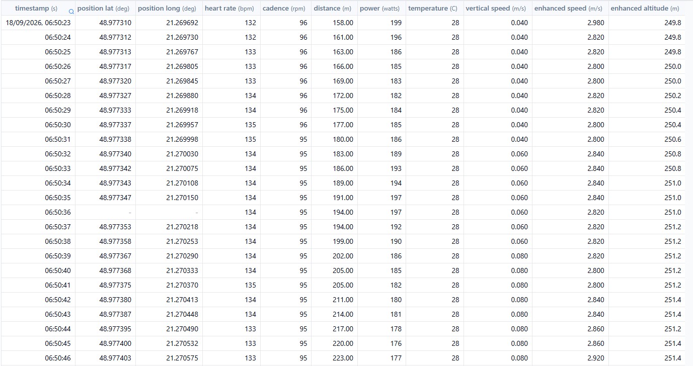

          And this is how it looks in performance mode, but withou external HRM…

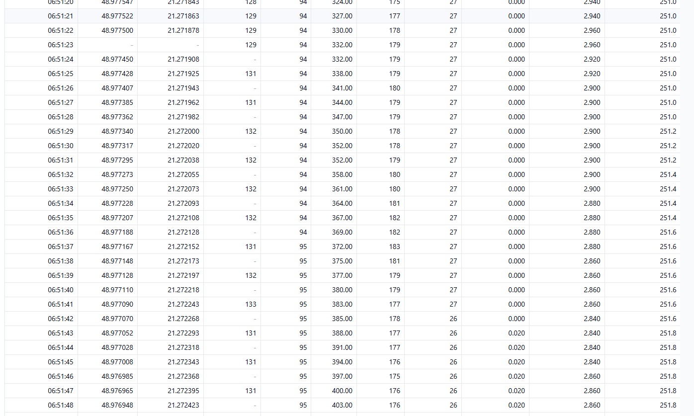

          Then in the same activity it started recording HR on only every other second. It was doing back and forth of recording normally and recording every other second.
          Also I just noticed, that during today’s hike in endurance power mode, it recorded HR every second, but it recorded GPS coordinates with 1 or 2s gaps, and also, as usually, every other piece of data with 10s gaps.
