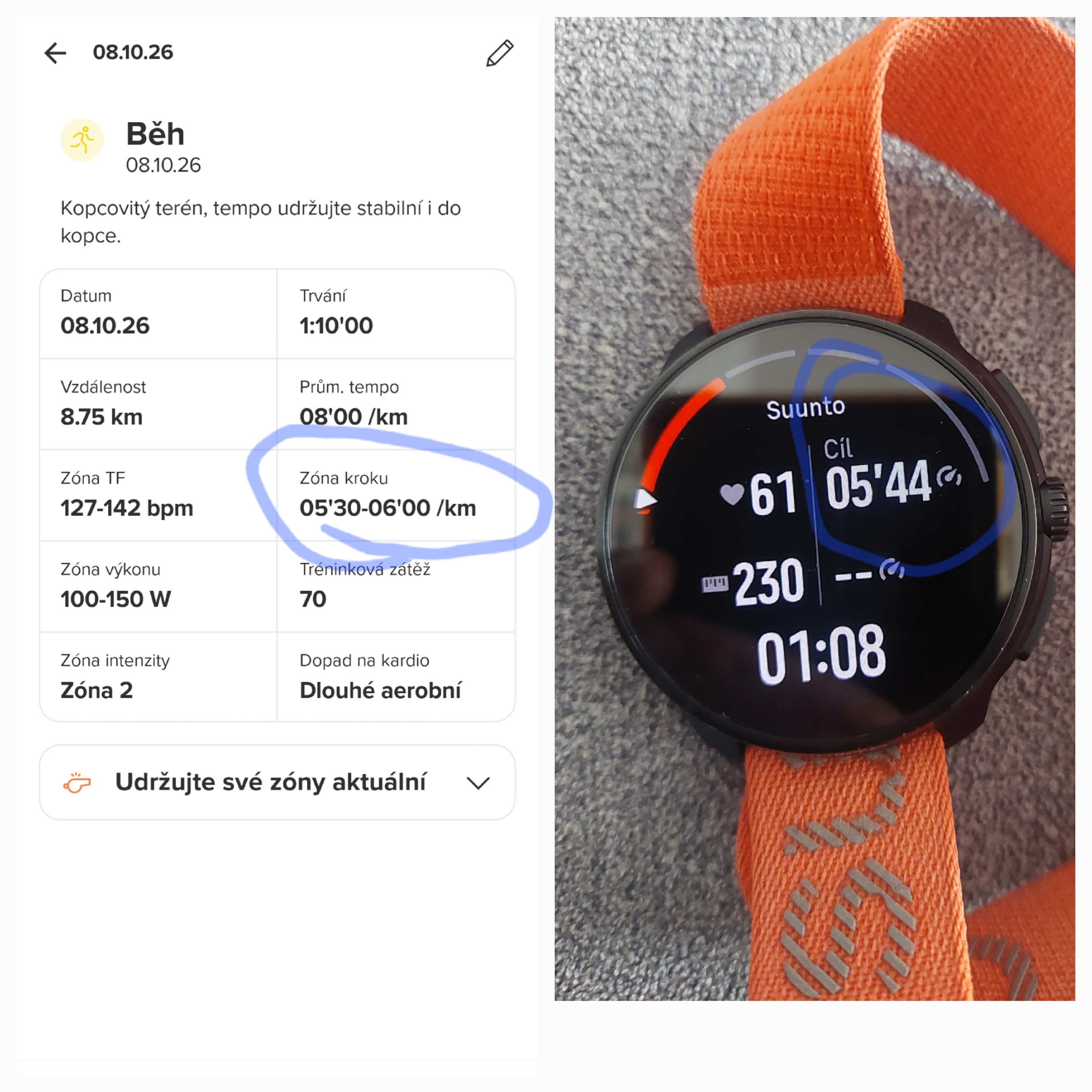

      I wanted to use the Suunto AI Coach for half Marathon prep. It creates a workout plan for me, but oddly it uses the right heart rate zones I set in the watch, but wrong pace and power zones what makes the created workouts basically useless on the watch, since the zones are wrong.
      It’s very easy to spot on plain Zone 2 workouts. My heart rate is adjusted to my individual Zone 2, yet the pace is way above my Zone 2 pace and rather a Zone 3-4 pace which obviously makes no sense.
      Any tipps how to get it right? I already tried to change all the values in the watch back and forth and also adjusted the max HR in my profile back and forth. Still the same outcome by AI coach.

        @slngr I see it too. ? Marked in blue. It’s confusing even for me. The target indicator on the watch is 5.00/km and the pace is. The indicator is green and the actual pace is + -7.00/km.1000005205.jpg

          @MarTej_cz Yes I have the same problem. Interestingly I have exactly the same Pace Zones, so it seems like it’s choosing the default pace zone value the watch ships with…
          Yet at least your power zones seem to be adjusted. Mine also has power zones from 300-330 W which is just bollox.
