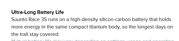

                      • EgikaE Online
                        Egika Platinum Member @Steven Hambleton
                        @Steven-Hambleton said:
                        @snow The Race 3S is Lithium-Ion according to the Suunto website.
                        I see this on the product website:
                        But anyway, I am looking not at the tech, but at the numbers. What we see here is 38h in multiband GNSS and 45h in singel band.
