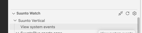

        @Woodster Hi, how did you get the logs? I’m looking a way to connect to my ocean watch internals.
        W 1 Reply Last reply Reply Quote 1
        • W Offline
          Woodster @koiraloko
          @koiraloko in VSCode using the SuuntoPlus Editor Extension:
          Then you click once on “View System Events”
