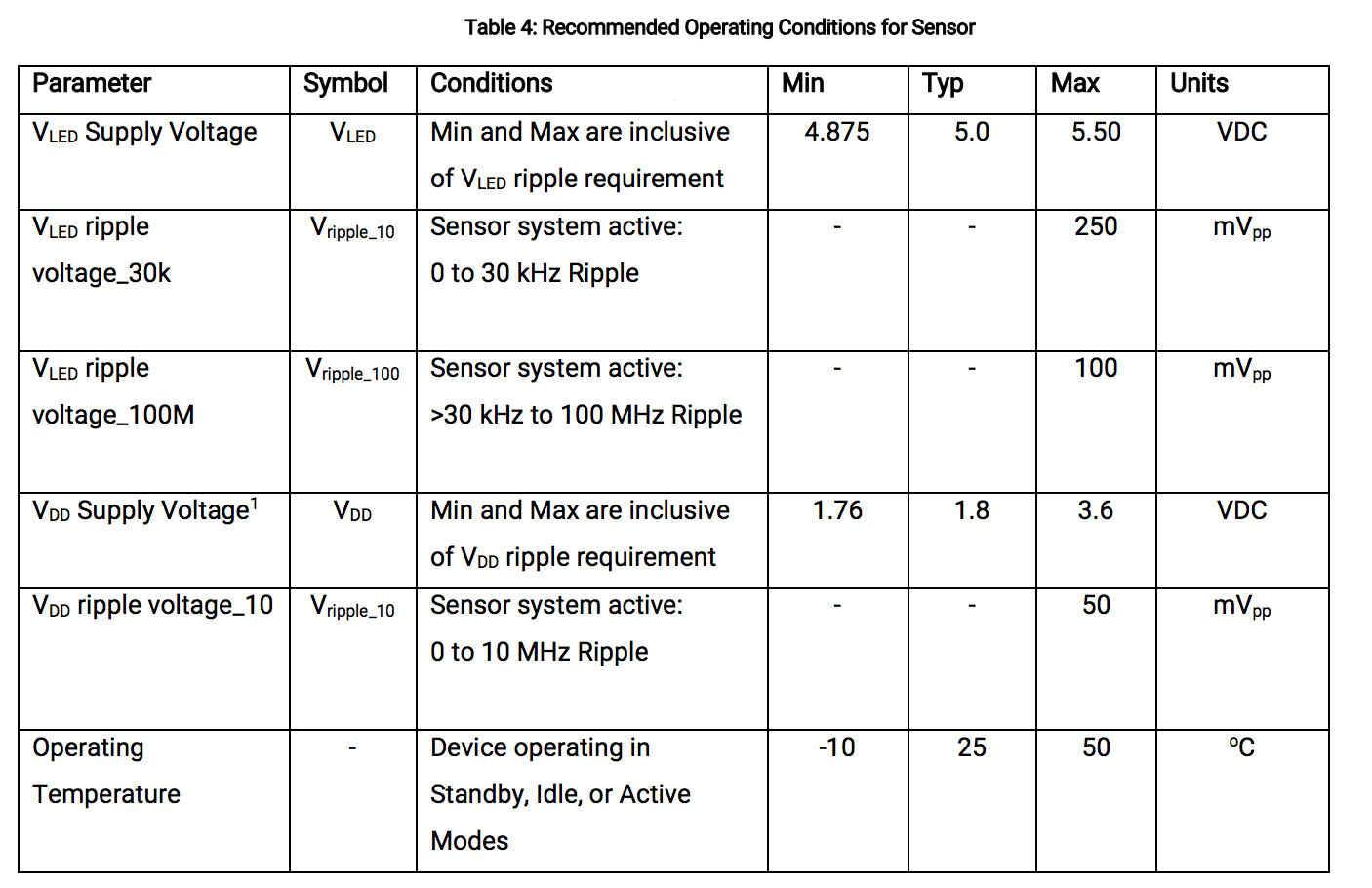

        Also from the technical sheet bw2.0

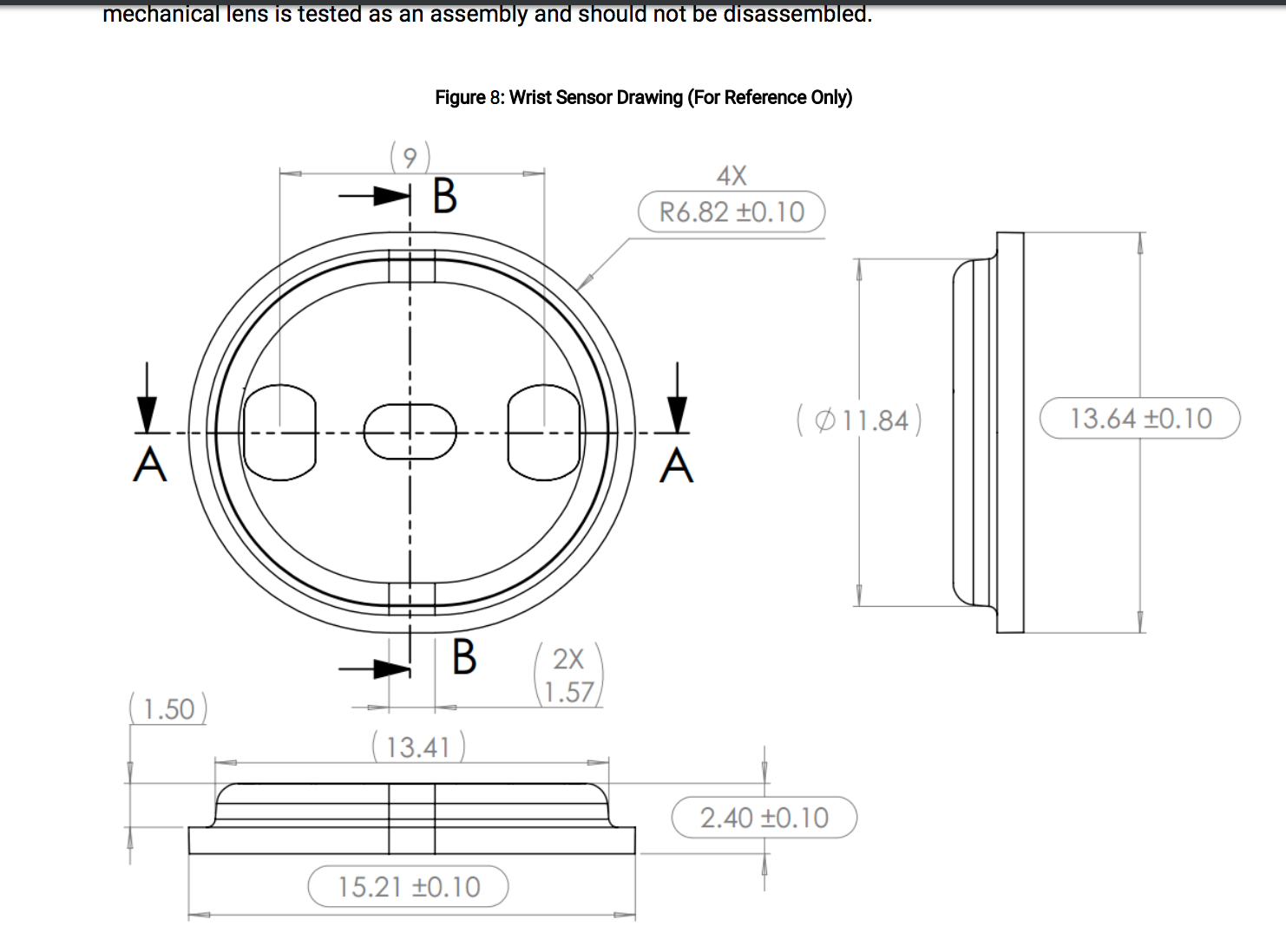

            SlaSh Platinum Member @Dimitrios Kanellopoulos
            @dimitrios-kanellopoulos this drawing that you have provided shows 2 leds + optical sensor 🙂

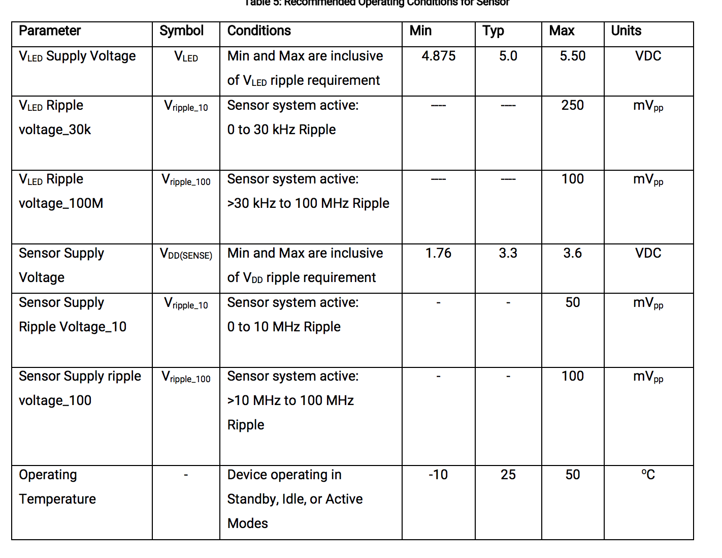

              Taking a look at the specs:
              BW2.0
              BW1.2
              I dont see anything specific to the led sensors count.
              Correct me or help me to understand (before suunto replies)

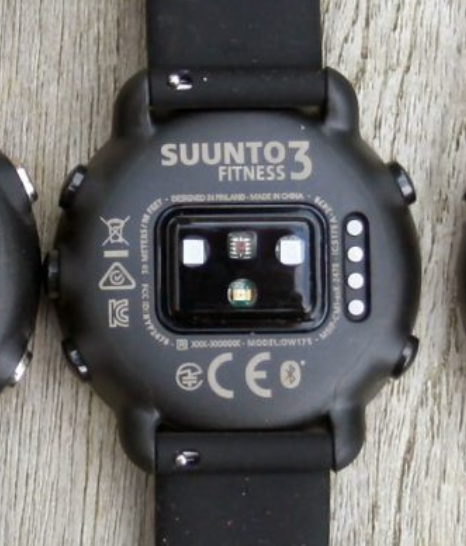

                  Btw take a look at this:
                  What do you make out (I am not expert here) and I more will trust you @slashas rather than 5K runner etc.
                  • SlaShS Offline
                    @dimitrios-kanellopoulos looks like BW1.2 by shape, led placement 2 green, 1 yellow, optical sensor. Looks exactly the same as on my baro 🙂 this is just speculations, to confirm that I need FW 🙂
                      @slashas said in Suunto 3 Fitness Thoughts:
                      I am with you on this one.
                      But as you I am also trying to understand.

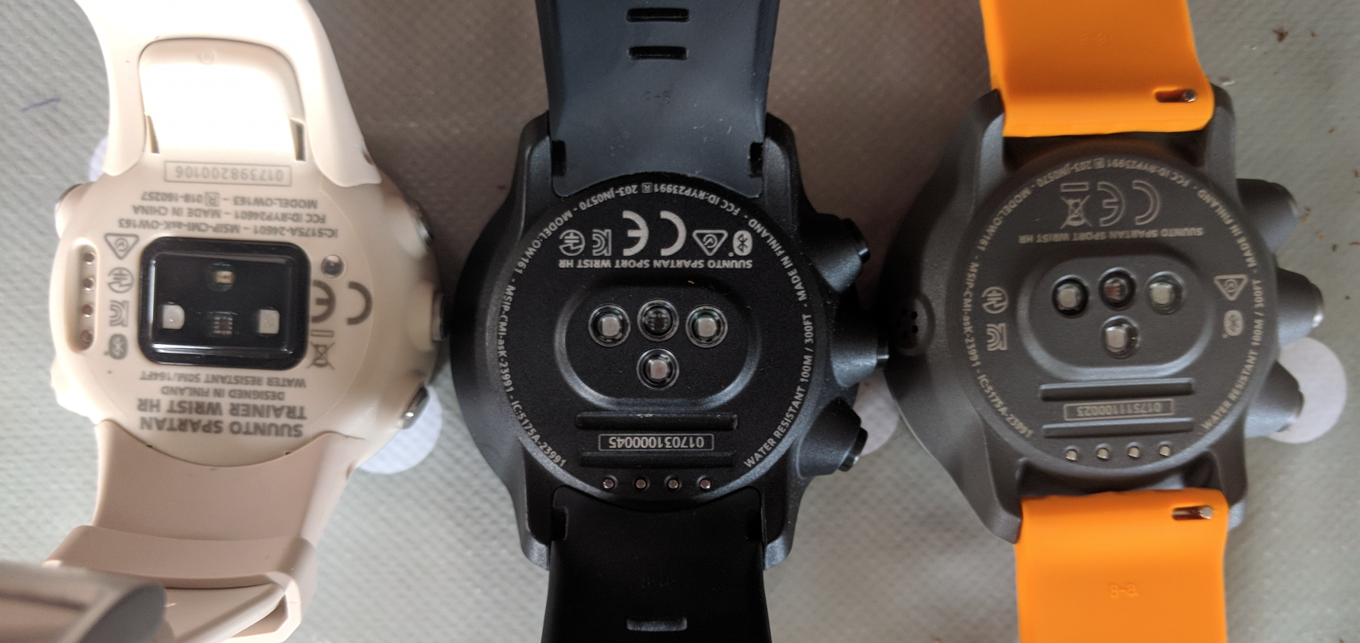

                      Take a look here:
                      Left is the trainer and then it’s SSSWHR and Baro. The SSWHR and Baro have a different component.
                      NicolasPN SlaShS 2 Replies Last reply Reply Quote 0
