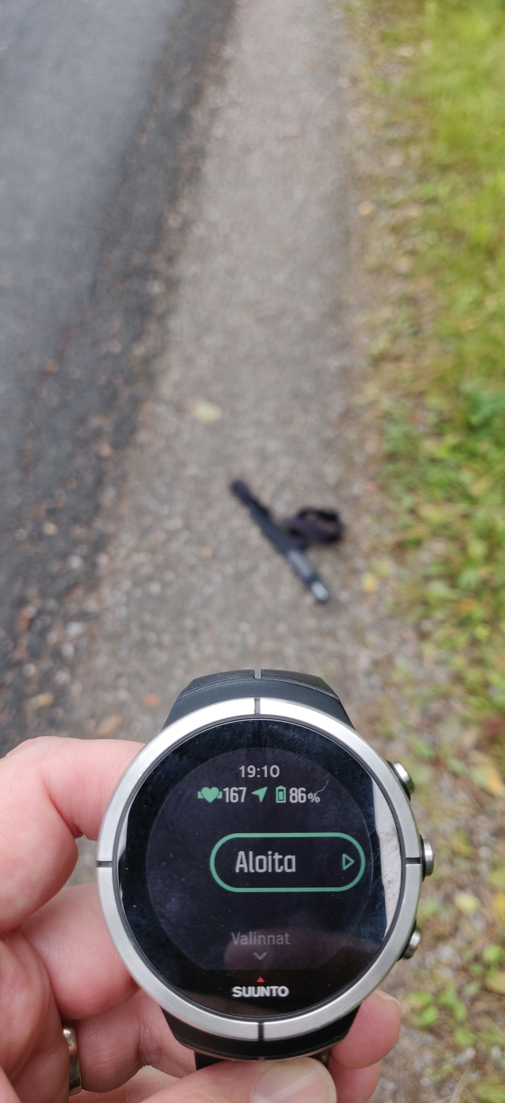

                  I did change the battery and clean the Suunto HR belt. The end result of that was a short hike yesterday when HR monitor didn´t wake up at all, well I didn´t mind because the point was to relax.
                  This evening I went running and ended up having 6 exercises - first 4 the HR didn´t start to track at sports mode even though watch found HR and displayed the correct value in sports mode landing/start up screen or it did start to track after a while but bpm was +200 all the time, maximum logged was 228 BPM which is kinda high, even when I stood still.
                  The 5th iteration of my running went real nice from the HR point of view although I was getting so fed up with the watch that probably my heart rate was couple of beats too high 😄 But then again cruising at very steady and easy aerobic pace it suddenly jumped after 3.5 km again from 120 BPM to 175 bpm and stayed there. Wish me luck that I´m not dying, I´ll forgive you Suunto in that case, you were just trying to warn me. I did count the approx HR from my wrist the old school way, I´d say it was 120-130 BPM. 6th “lap” was realistic from start to finish, the last two kilometers. Awesome exercise to push into stats, this one.
                  I sure hope Polar will do the trick then for me as well, I know they´re way more respected in HR tracking here in Finland among the athletes.
                  And finally I have to share my favourite part of todays jogging - I removed the HR belt during the 3rd episode and throw it to the ground. Then I selected the running sports mode again, I was standing maybe 1,5 m from the belt. The sports mode start up screen found the GPS 1st and after that the HR belt and kept tracking the HR still while I gently kept taking few steps back and forth, BPM quietly bouncing between 165-167. Weird stuff right? Considering that this setup worked again 20 min later it makes you wonder that it´s hard to engineer anything this random even if you´d try?
