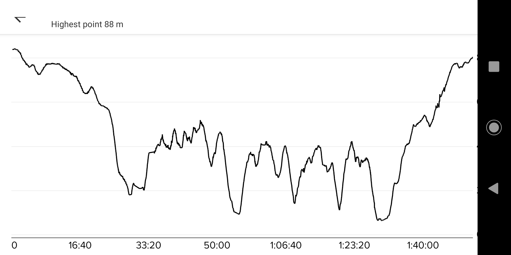

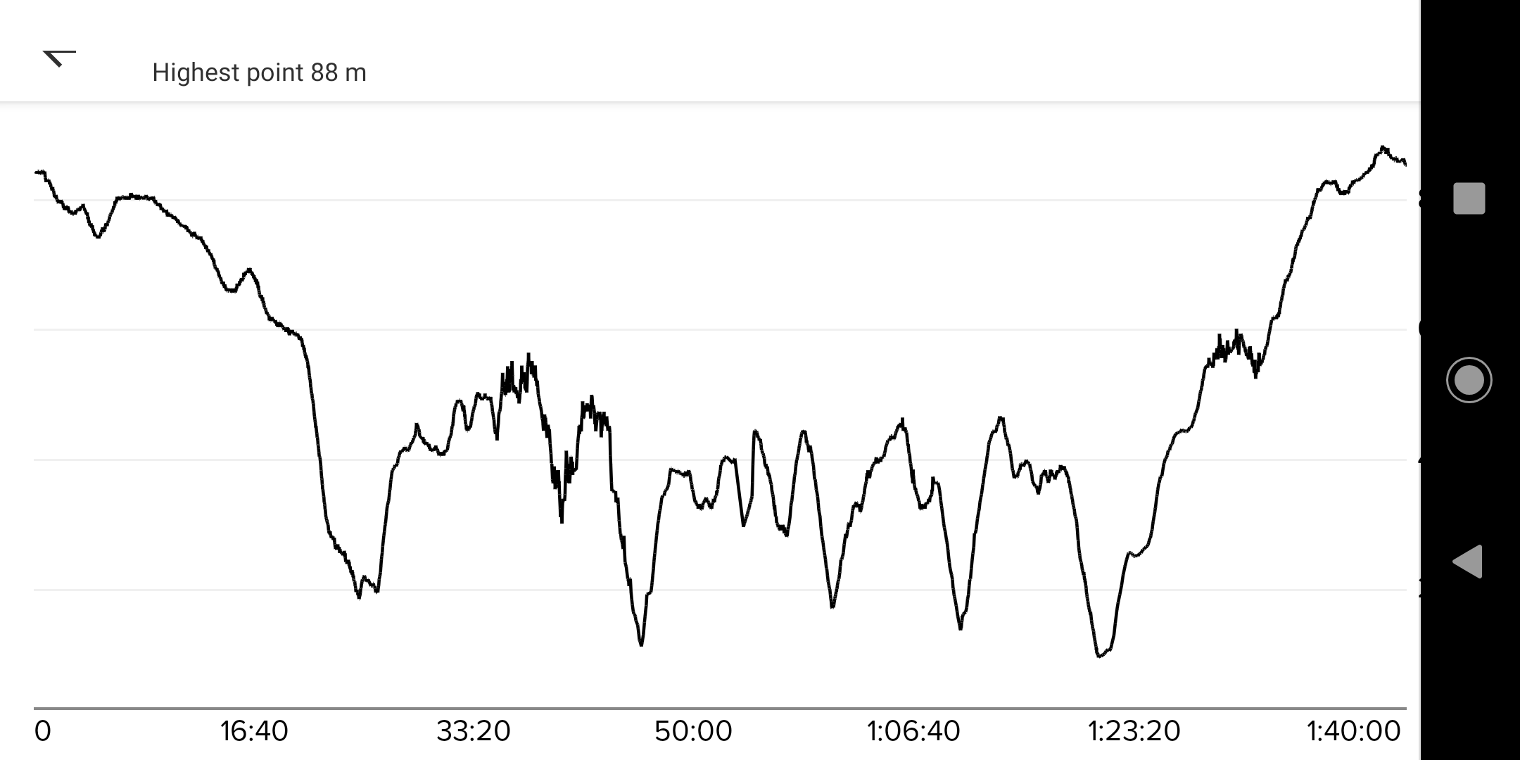

first pic is with total ascent of 240m.
second pic is with total ascent of 286m. exactly the same trail but the 2nd day with some “noise” in the recording. I assume day 1 was right and day 2 with the noises, something went wrong. it your case it must be vice versa…
