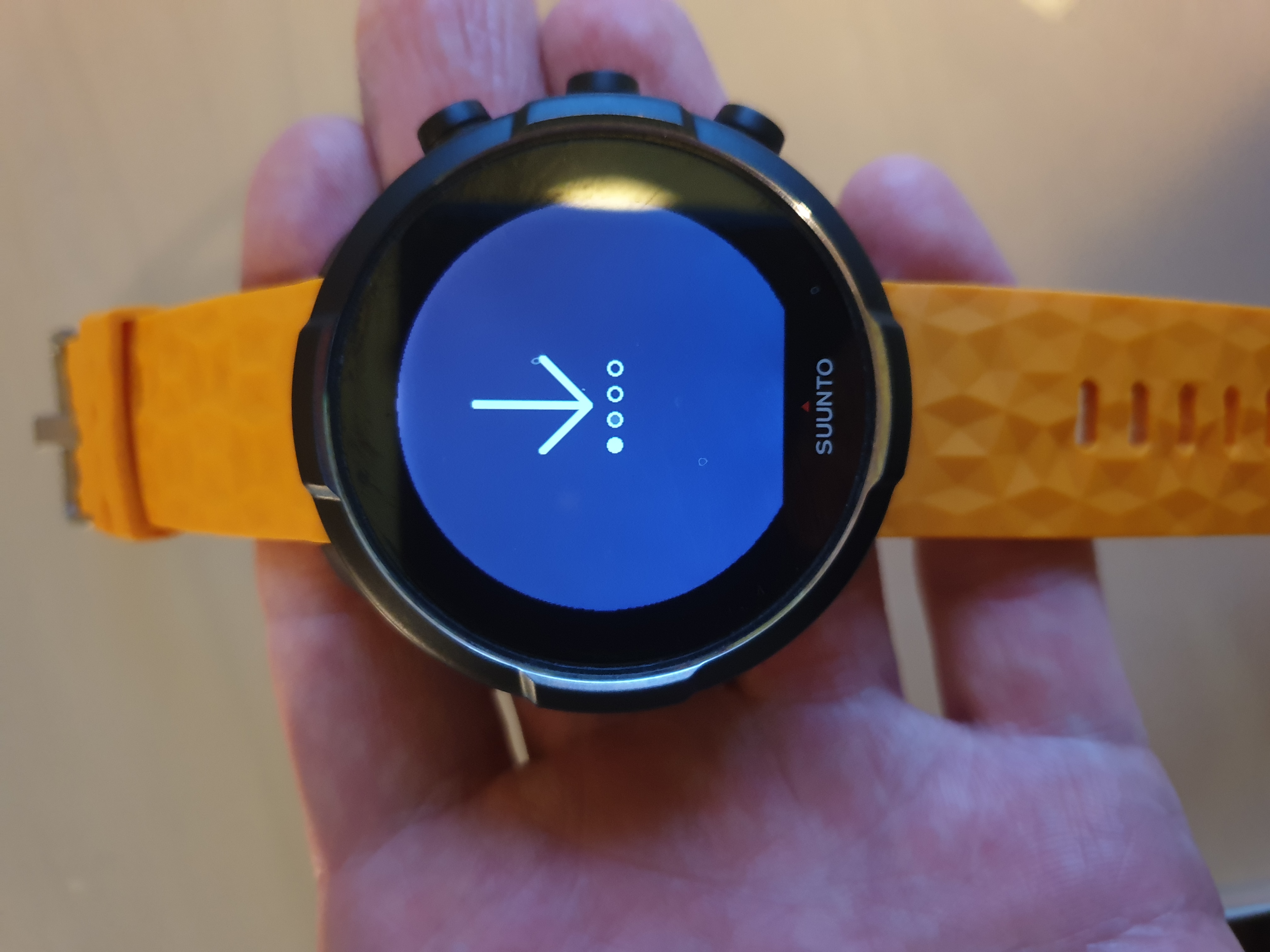

      Help ! My new Suunto 5 is taking forever to save an exercise. And now the face is simply showing a downward arrow towards four dots of which the second one is blinking ! I tried customer service but no one is picking up !
      • Cornell TsiangC Offline
        Cornell Tsiang
        Oh, just realized the arrow meant I had to do a reset. Lost all my data. Thanks Suunto 😞

            @Cornell-Tsiang Did you connect via Suuntolink and made the update? Arrow with the dots on the screens means a watch update is in progress. Not a reset.

              I have exactly the same problem occasionally. Happened to me aprox 15 times. First time on 28.10.2019. I have suunto 9. I have some questions for you?
              Do you use movescount and suunto app pararell?

                  @zvonejan You mean you got this issue 15 times in 2 months? And after you saw this icon you reflashed the firmware?
                  If the issue is coming back so soon I suspect there is something wrong with the flash memory of the watch. I suggest you call/mail Suunto Support.

                    Yes. 15 times in 2 months .First 10 months never. I reflashed watch only first time. Now i have work around to push upper button for 12 second. I think it is not the watch.
                    I do not wear watch all the time. Happens to me in this situations:
                    1. When i came home and when i wake up the watch. Watch face showed up and then arrow (3-5 times)
                    2. When i turn on the phone (3 times)
                    3. When i turned Bluetooth on on the phone (3 times)
                    3 Randomlly
                    4 Once durring actvity on bike. When i turned on phone, arrow showed up. That really pissed me off.

                      So you are the first one that has the new Firmware OTA feature that everybody wants 😉
                      If I read the history in your post it basicly shows the issue during watch/phone sync. My feeling is that random is not so random, but just the sync interval.
                      Maybe @Dimitrios-Kanellopoulos knows what kind of data is send to the watch if the sync starts and why the watch thinks it is downloading new firmware.

                            @zvonejan this article is suggesting that using both Movescount and Suunto App can cause this behaviour:
                            https://www.reddit.com/r/Suunto/comments/a88czx/spartan_sport_whr_keeps_going_into_boot_modedown/
                            You use them both?

                              Thank you wery much 🙂 . Yes i use both app. And my problem is described in that article. So I will disconnect suunto app and problem will be solved. Thank you again and good day to all
