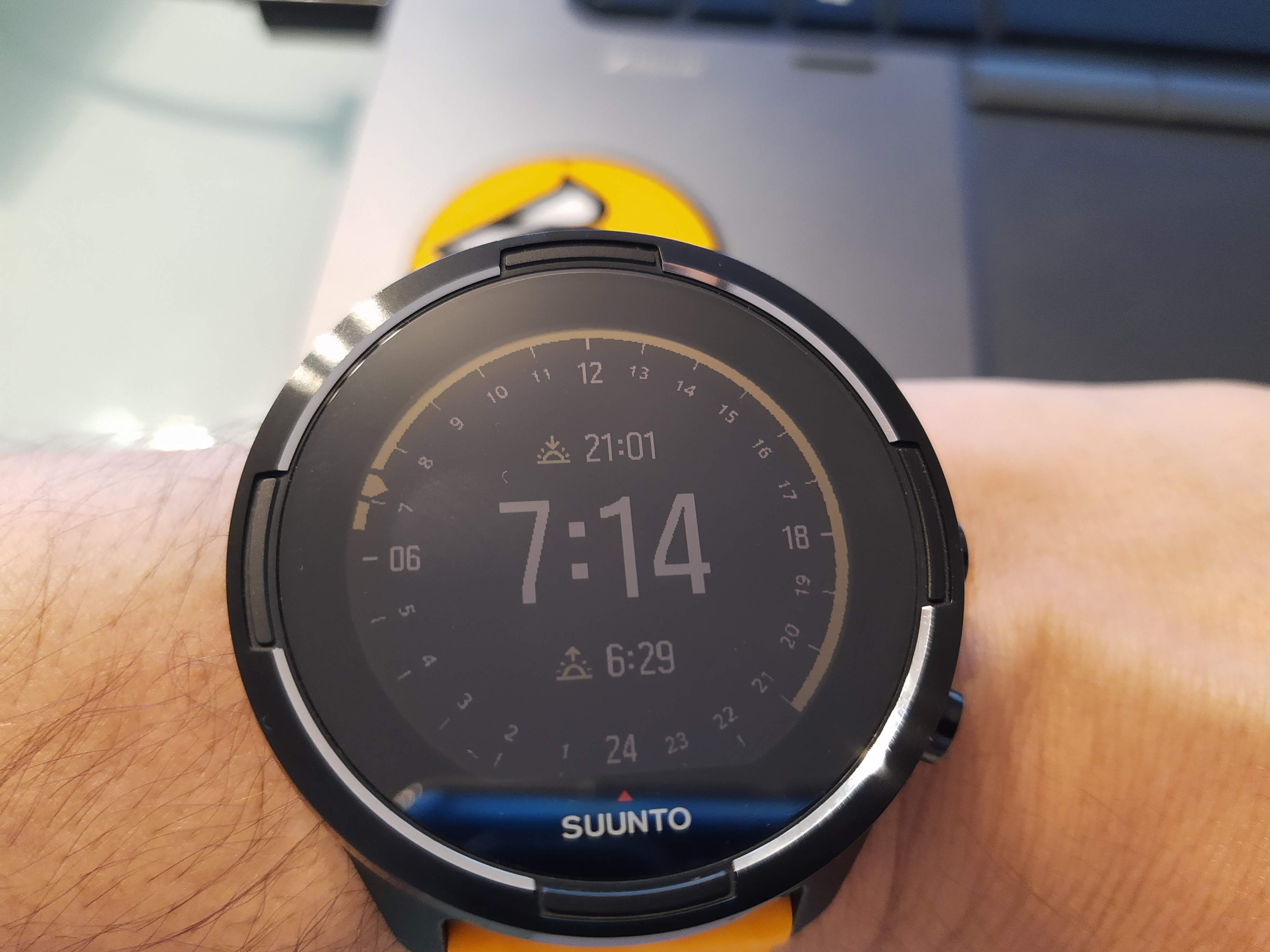

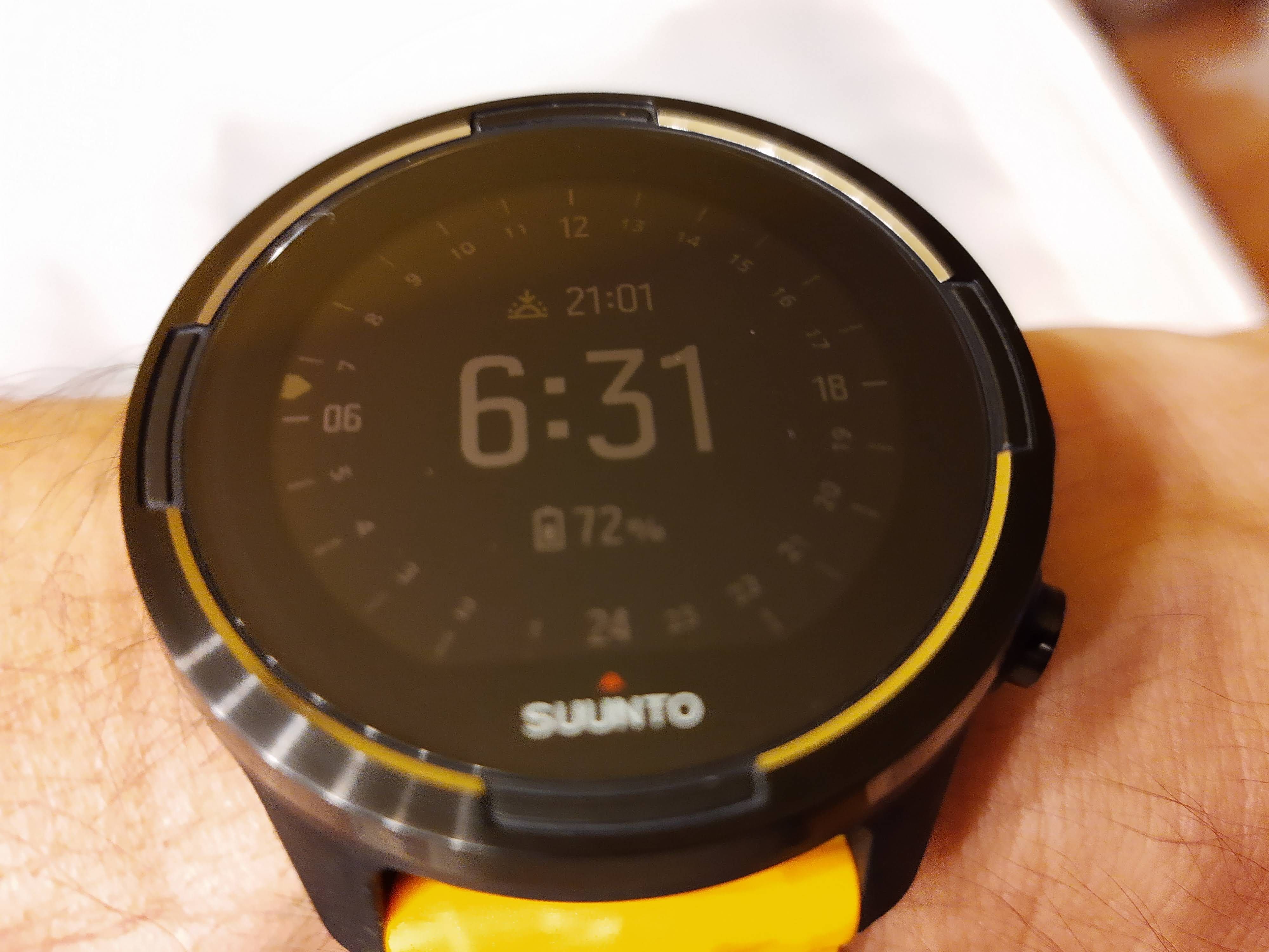

      I think I found a small bug in this firmware version, at least for the S9.
      I always use the watch face that you can see in the pictures. Today has been the second time with this firmware version that I’ve lost the outer ring indicating the daily and nightly periods. As the first time I only recover the ring doing a soft reset, reloading the watch face or changing it for another one and then switching back has not recovered the ring, only the soft reset.
      I have been using this watch face for over 2 years, with the SSU and with the S9B and only have face this with this version of firmware.
      Maybe it is me, but I also have the feeling that this firmware has made the watch slower too.
      EgikaE Brad_OlwinB 2 Replies Last reply Reply Quote 2

          I know this, as I have said I’ve been using this watch face for almost 2 years now. Besides, photo at 6:31 is just after getting GPS lock, then playing a little bit with the watch faces and later the soft reset, even more yesterday I did two activities with GPS. As I said the problem has happened to me twice with this firmware and never with the previous, not in the S9 nor with the SSU.
