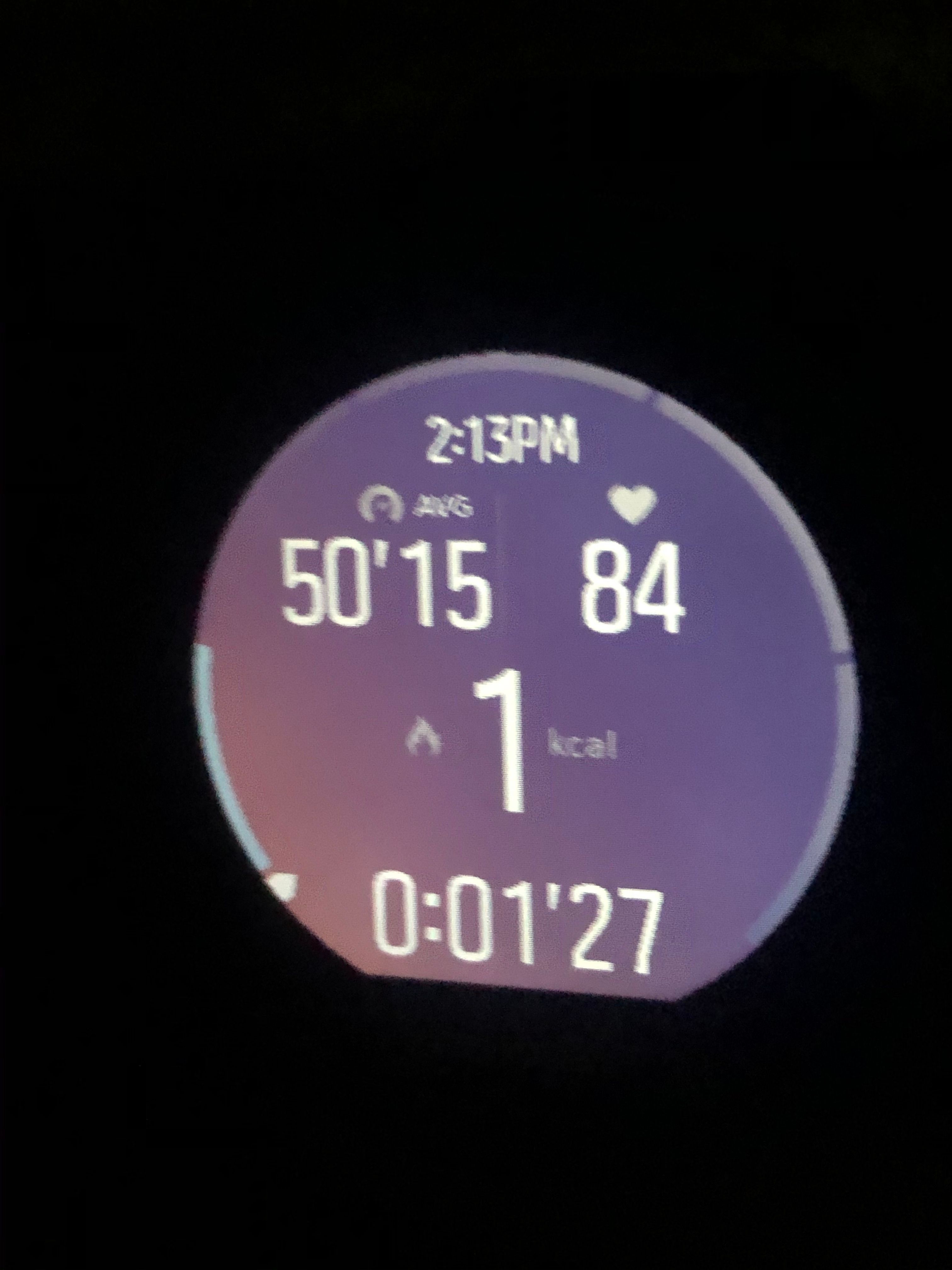

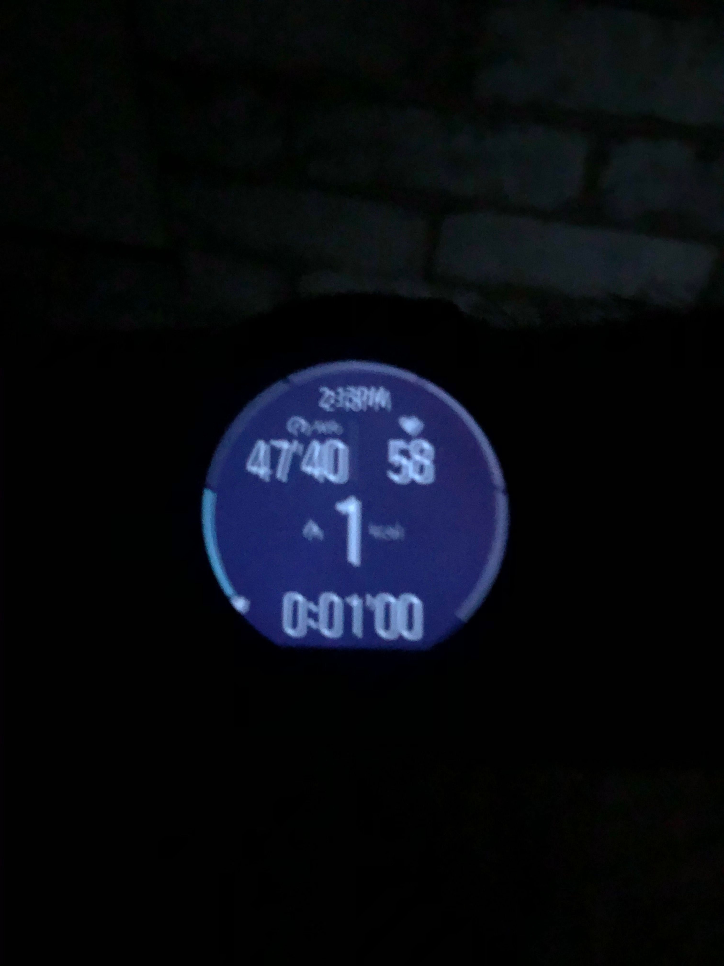

        1. This doesn’t work for me. Not in custom or predefined mode. I suggested something like that, for example - holding the middle button for 2 seconds to turn the light on. When you mention long press. Anything shorter than entering the settings menu does not turn light on.
          I can go into settings with long middle button press - scroll to Backlight - ON, but I cannot do that while I am running and in the dark.
        2. I don’t know, for me it doesn’t count calories. I guess you have chest belt on, not OHR.
        3. Yes, I remember that from manual so I use mostly my profiles. “…you can set up a custom mode with touch screen enabled and then the touch will activate the light.” YES I KNOW THAT, and THAT worked on earlier firmware. The touch works, but light no. The battery is the reason why it is off, I already complained about battery life. Why would I use 1 hour of battery for light if I will be looking at watch for a minute or two during that one hour total. Usually when I start the exercise there is a sun and it gets darker (or dark) towards the finish of it.
        4. Polar works well in sun or night, under candle light you can read the values:) I know, different displays and there’s nothing I can do. I can try to leave it on, but light must consume the largest percentage of battery use during normal standby…and I don’t want it to be turned on when I go to sleep.
        I don’t know, I will try hard reset once more. I did it last week, just before the latest firmware came out, because it froze for the second time since purchase, black screen, buttons presses did nothing.

              • Cuba1hrC Offline
                Cuba1hr
                OK, battery, fusedtrack and other innovations are great but those are some almost basic functions I mentioned.
                I mean the whole left side (except baro sensor) is empty, there should have been a dedicated light button.
                I was using H7 and no calories, I don’t have Suunto’s sensors to test.
                I just did the hard reset and I will let you know tommorow if that helped.
                • 4-5 profiles setting up every few weeks now. I wish Suunto uploads my profiles (once again like Polar does) so they just sync with the app…just took screenshots of every custom activity.
                  @inkognito
                  Yes, I know that. I will see what will happen when I set everything up and I also hope it will start to show calories after reset.
                  Thanks everyone for answers.

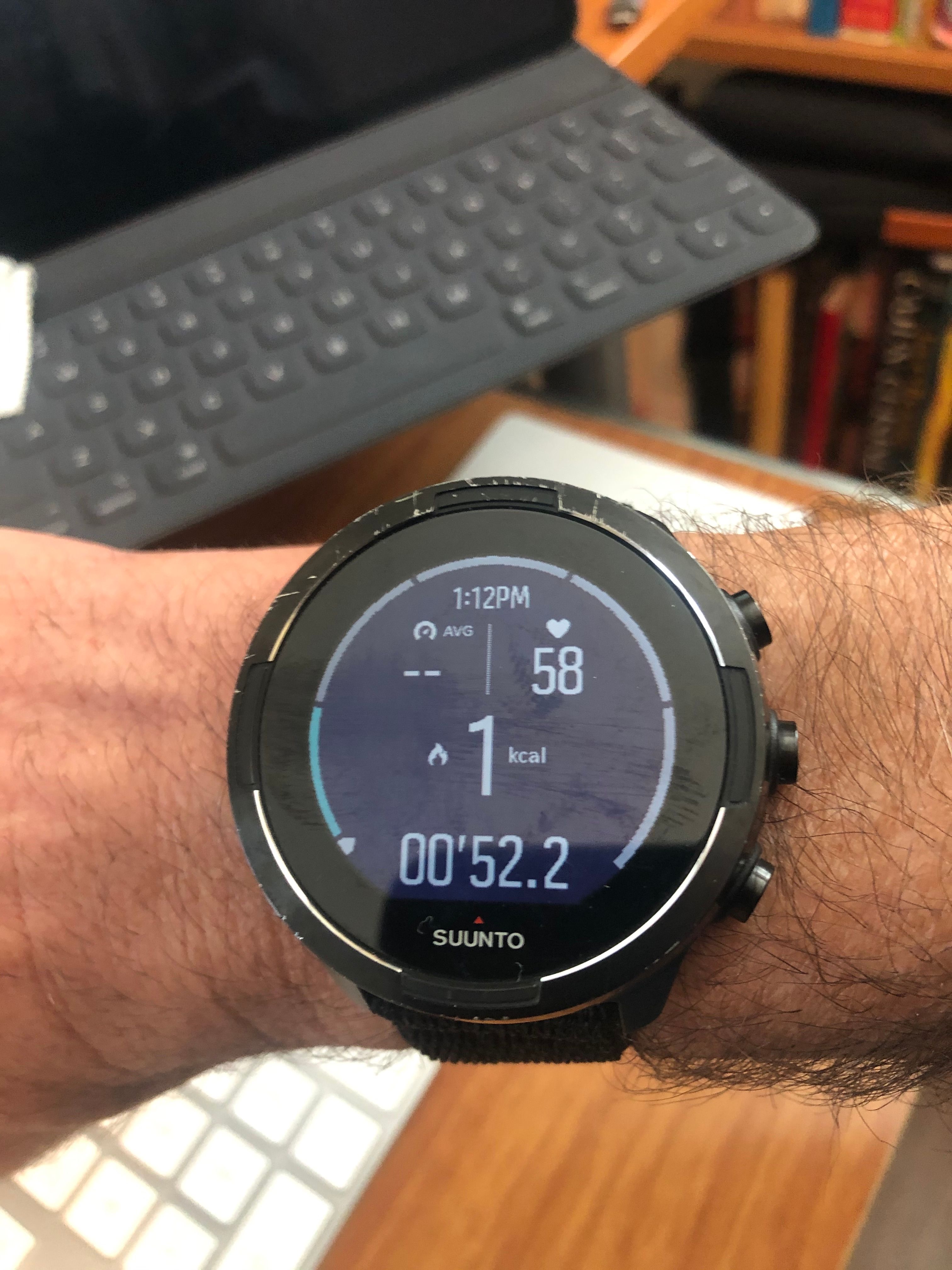

                  Brad_Olwin Moderator @Cuba1hr
                  @Cuba1hr
                  Just tested, Custom sport mode with custom battery, touch screen enabled, backlight normal, standby on.
                  Start exercise, light is off.
                  Blurry because it is dark, only standby
                  Now I simply tap the screen and Voila, light is on.
                  This is working as expected.

                    • Cuba1hrC Offline
                      Cuba1hr
                      Understood, but I try to get to like this watch and it surprises me unexpectedly every once in a while.
                      I wanted to explain and say everything so you could understand better all the details.
                      I will try to behave myself:) Moderator can modify the title if it is too harsh.
                      Also nobody commented restart after selecting SuuntoPlus or heartrate detected on black piece of rubber. Just saying.
                      I will get back with the news tomorrow, time for bed.
                      EDIT:
                      I couldn’t wait. Set up everything now and after hard reset earlier mentioned things work.
                      1. Backlight works as it is supposed to, as Suunto imagined and like is described in manual
                      2. The calories count with bluetooth sensor now works, in custom Indoor cycling. It is kind of slow in change, somehow like the number does not change in same time intervals (my impression), but it works. On Polar that counting is smoother. I still have to compare difference between calories from the same sensor at the same time on S9 vs V800. Last time there was a big difference in active calories (about 150 from earlier post) during 47 minutes activity. Still don’t know why.
                      3. OK
                      4. Nothing can be done, but I have backlight on tap again. I am wondering if there is a noticeable difference in low light screen visibility between sapphire and mineral glass version of watches (S9 vs S5)
                      …maybe I found the answer about screen on, not so good, latest review of Suunto 5 from official Suunto site:
                      " This review is from Suunto 5 White
                      TERRIBLE!!
                      Very poor product! The watch screen is pathetic. You cannot see it while running and it is unreadable on tree covered trails. The heart rate readings are all over the place and the GPS is constantly disconnecting. Overall a Terrible product… Sunto is very poor company."
                      Even I, with all my complaints gave 3 stars, more than this guy, but for S9B. Unfortunately it was removed after few days.
                      Some of things since then improved, some are still missing and still hoping for.
