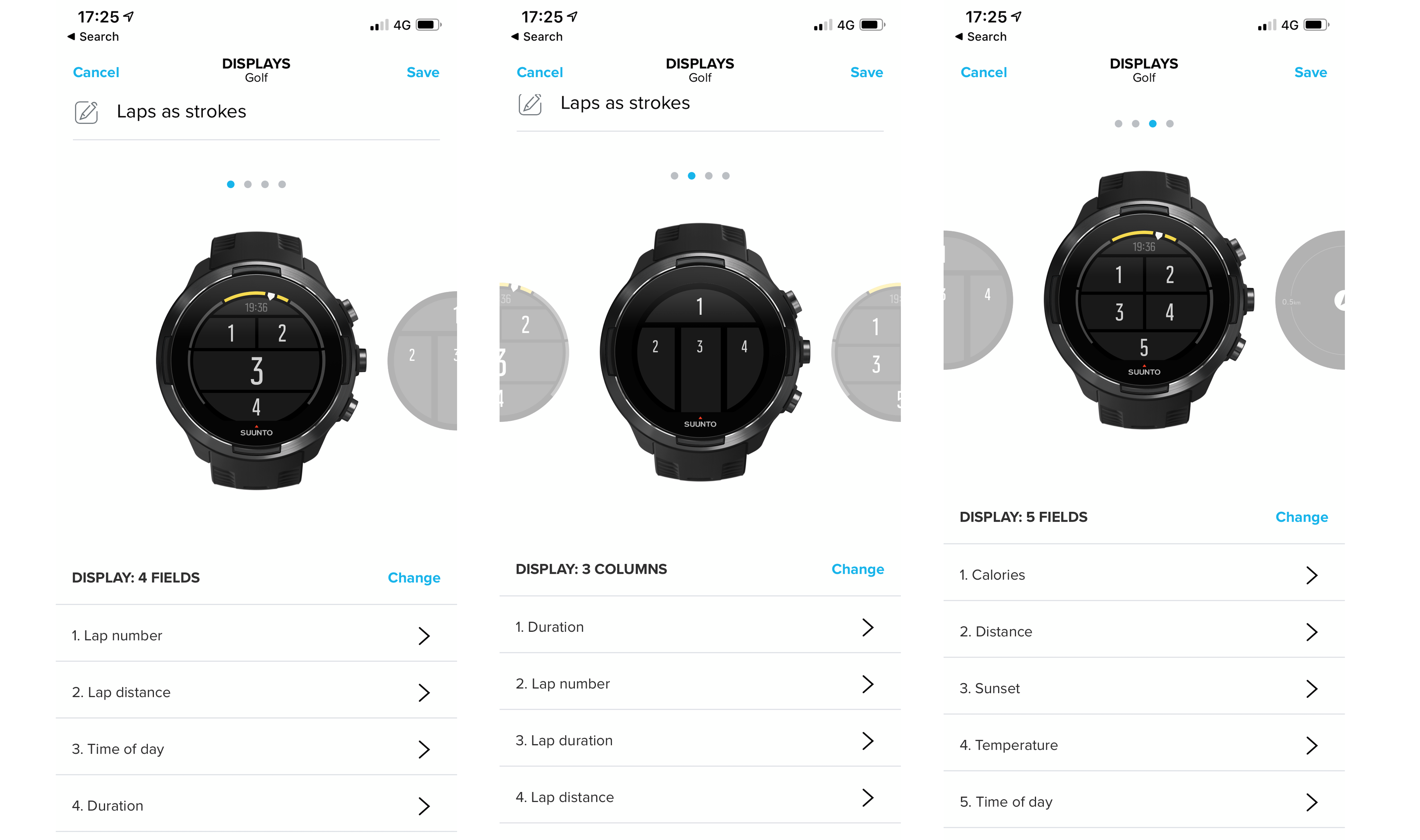

                In case anyone is interested, these are my settings for the golf mode I had created (Suunto 9 Baro). It is basic but works well.
                You will see that I actually added the “Time of Day” on some screens. I just want to have a larger time indicator since especially on week-ends there are lots of people on the golf course, and time is of essence. So when taking a quick look at the watch, the larger numbers are obviously easier to read.
                Also, in strong sunlight, the tiny “time” indicator at the very top of the screen is really difficult to read.
