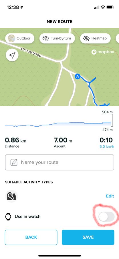

                                @mff73Hello again,
                                This weekend I tried what we talked about.
                                Here’s what happens when your phone is out of range:
                                The information really enters via Bluetooth in the phone, but it gives me no connection to the Internet and offline, the buttons for recording and transferring the route are missing - I am attaching photos:
                                and here the route does not exist at all:
                                now I am attaching photos after internet connection:
                                So, the answer to the question is that with a phone without internet it is not possible to use routes that are currently created by the watch … which makes Suunto completely dependent on the phone, and hence makes many accents that the new Suunto is famous for meaningless, like long battery life - what about the phone battery if with short life ??? And the main accent of Suunto is that it is GPS navigation 🙂 which you can’t use without a phone, etc …
                                SUUNTO 9 BARO TITANIUM & SUUMNTO AMBIT 2 SAPPHIRE
                                Mff73M sartoricS David YoungD 3 Replies Last reply Reply Quote 2
                                • Mff73M Offline
                                  Mff73 @nikshot
                                  @nikshot
                                  i have tried it before answering you 😉
                                  have you put your phone on airplane mode to do this test ? if yes, you need to enable bluetooth for sure 😉
                                  no internet doesn’t mean no wireless communication to watch 🙂
                                  the phone doesn’t need to be connected to internet but the watch need to be connected (linked) to the phone.

                                    • N Offline
                                      nikshot @nikshot
                                      @nikshotAs I wrote above, the watch has a connection to the phone, it even transmits the information, but until then … you need the Internet for the reverse!
                                      Mff73M 2 Replies Last reply Reply Quote 0
                                      • Mff73M Offline
                                        Mff73 @nikshot
                                        @nikshot
                                        ok, so maybe an iOS thing : it is working right now for me on Android.

                                          sartoric Moderator @nikshot
                                          @nikshot said in Transfer routes from logbook to navigation?:
                                          Is the toggle active (clickable) ?
                                          Because when you create the route, the toggle is always “off”.
                                          If the watch is connected there no reason why the route cannot be exported/saved … except a bug of course 😁

                                          • Mff73M Offline
                                            Mff73 @nikshot
                                            @nikshot
                                            On Android, when watch is well connected, the watch icon is ticked
                                            Your screenshots show a dash. Maybe iOS really needs Internet to connect to watch. Which for sure will be very bad for you 😔
