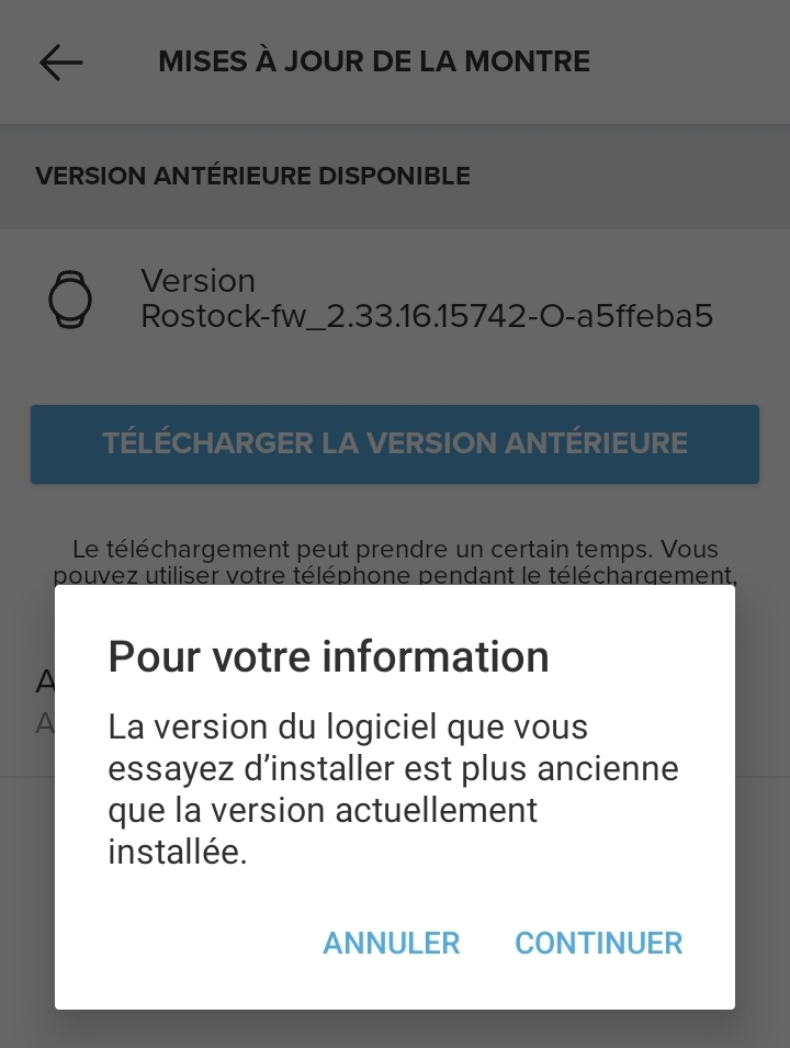

          @Mff73 thanks for your reply. Yeah, figured it out now. Does not work on android but on the iphone it works.
          I tried the following on my Vertical Solar:
          com.sports-tracker.suunto://ota/ota-fw/Rostock-fw_2.33.16.15742-O-a5ffeba5.sof
          Unfortunately, it does not install.
          Are you aware of any 2.33.16 fw for the VS?
          Thanks.

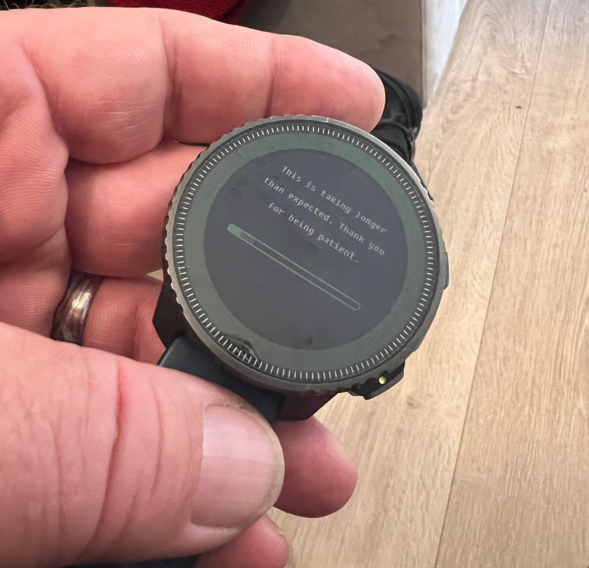

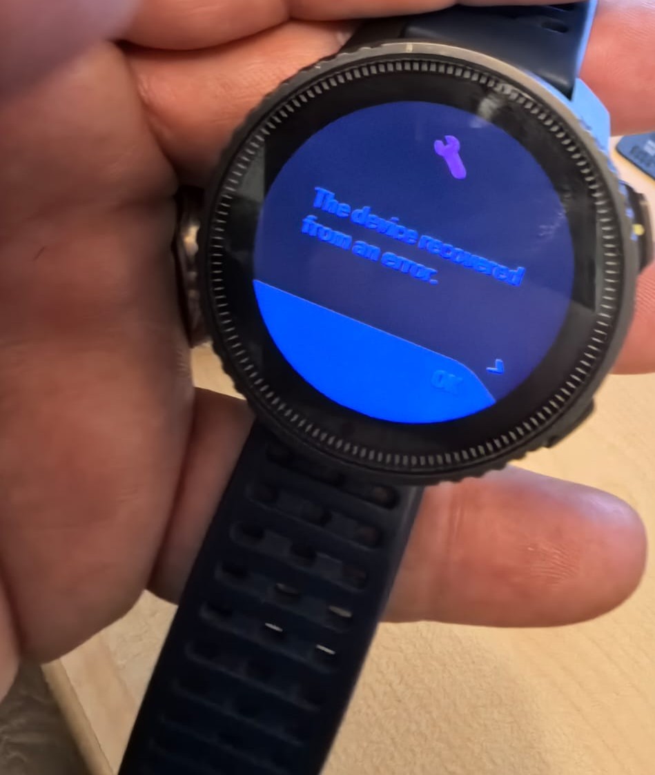

              @Mff73 Thanks. It fails to install on the watch.
              When you install it it kinda loops here:1.jpeg
              Then it recovers from error:2.jpeg

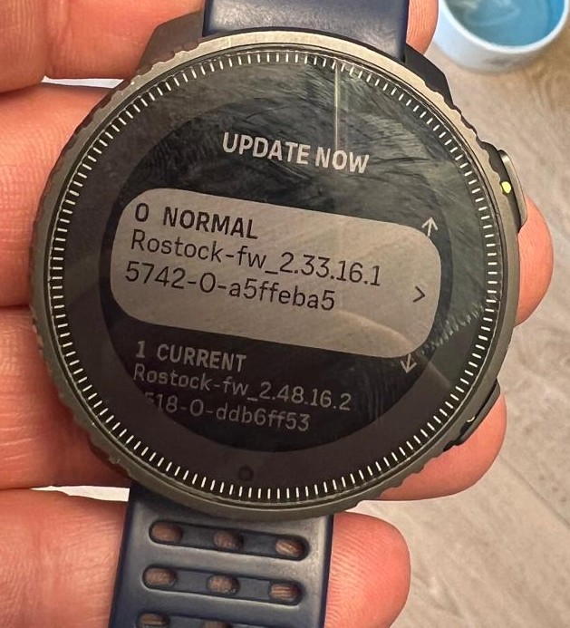

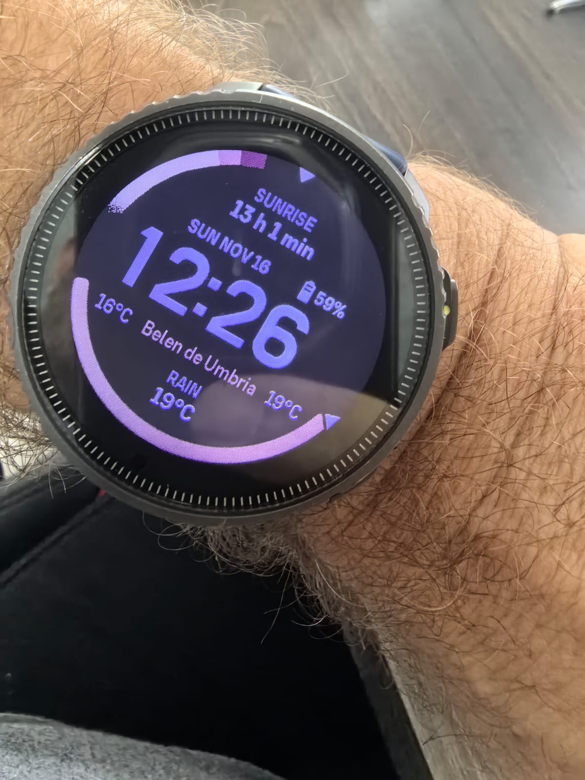

                    @Mff73 I think the solar charging stop working. Perhaps, that got something to do with it. That is also the reason I updated to the latest firmware to see if it makes a difference, unfortunately, not.
                    While I use the Vertical for daily hiking and other sports, I do like the original Vertical watch face. Plus, on a day to day basis, you can tap and scroll through the complications, which I like. And most importantly, it just works.
                    If you look at the current watch face, apparently, sunrise is in 13h 1min. But it actually was 7hours ago. Sunset is wrong too. I also tried to customize it, very limited options. So, as we say here, “peila”
                    Suunto really cured me from wanting or having the latest and greatest fw. With automatic update, you wake up, look at your watch, and go, wtf!
                    So, 2.33.16 it is.

                      @Norbert said in Firmware Collection:
                      Did the watch get a location fix since the update. If not. start an outdoor activity or open map widget.
                      • N Offline
                        Norbert @Squirrel
                        @Squirrel Yes, it did get an location fix, it has the location correct. Will try with a small hike later this afternoon.
