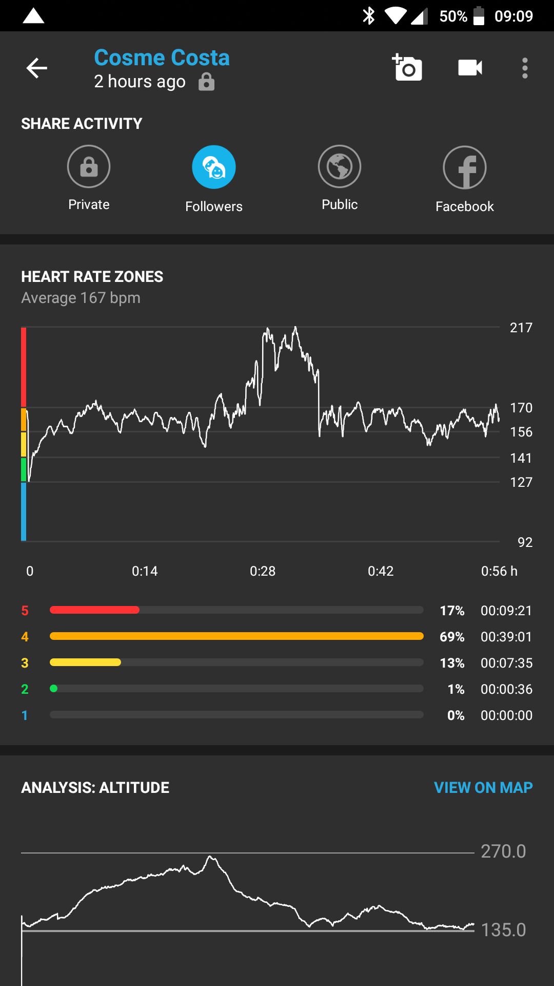

                  I have this issue too. Sometimes, at the middle of some run, the HR increases suddenly over 230/240/250 HR and after a while it drops to the correct values. It is like you add some offset to the HR data. Some times it happens even 2 or three times in a run. I thought it was related to some movement of the belt but it isn’t because I’ve tighten it till the point it has brushed my skin and some times I got the same issue. I also thought the belt was damaged, but it is quite new, from March, or even it was related to some new polyester T-shirts I bought but then it happened with the old ones which the ones I haven’t had the issue.

                            The problem is that I do not see the spikes until I finish my run. @Dimitrios-Kanellopoulos do you mean that you use saliva instead of water with the belt and the spikes are gone?
                            Before I have the SSU I had a Ambit 3 Vertical with which I never had this problem (it was more than a year and I only changed the battery after 11 months). I have to say that the strap with the Vertical looked better than the one in the SSU with half of its life, for that reason, yesterday I ordered a new strap.
                            Here, you can see one of the spikes that I’m talking about, is from today’s run. This one has a spike (high area) that arribes to 217 bpm but other times has arrived to near 240 or even more. This only happens from time to time but lately is happening more often.

                                @cosmecosta yeah when the issue appear on watch then I correct it on the fly.
