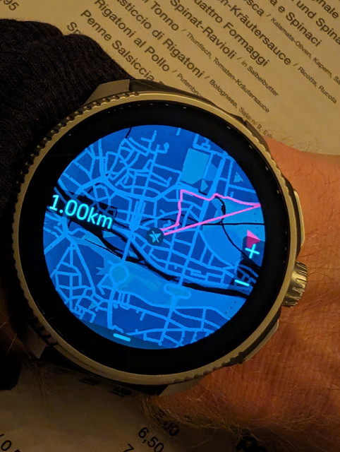

      I just noticed something rather strange.
      When pausing an activity and choosing to view the map in the pause menu, the red trace showing your route so far is a closed loop with a straight red line going directly back to the starting point…
      Does anyone know why? And what this is supposed to indicate?
      …or… did I find a bug? 🤣

        Because you are in a building, the gps signal is lost, so the map shows wrong information.
        If you are outside of building and pause it, it probably not show such line.

          @Olaf-Gottschalk Exactly as it would be in Garmin, Polar, Coros, if you pause an activity but keep moving, the watch isnt recieving any GPS or other information. There could be a reason people want to do this, and/or people could have paused to tie a shoe and forget to restart it, and then when they realize they need to resume, OR dont realize until the end and just hit finish, it will calculate a straight line + distance between the 2 points (pause and resume/end), essentially filling in the gap.
          I believe this is preferred over showing no data or a gap (which they used to do), and helps if you did indeed make a mistake and want to backtrack or navigate?
          Or maybe in your case when paused you had back to start engaged.

            @Olaf-Gottschalk on the picture you’ve taken are you inside à building ? Seems that you don’t have gps signal so it is related => Having no signal the Watch then drag a line from last known point to start point until you get signal again

              @Tieutieu your answer seems right. But… Why??
              I paused the activity so no matter if I have GPS or not, what does the line back mean?!
              I did not take that route nor am I interested in a line to the start. What’s the real thinking behind a line being drawn?

                @Olaf-Gottschalk its connecting the last known position to your current position as typicall happens to all GPS tracks services etc.

                  @Dimitrios-Kanellopoulos yes but in that context, in a building without GPS, the “current location” is where?
                  This is a different statement than others said that it would connect the last known location back to the start for whatever reason… 🤔
                  At least to me it does not look deliberate, more like a glitch.

                    @Olaf-Gottschalk because it got GPS inside the building most probably for a second and so on.
