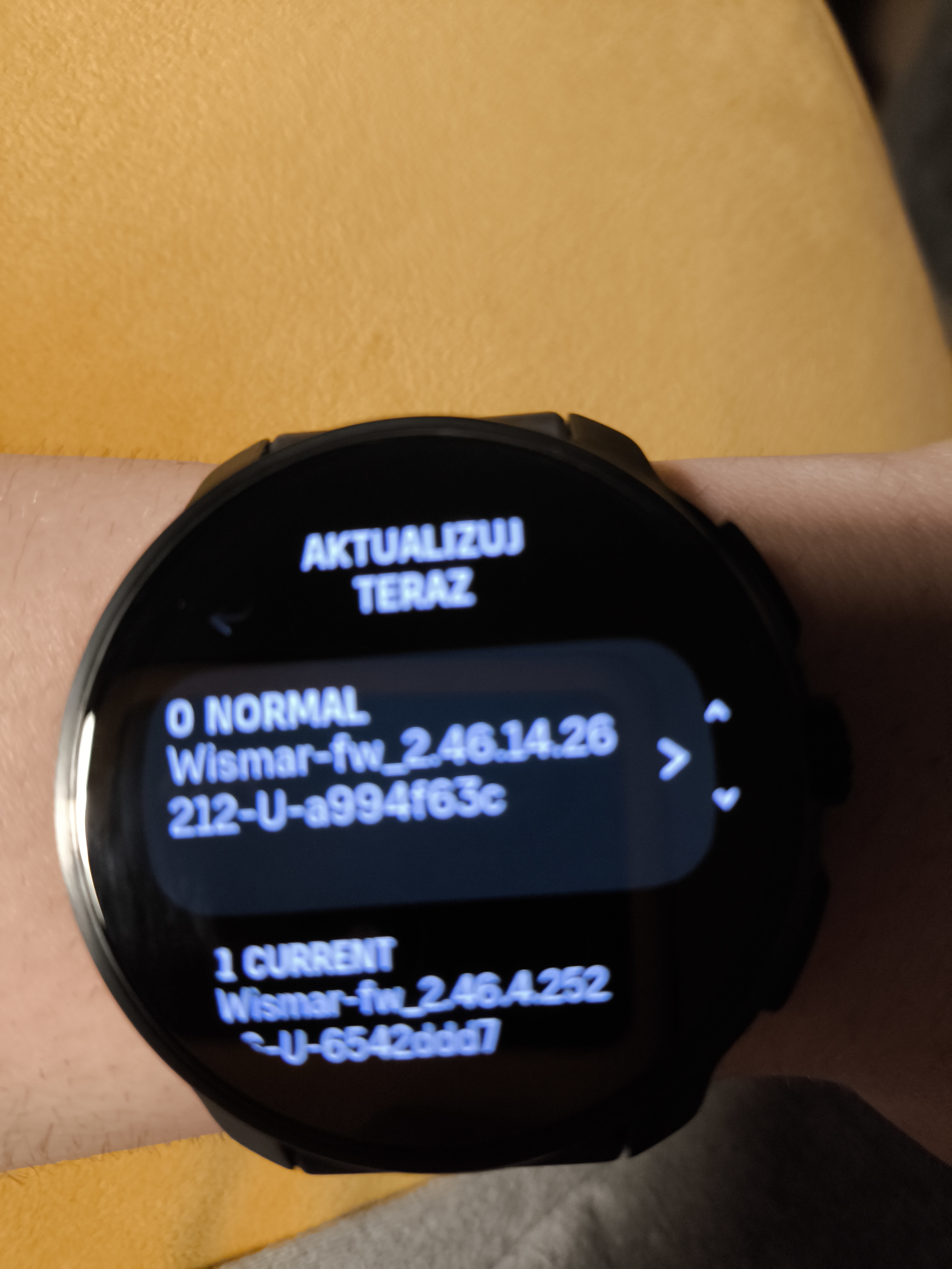

      @newegor said in Software Update 2.46.14?:
      I have this button problem after update. Moreover, I locked the watch for some time using lower button and cannot unlock in some time, cannot do anything with watch. I had to do a reset. This is very annoying. How can I return back to previous version?
      Setting, general, information, scroll down to the list and than press and hold lower button like for 5s.
      Hidden menu will show. Find ,Select OTA pkg". There You will find all versions of updates You ever had. You can choose older. I heard it’s not recommend to do rollback, but I did it many times on my three Suunto watches and nothing wrong happened.
      Oh and be careful because under ,Select OTA pkg" option is option ,Delete saved pkgs" that as it says it delete versions of update, and if I good remember if You click that by mistake it won’t ask about confirm! So watch out when You scroll :D.
      CURRENT 1 is older one, You can see version of update In its name.

              Tommylee84 @Tami999
              @Tami999 this going to sound odd but could you scroll up on that screen so I can see the entire file name? I accidentally delete all the prior firmware and I’m having this issue and would like to downgrade.

                • JosaipluJ Online
                  Josaiplu Silver Members @Tami999
                  @Tami999 thanks for this ! However I did not have the 46.4 available only 2.46.14 and 2.41.48.25 any hints that could allow to go to 2.46.4 maybe ?

                    @Josaiplu said in Software Update 2.46.14:
                    @Tommylee84 said in Software Update 2.46.14:
                    If You Guys deleted/dont have specific version, iam not sure but I think i saw somehow on forum You can choose and download any version You want, and download it to Your phone & sync and install.
                    In past long time ago i accidently deleted all versions (delete ota pkg option dont ask for confirm :D)
                    • JosaipluJ Online
                      @Tami999 thanks I check the firmware collection topic and I ask Claude to construct the url but no luck
                      If someone have the url or the 2.46.4.452 for race 2 I’ll be glad
                      Thanks for your help !
                      Old: SV, SR
                      • JosaipluJ Online
                        @Tami999 may I ask you a screen shot with the name of the 1_current ? With the full name we could have url
                        Edit found it 2.46.4 : https://firmware.geo.movescount.com/production/Wismar-fw_2.46.4.25276-U-6542ddd7.sof
                        and the current one 2.46.14 : https://firmware.geo.movescount.com/production/Wismar-fw_2.46.14.26212-U-a994f63c.sof
                        Your screenshot was enough to find the proper URL with some guessing thanks a lot 😉
