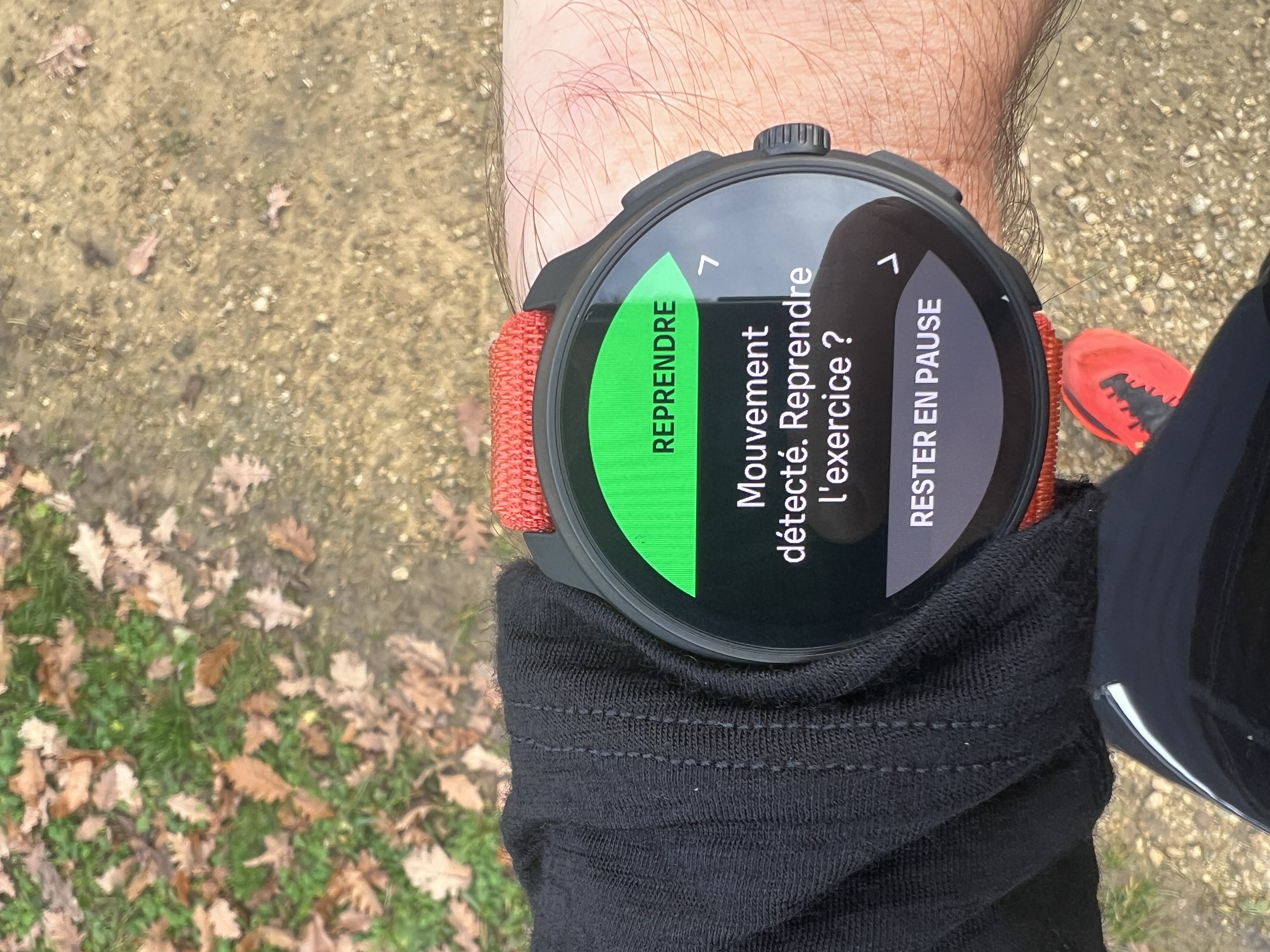

                Is that movement detected do you want to resume activity a new feature of this update ?![alt text](image url)
                Pups my wife told me that it’s an old feature sorry 😉

                  @Josaiplu said in Software Update 2.48.16 (2025 November Rain release):
                  I wish this could be turned off. Or at least if this pops and you press “no”… it would resume the pause time (it wount come back anymore…)
