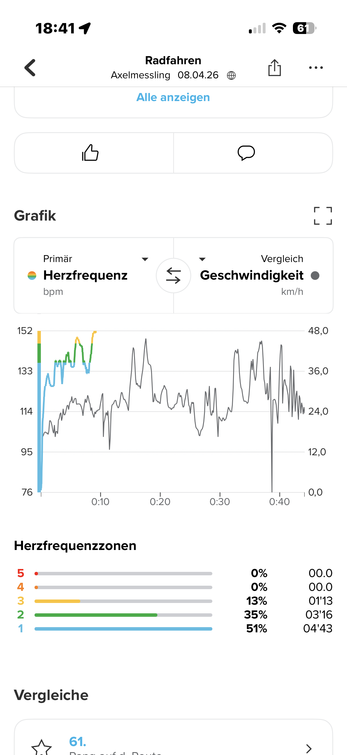

      Since update 2.50.26 and in all subsequent updates, the use of multiple HR devices is no longer possible. The connection between the watch and the HR device drops after a few minutes, the value on the watch display either freezes or no value is shown anymore. This also happens when the correct sensor is selected in the options before starting the workout.
      As soon as one or more HR sensors are connected to the watch and at the same time to an external GPS device (here Coros DURA), reliable measurement is no longer possible, the connection is lost, sometimes after pauses, sometimes after a few minutes without any apparent reason.
      Even if only the Suunto HR belt is connected to the watch and the Coros Dura and all other HR sensors have been deleted, the watch loses contact with the belt, even though it was displayed correctly at the start.
      The error is reproducible, but the trigger cannot be attributed to a specific duration or always to a stop. In most cases the disconnection occurs within a few minutes.
      Screenshots of the last activity showing the error in the MySuunto app and on the Coros Dura are attached.

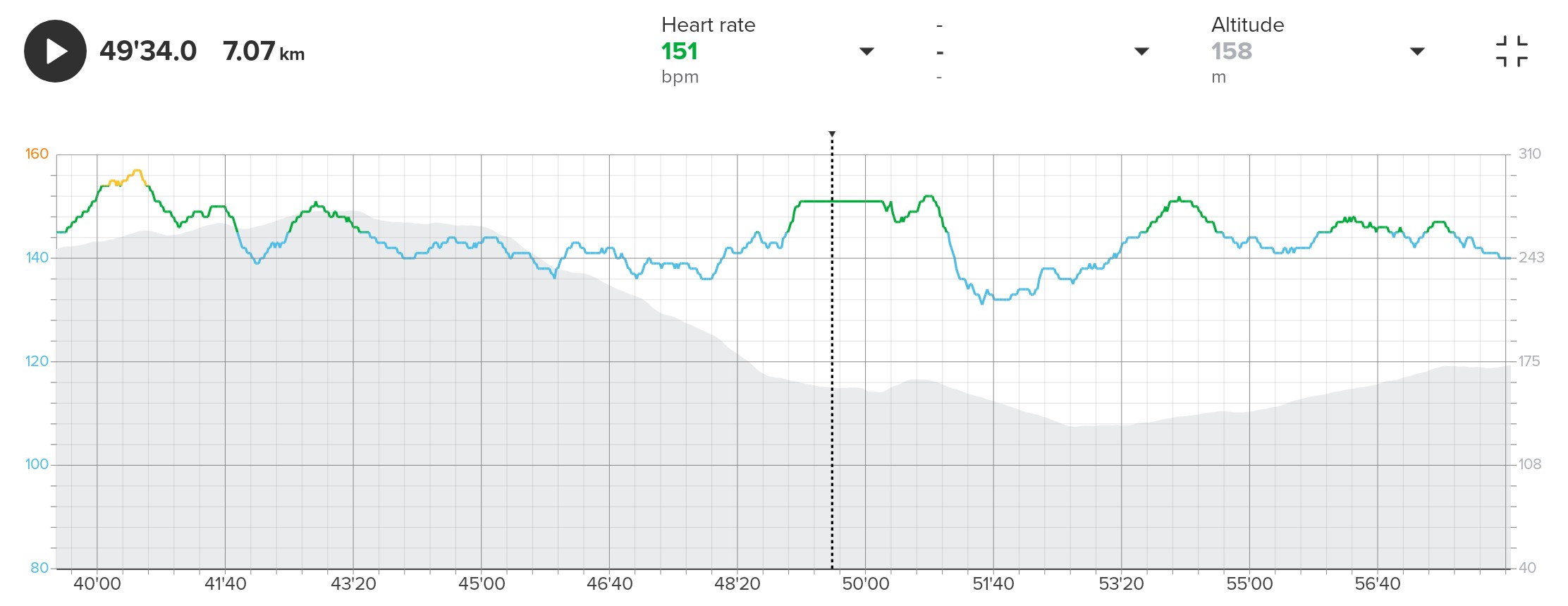

          Screenshot from yesterday:

                                  enneo Bronze Member @enneo
                                  In my screenshot above the area when the sensor is disconnected is flat lined, as other commented, I would prefer to have no data.
                                  Possibly it’s a limit of how data is represented having to link two values?
                                  I had another occurrence of this bug today and is always the same behaviour.
