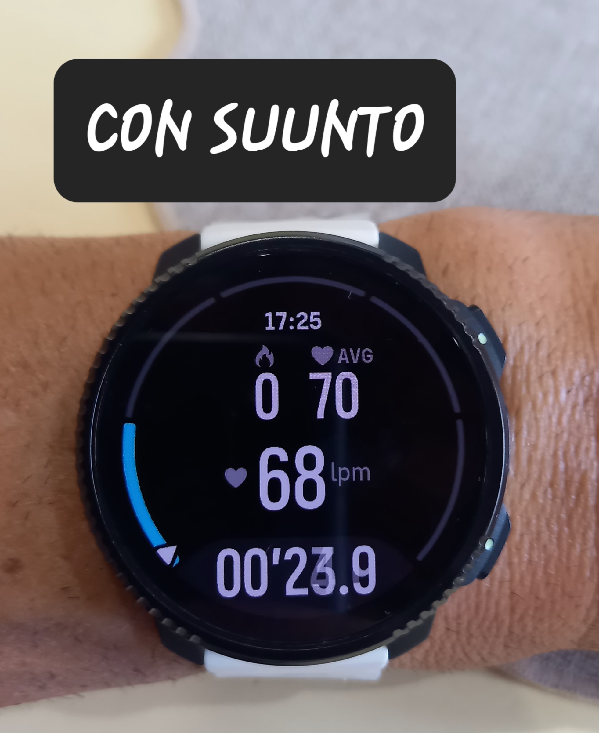

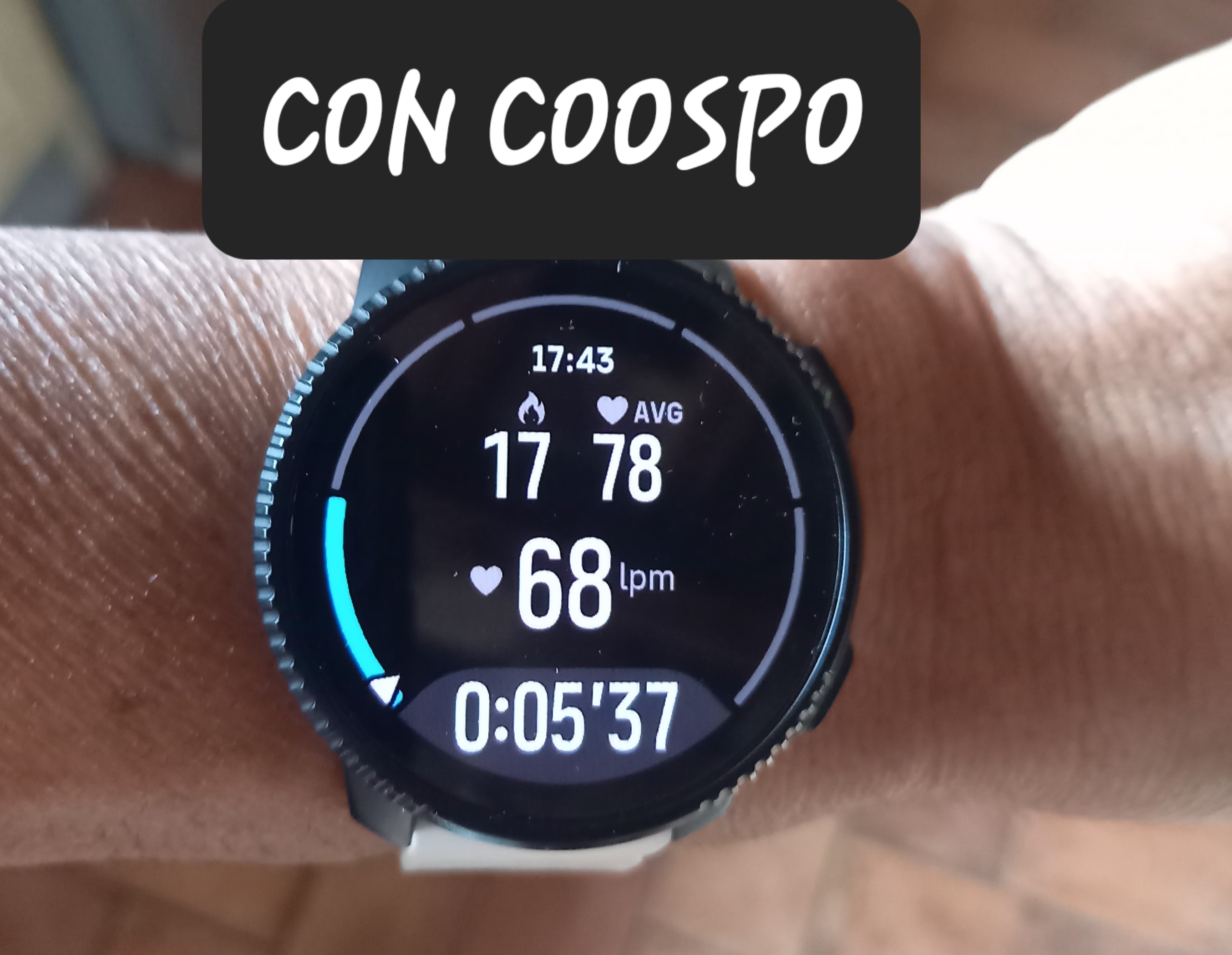

                            Hi everyone. So, I did a test with two different types of external heart rate monitors: the usual Smart Band Heart Belt and a supposedly inferior brand called “Coospo.” It was disappointing. I even recorded an activity that didn’t require GPS (dancing) for the test…
                            Using the Suunto strap, after a few moments…

                            Now with an external one, Coospo brand…
                            In my case, it’s clear: my original headband, after being serviced and replaced (theoretically) with a new one, has stopped working again after 7 months. I’ve tried hardly washing it… only by hand. I’ll send it to the repair shop tomorrow, as it still has a year of warranty left. After that, I’ll sell it in case anyone wants to continue the crusade 😓. I’m going back to the Polar H10…
