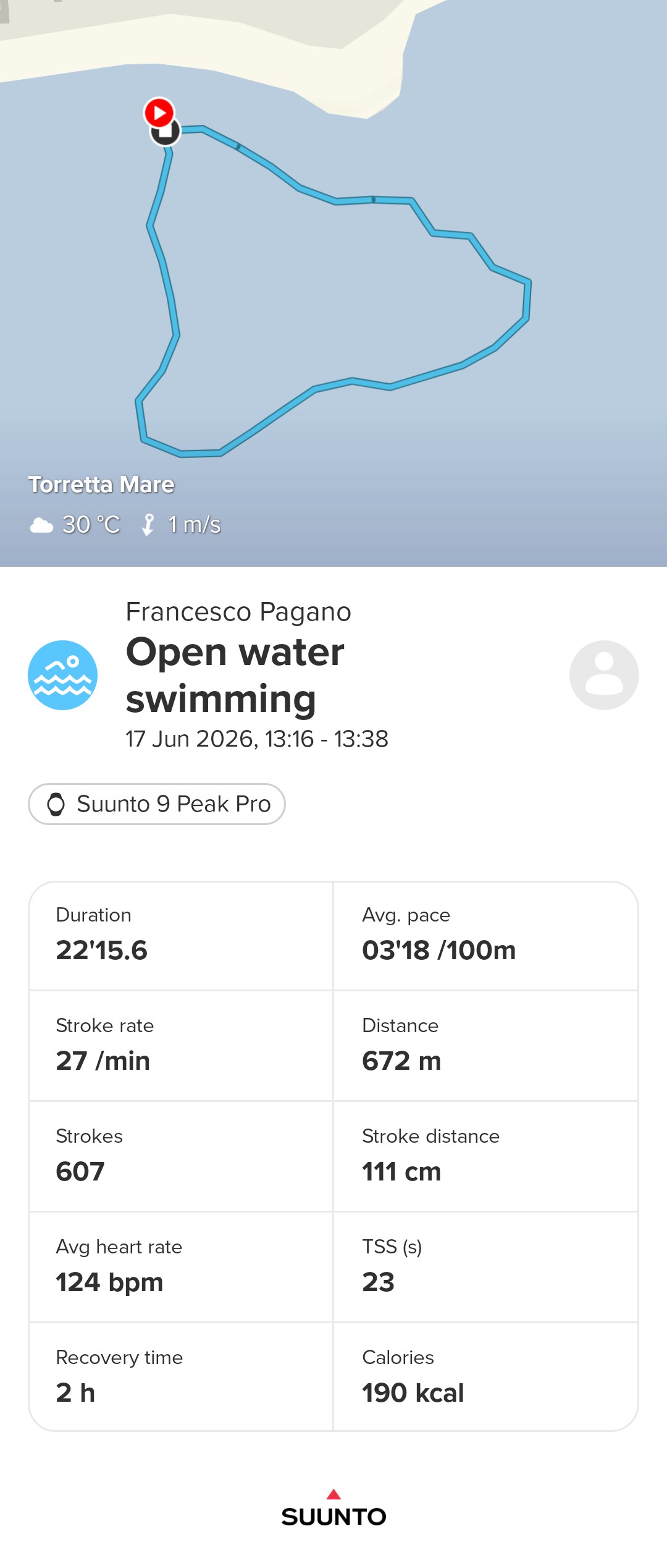

      I’m not an experienced swimmer and I have low expectations, but I like when my activity data is rich and (presumably) accurate.
      I did what for me is a long swim in the sea today, and my watch displayed HR values close to my perceived effort. Displayed distance remained 0 all the time; I made sure to wait a few seconds out of the water before ending the activity, and although I can’t tell how long my swim was, the GPS track seems very accurate. I expected more straight lines instead the route follows what I think I actually covered.

        @Francesco-Pagano this one is from last autumn. I was quite surprised cause earlier swims didn’t work that well from gps. I just carried the watch on my wrist.
