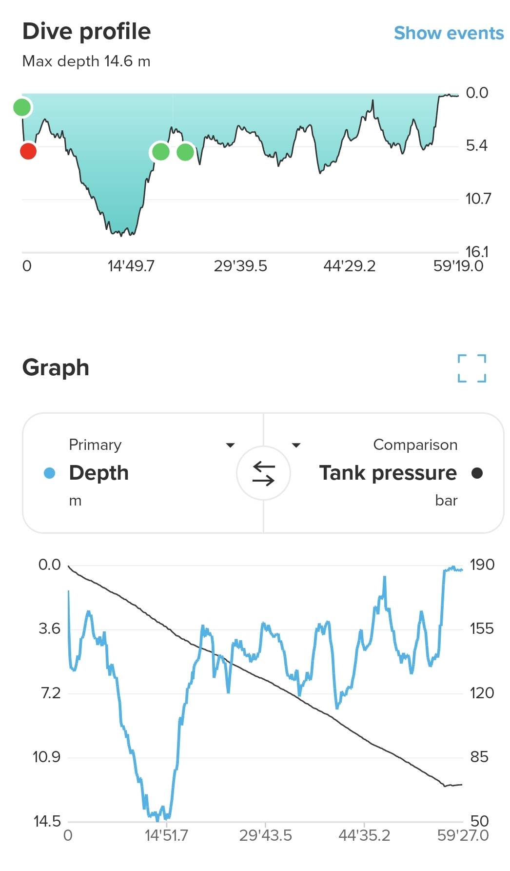

        @MartinPadiPro @voigas Again I had the mandatory gas time alarm in the beginning of the dive. See included screenshots.
        I had some initial issues getting the pressure on the display but that can be something that is non related… the tank was pressurized, i saw the pressure, but before my backroll I needed to check as pressure was “–”. But before he tank showed “201”. I’ve send the logs and an update of this case to Suunto support hoping they can find out what this causes. It is always during ascent and ofcourse correctly activated after a dive indicating the 5 Min alarm as is is supposed to do.

                            A question to make things clear. You only get this alarm on the Nautic, not the other air integrated computers? The problem is with the Tank POD not the older transmitter?
                            • H Offline
                              hhouter Bronze Member @ccrhenrik
                              @ccrhenrik Correct. Two computers connected to same Tank POD. The EON Core does not give me the error, the Nautic does. See screenshots of same dive in post above. The tank pressure graph in both computers are equal and do not indicate any loss of pressure, see screenprints below.
                              So my conclusion is that it is not a tank pod error or inteference of a flashlight as the EON didn’t give me the error and functioned correctly. There should be a bug in the Nautic as it indicates the 5 Minutes Mandatory gas time alarm with full tank in certain situations in the beginning of the dive.
                              See both logs;

                                      A friend diving with the Nautic received a mandatory gas time alarm in the beginning of a dive today 29/07/2026.
                                      Suunto please do something about this. This is not an isolated issue or a faulty Nautic that needs to be sent-in for service, it is a issue in the current firmware…!!
                                      See below the response from support, this cannot be true. Triggering an alarm is a serious situation and cannot be left up to the divers interpretation to wait for the stabilization of the calculation.
                                      Initial SAC Calculation Phase
                                      During the first 5–10 minutes of a dive, the algorithm calculates your breathing rate. A higher breathing rate or sudden depth changes during descent may temporarily reduce the estimated gas time, which can trigger an alarm before the calculation stabilizes.
                                      Screenshot_20260729_105855_Suunto.jpg Screenshot_20260729_110121_Suunto.jpg Screenshot_20260729_110344_Suunto.jpg Screenshot_20260729_110626_Suunto.jpg

                                            I exported the raw JSON from the app and used AI (Claude) to help me dig through the samples. Here’s what it explained:
                                            Suunto Nautic on 2.49.32, Tank POD, 12 L, alarm at 02’07.6 at 5 m.
                                            The pressure data is clean — 10 s samples, ~0.01 bar resolution, completely smooth through the alarm (202.03 → 201.42 → 200.86 → 200.77 → 200.17 bar). No dropout, no reconnect step. Consistent with what @hhouter found running an EON Core on the same POD.
                                            But the consumption line in the app isn’t derived from that pressure. The Nautic logs a separate Ventilation field per cylinder, in m³/s, and calculates remaining GasTime from it. Here’s what it does around the alarm:
                                            110.2 s   Ventilation 0.000421 (25.3 l/min)   GasTime 2956 s
                                            119.9 s   null                                null
                                            127.6 s   null                                null      <- alarm
                                            129.9 s   0.001667 (100.0 l/min)              0 s
                                            137.7 s   0.001562 (93.7 l/min)               755 s
                                            209.9 s   0.000059 (3.5 l/min)                6000 s (capped)
                                            Two null samples, then it re-initialises and its first output is 100 l/min. That puts remaining gas time at literally zero seconds, which fires the alarm. Eighty seconds later it’s back at the ceiling.
                                            The field is off outside the glitch too: it reports 3.2 l/min at the point where my pressure was dropping fastest of the whole dive, and integrated over the dive it’s 40% below the gas I actually used.
                                            So “the algorithm is still calculating your breathing rate” doesn’t hold up. A stabilising average converges — it doesn’t go null and restart at a physiologically impossible value. And an estimator in an invalid state shouldn’t be able to trigger a mandatory alarm at all.
                                            If you want to check your own log, export the JSON and look for Ventilation: null mid-dive immediately followed by a huge value and GasTime: 0. Happy to share the script I used.
