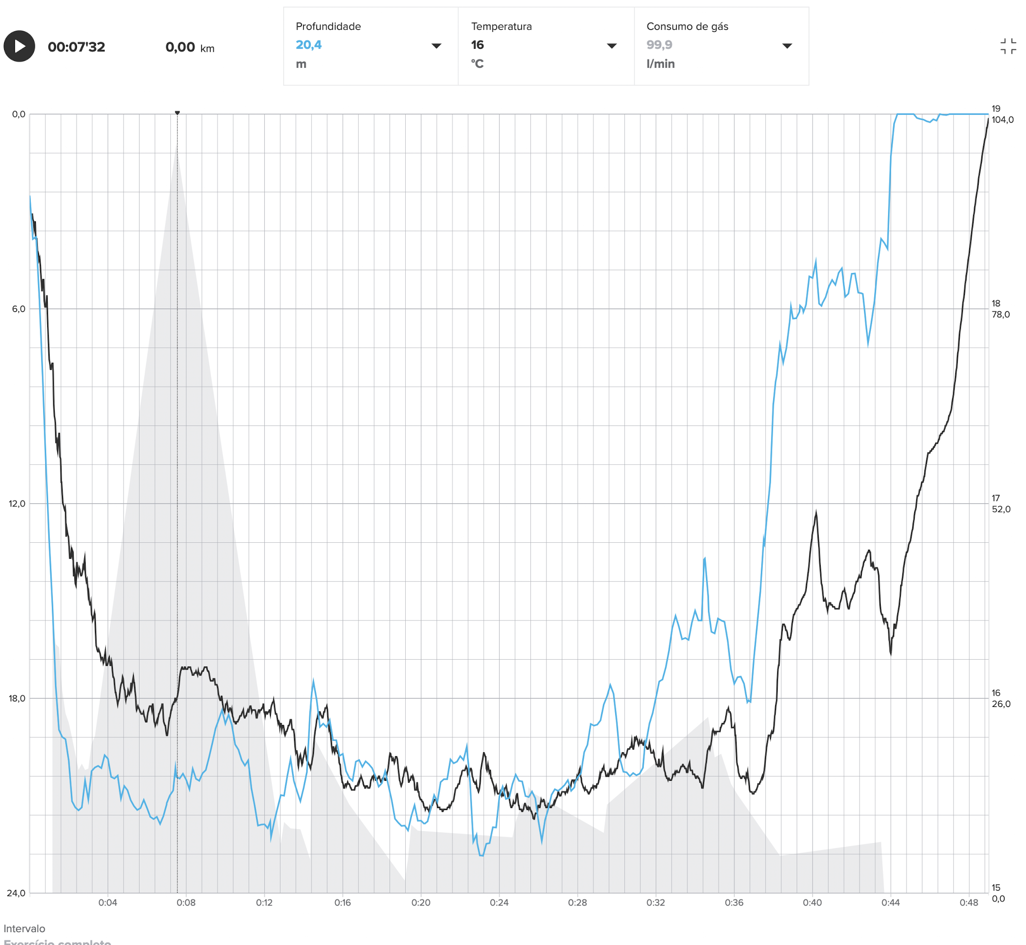

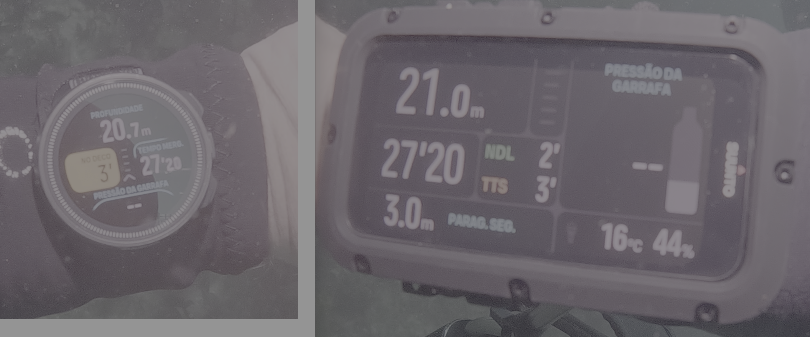

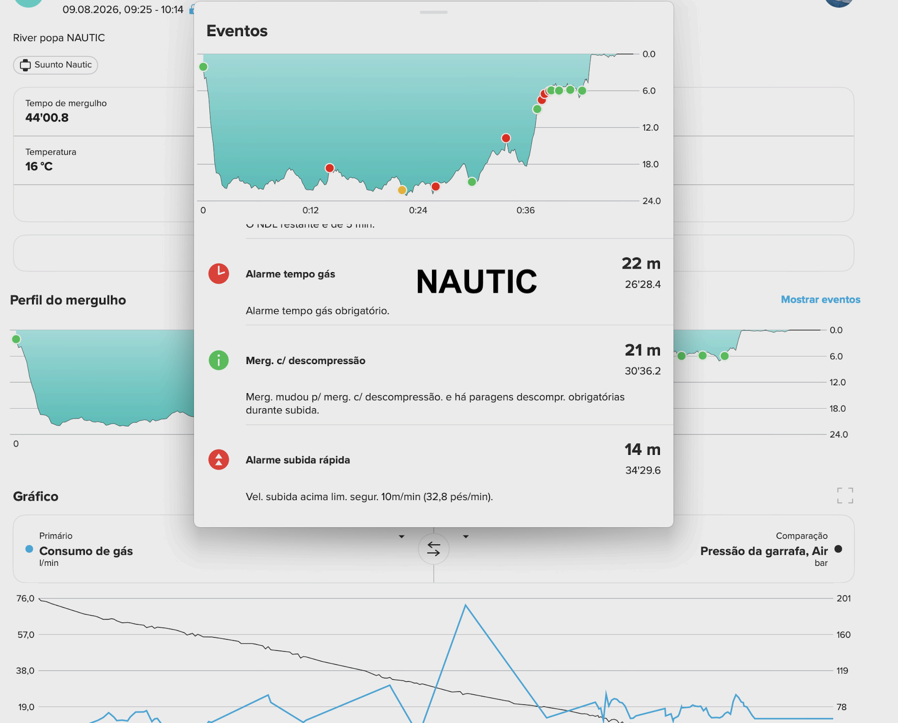

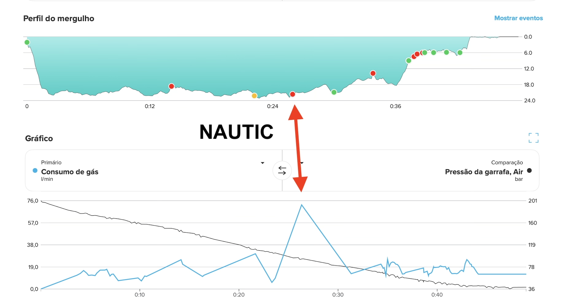

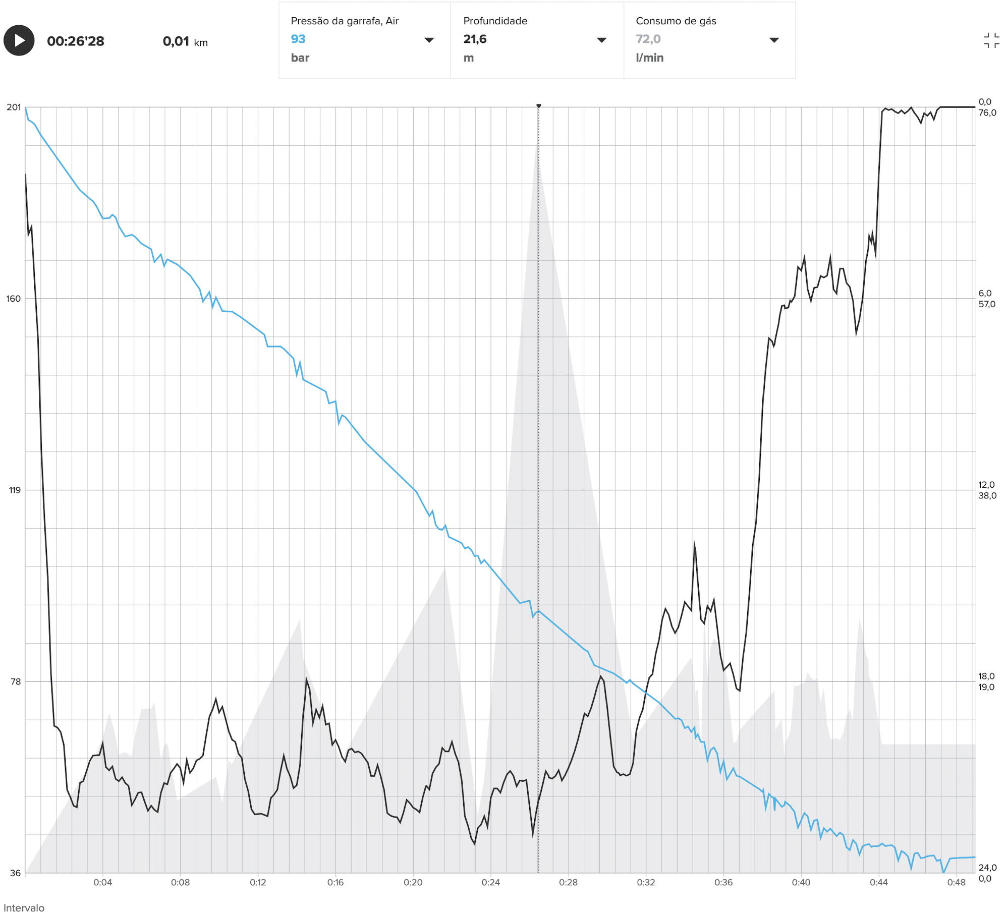

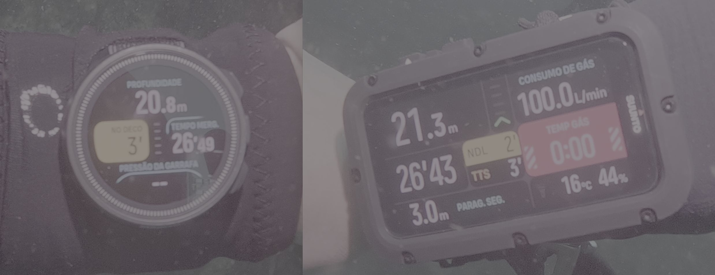

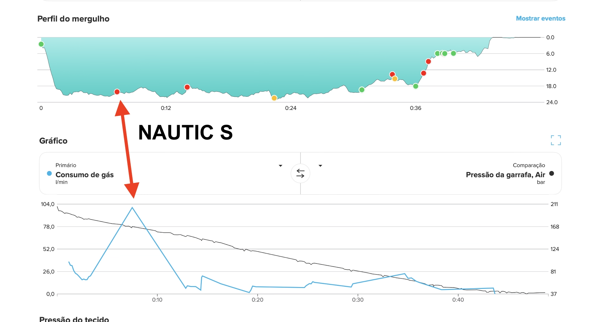

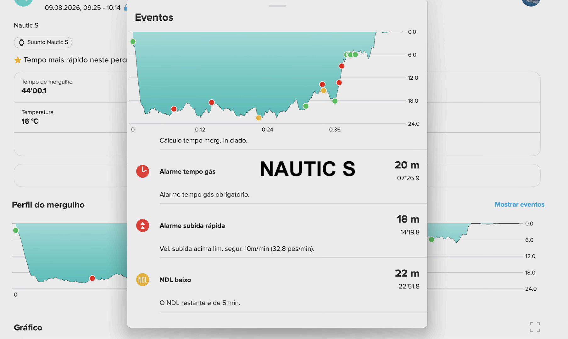

                                  This morning i had 2 x Mandatory gas alarm with both dive computers connect to the same transmitter and completely diferent times
                                  1x Nautic (right arm) (battery 45% )
                                  1x Nautica S (left arm) (battery 18% )
                                  1x transmitter on right side (backmount)
                                  and from my findings i believe is related with bad communication between transmitter and dive computer
                                  Ps: its the first time im using the configuration single gas tank, my normal configuration is multiple gas (even if both tanks are air ) Could be related or not with the alert/bad communication.
                                  pps: this was the dive i had most dropouts (no idea why)
                                  NAUTIC S
                                  Mandatory gas alarm 7m26s
                                  Air consumption 100L/Minute 7m31s
                                  Dropouts time on Nautic S 8m41s + 9m.28s + 26m49s + 27m21s + 29.26s
                                  Theres was some Dropouts that i didn’t record, not sure if was at same time has the Mandatoy gas alarm
                                  NAUTIC
                                  Mandatoy gas alarm 26m28s
                                  Air consumption 100L/Minute 26m28s
                                  Dropouts time on Nautic 9m19s + 26m43s + 27m20s + 29m24s.

                                    More prints
                                    H 1 Reply Last reply Reply Quote 2

                                      more prints

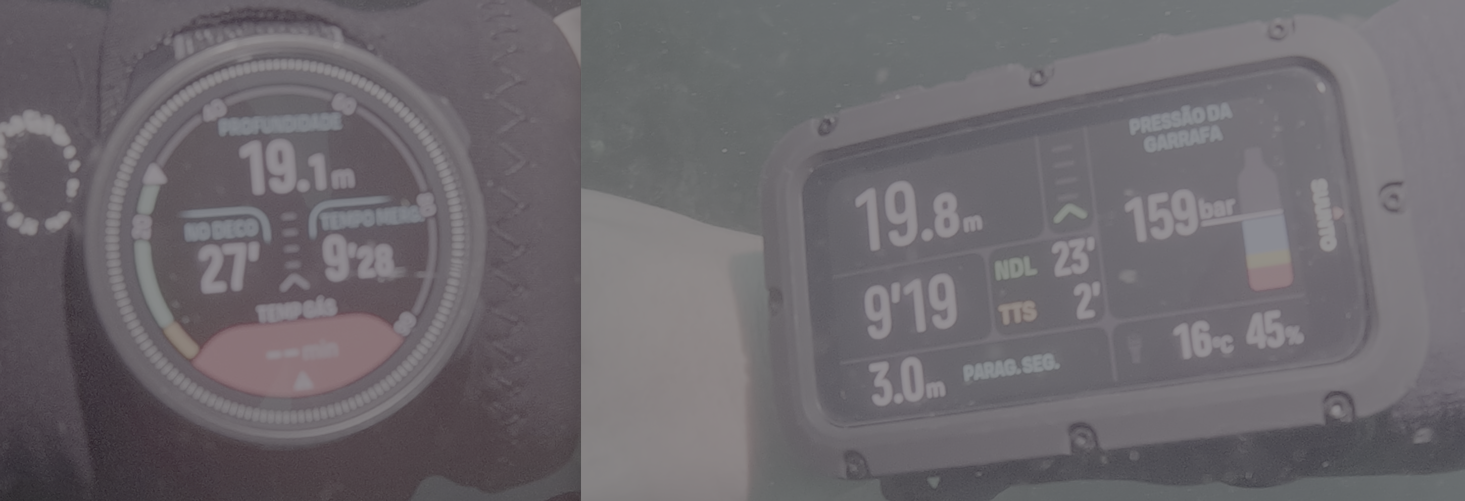

                                        Here the Nautic S had dropout and i move the arm closer to the transmitter to re-connect

                                          here Nautic & Nautical S had dropout at same time, and i was able to check the air consumption in Nautic
                                          • N Offline
                                            Nandodiver Bronze Member
                                            Another dropout Nautic & Nautical S
