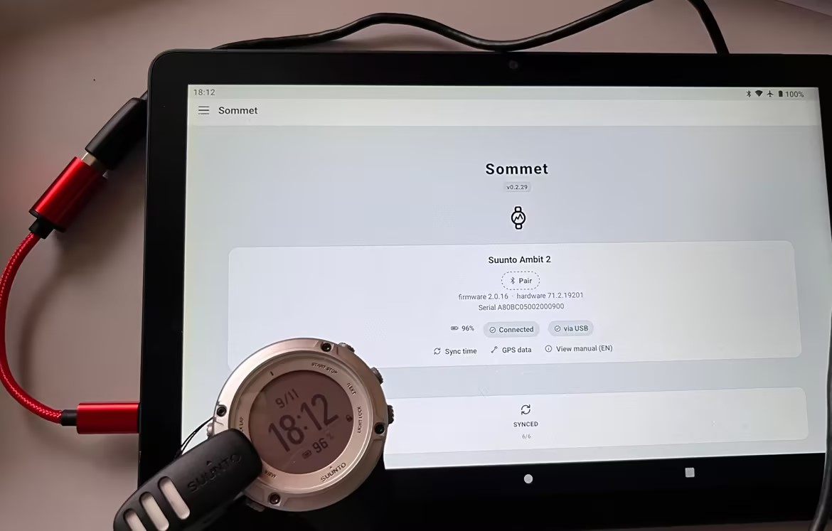

                                    • Z Offline
                                      zt_zzzzz
                                      Thanks for the job!
                                      USB-OTGsuccessfully connected to the Android Pad.
                                      What is the cause of the problem that indoor sports (such as indoor power cycling) cannot be exported as FIT because there is no GPS data? It would be perfect if we could export FIT.
                                      André FariaA 1 Reply Last reply Reply Quote 0
                                      • André FariaA Offline
                                        André Faria @zt_zzzzz
                                        @zt_zzzzz thanks for testing. I even didn’t think about it. I am checking it with claude to implement it and come back to you.
                                        Correct if I am wrong, indoor activities mean:
                                        HR
                                        Power
                                        Cadence
                                        Temperature
                                        Distance (if home trainer?)
                                        Any other you can think of?
                                        Garmin Edge 1040 Solar
                                        Z 1 Reply Last reply Reply Quote 0
                                        • Z Offline
                                          zt_zzzzz @André Faria
                                          HR
                                          Power
                                          Cadence
                                          Temperature
                                          I usually just record the data:
                                          HR
                                          Power
                                          Cadence
                                          Then upload to Intervals.icu
                                          Because only Ambit2/Ambit supports ANT+,Otherwise, after the Bluetooth is connected to the trainer, it will not be able to connect to other Bluetooth watches.This is also the reason why I still use Ambit2.
