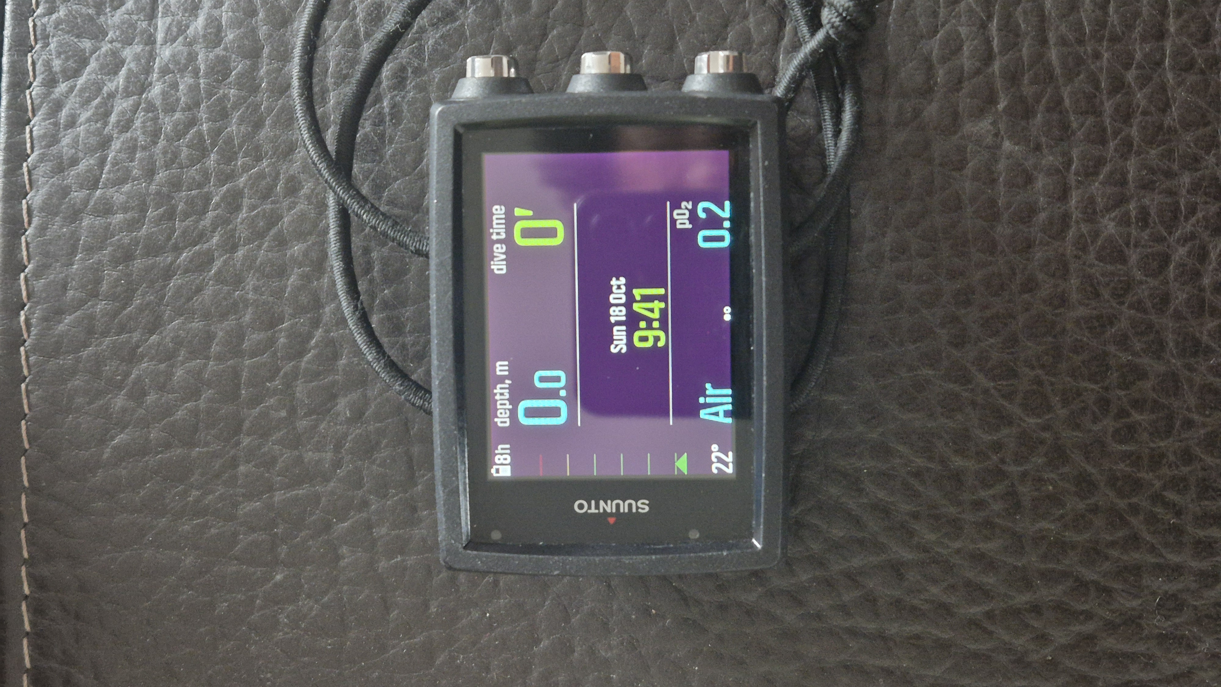

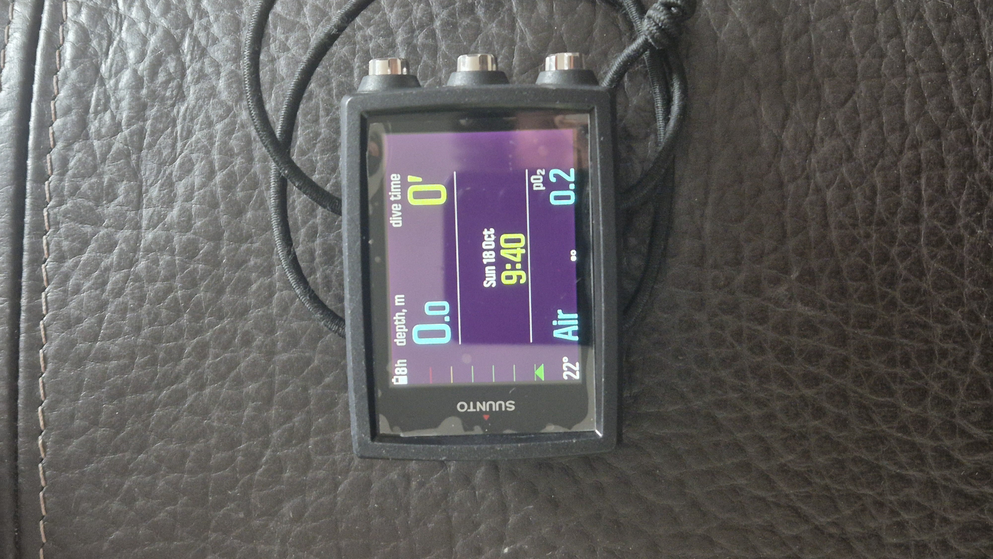

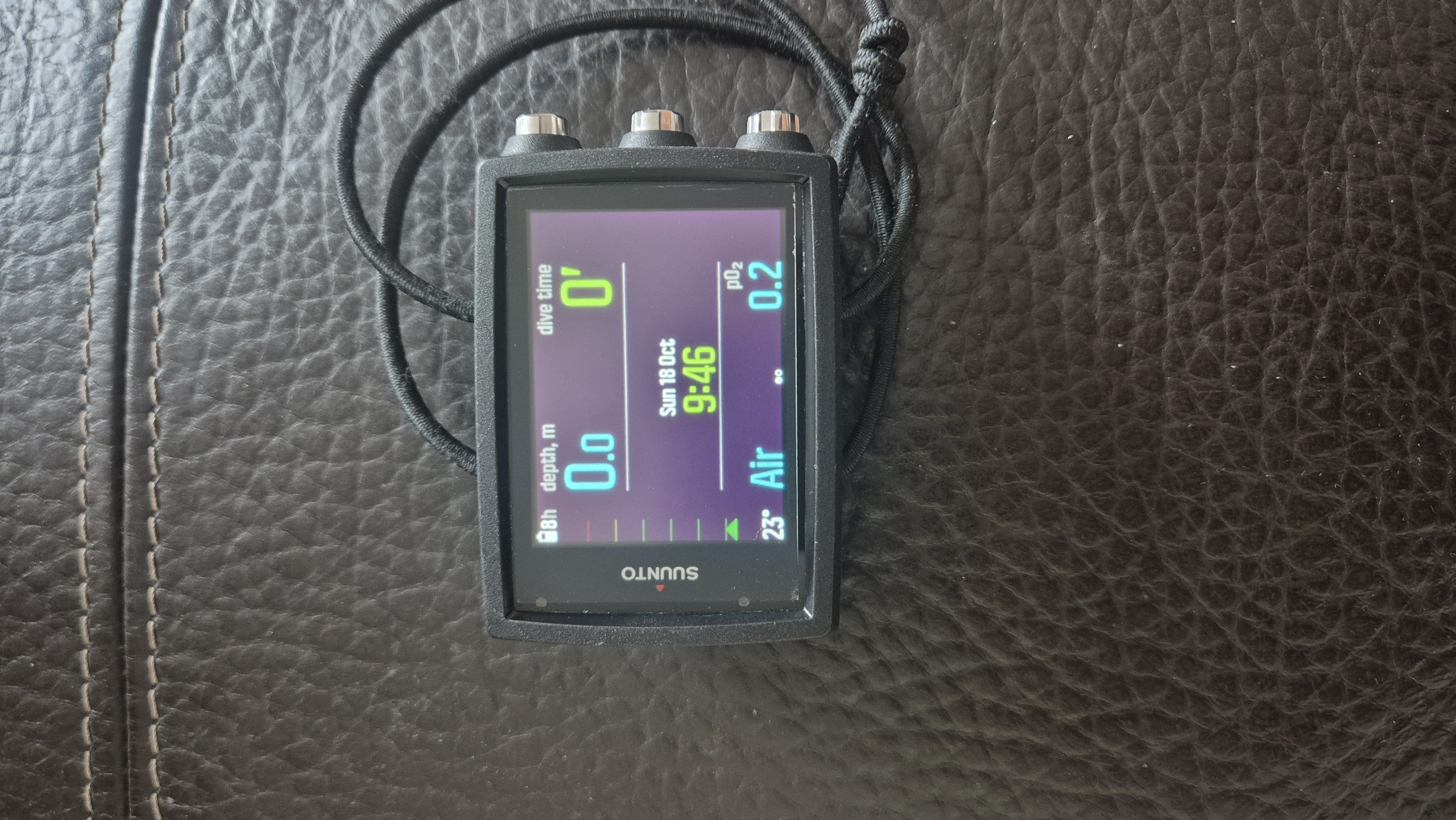

                        Now I applied the matte protector. Not diving anymore, but the “Dry Run” looks promising
                        With original protector
                        Without
                        With matte protection
                        In the first two there is a strong reflection of my phone. On the third: Nothing! Really looking forward to test it under water but in the moment I am optimistic!
                        Its not as clear as without protection, a little bit blurry. But readable so far
