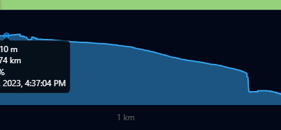

                    My last flight recorded with the S+ App was rather short. I imported it to gpx.studio but even while there is 20m drop at Landing I could see me flying over the ground. Maybe on a different visualizer.
                    Normally this works fine on other sites with tracks from any variometer which is recording both gps and baro height.
                    There is a setting in the Suunto App on Phone where you can choose between baro and gps height. Maybe check this before. I always have this on baro height cause it is more reliable than gps but I guess this setting is just for the app. I think the watches use baro height and one can manually set it to gps height if it is off to much.
                    Hier the height diagramm from the gpx track of my flight with the app:

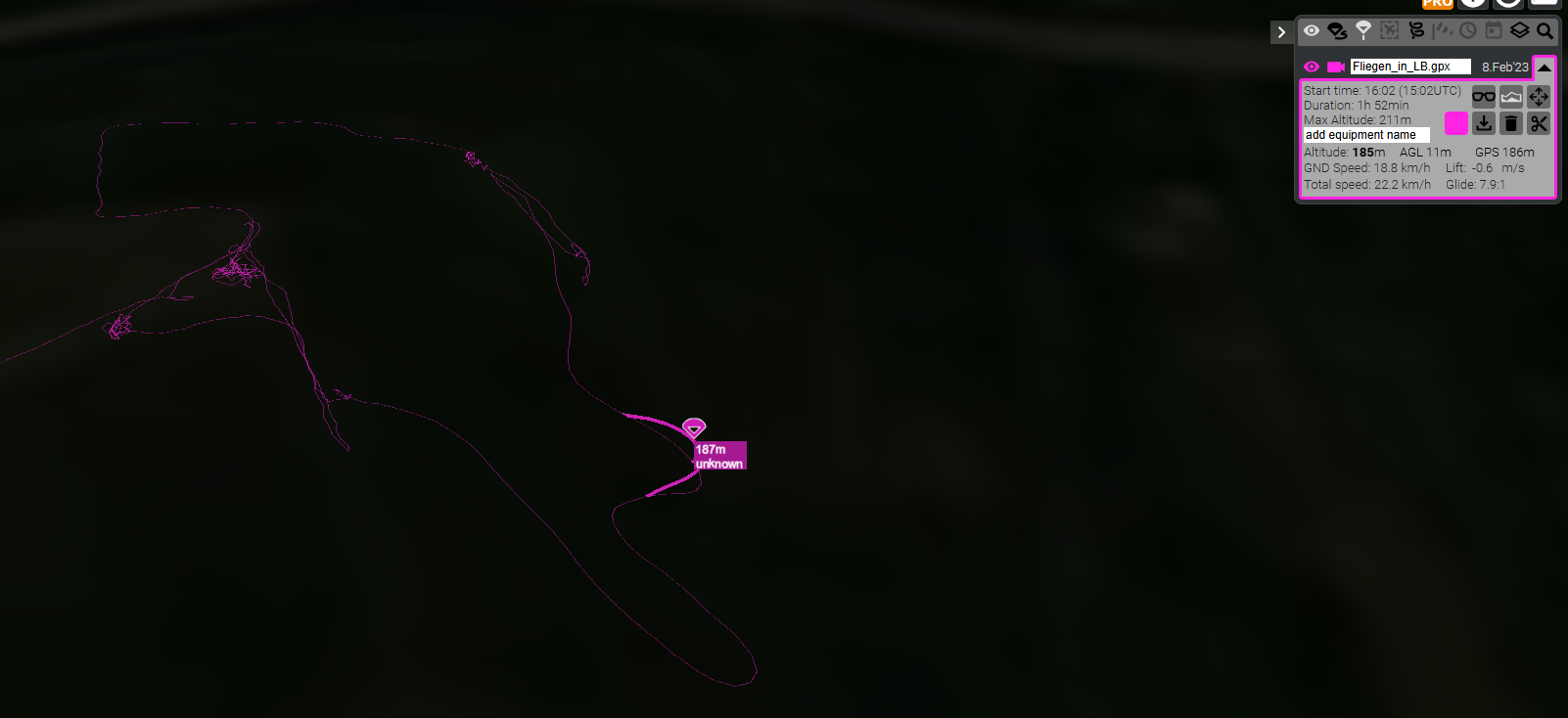

                    Here I uploaded the file to replay.flights. There is one short lift. But I don’t think the data in the file and the elevation data is reliable. Just found out that komoot has been using Nasa elevation data that simply was wrong in many areas and they updated it just recently. I had some steep climbs on a bike tour in turkey e.g. which was almost flat while planing.
                    On many tours, climb guidance from imported tours from komoot to the watch where just wrong.
                    Maybe try to upload your tracks to replay.flights to check if they work there and compare the files to a real variometer file.
                      Egika Platinum Member @Ecki D.
                      @Ecki-D. the setting baro or GPS in the app is only used when recording an activity right with the app instead of a watch.
                      The topic of this thread is simply a rendering one of the Suunto app. There currently is no setting to have the data plotted at an elevation above ground. And this is known to Suunto.
                      The watches just use FusedAlti as desfibed above. No way to change this setting.
