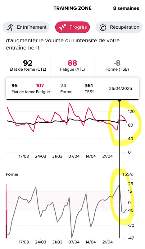

                @Daniel-Schuster I Daniel ! Can you tel us more ? Are you using a hr belt and have you set properly you’re hr zones ? Otherwise can you check how your tss is calculated for your bike activities ? If « met » calculation for instance, it can overestimate the tss of your activities which are long ones, and then lead to « overtraining » even if you’re not
                I don’t really pay attention to recovery time but more to my ffitness level : is not because you have long recovery time announced by your watch that you need it.
                I would look to Ctl/tss…are you using it ?
                I do a lot of trail running and cycling too. Cycling is most of the time at lower intensity than running, so atl will reduce faster after cycling
                (The more you ctl I high the more you need tss (activity) to maintain it).
                For instance last Saturday I deed a long trail running race (yellow below) : recovery time announced for this activity was 120h but my fitness level is « high » so I was only in « productive phase » : I went cycling the day after (gently) as part of my training.
                So I would not care to recuperation time announced, more to fitness level section of the app, it’s far more accurate and should work fine for you.
